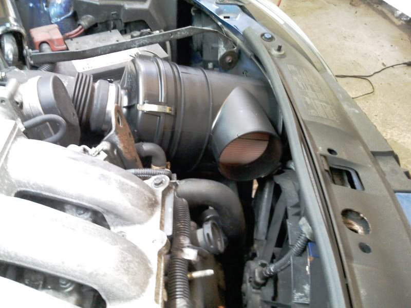

bracket is extra, but i dont have one as it doesnt fit 100% to the bracket hole anyway and is pretty solid
  BLACK GOLD 182
im with quade on this one, definaltly extra noise but i also gained power from it over the pipercross viper. assuming the matched inlets gave me 10bhp, the v6 airbox and samco 90' bend gave me 8bhp

holds the airbox to the car/battery part. in the pics i posted of my engine, you can see where the strap should go around but i dont have one fitted. with the 90degree bend, it doesnt fit anyway

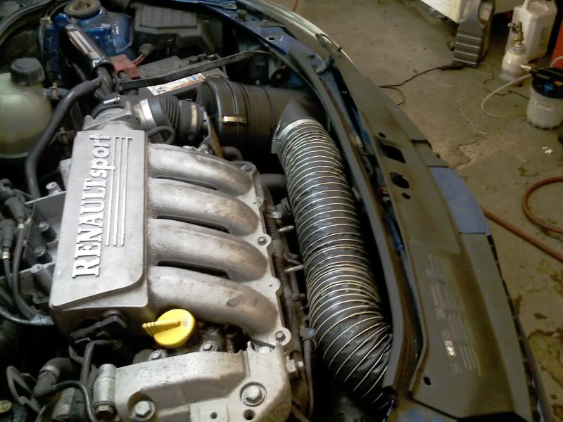

I've got no strap or bracket holding mine in place, it's just bolted to the end of the elbow, and then has the cable tied CAF attached to it.
The size of it meant it was a snug enough fit to do without any support at all.

You had to remove the fuel rail guard mate? Have you used the standard ph2 elbow? or is that the elbow off the v6?
  PH1 172 Sport
You dont have to run the CAF as Mark has. It can be run the other way down into the passenger wheel arch or lower grill. I'm not sure about the elbow as ive got a PH1 and the stock elbow is shorter, so fits it perfectly.
  Golf GTD Mk7
Looks like a different elbow to my 182 one. still undecided where i'm going to run my CAF. Need to take off the bumper and assess where to run one. Thinking upper grill, but not sure if its possible.
  ClioSport 172 Cup
Yeh upper grill is too tight, the front of this car seems to be all radiator and a silly shaped plastic grill!
I have done a battery relocation on mine so i run my filters straight off the TB, i will probably pipe it down to my wheel arch as per my BMC CDA.
