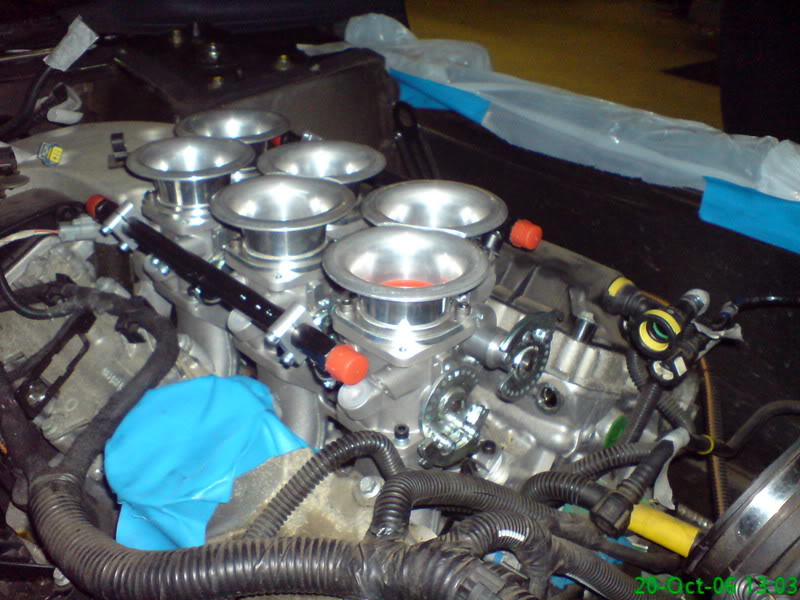

we're putting throttle bodies on my V6 at the moment
a lot of money needed
the throttle bodies in the picture are made for us by Jenvey Dynamics, but we own the rights to the manifolds
