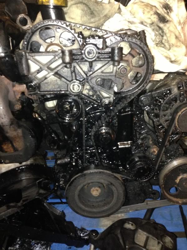

below is a pic of a DCi lump, and it aint looking pretty, i dont know if oil is coming from the cambelt area or from somewhere else and getting 'flung' about,
what seals etc are known to leak cambelt side so i can investigate as its a pretty good lump,
the turbo seals are gone and leakinh but i cant see how it would get in there and up over the alternator
cheers
Adam
Looks like the crank seal and its getting thrown out from there from the picture.
Have fun degreasing that.
