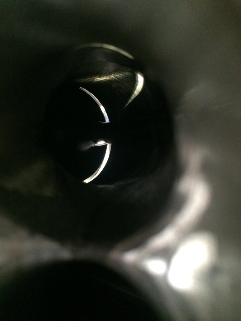

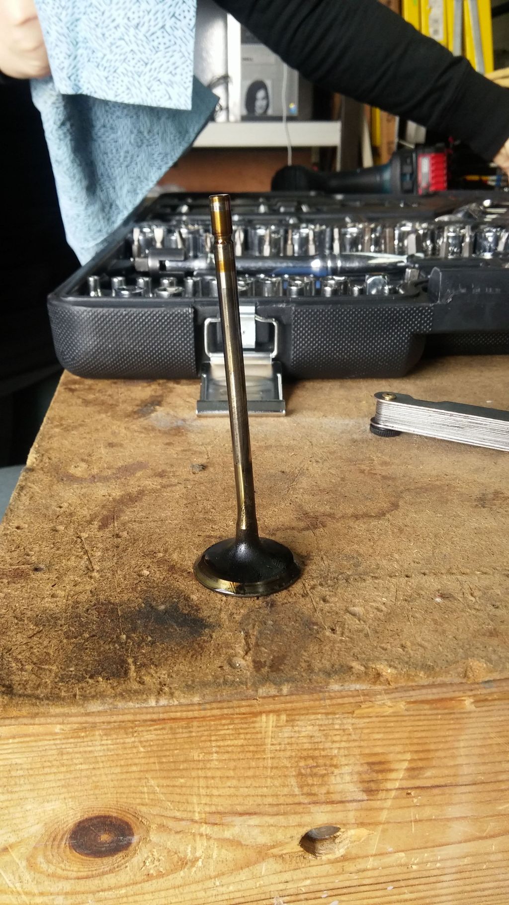

Some photos .. Not the worst bent valve ive seen by any means, but never had any experience with these engines being an ex pug man.

Usually when valves bend they take the guides too

When I'm back friday I will have more time to inspect the head. The two worst valves still fell out of the guides, so I think have got away with it so far until I check the guides for being oval or cracked. They have only bent right at the bottom of the stems, pistons contacted inlet valves as they were closing of course.
