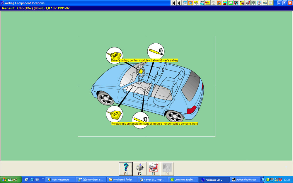

Hi people,
Just need to know if there is only 1 ecu in valvers and does this control the airbag and seatbelt pre-tensioners? Cheers, Matt;)
the seatbelt pretensioners have their own little control box under the centre consol. This has a sensor in it that judges if there is a major deceleration (front impact) im guessing it might be connected to the ecu in some way, the airbag will use a simular system
here's the info i have on the Airbag and pretensioner system.
ajketley said:
Was preety close then...lol ;)
Lol, yes mate, cheers. Thanks to GuyS for pic:D My airbag and pre-tensioners have already been set off, so I am looking to just do the pre-tensioners myself, but don't know whether i'll have to replace the control modules? Renault quoted me 1k to fit new airbag pre-tens and control modules:eek:, don't think so some how!
Youll have to replace the control module on steering wheel and new airbag but only new tensioners. 1k is way too much though. Put a post on the wanted section for what you need-you may get lucky, then all you need is a haynes manual! ;)
