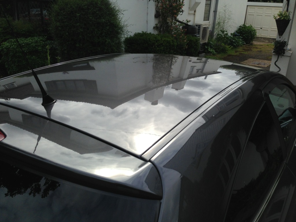

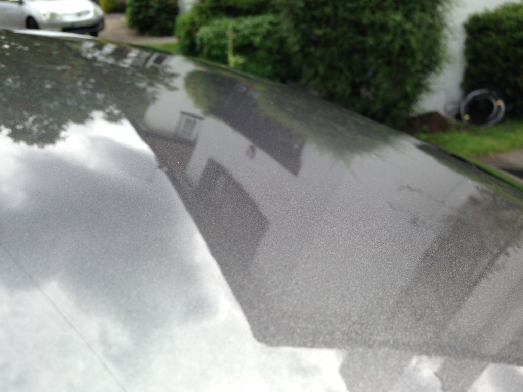

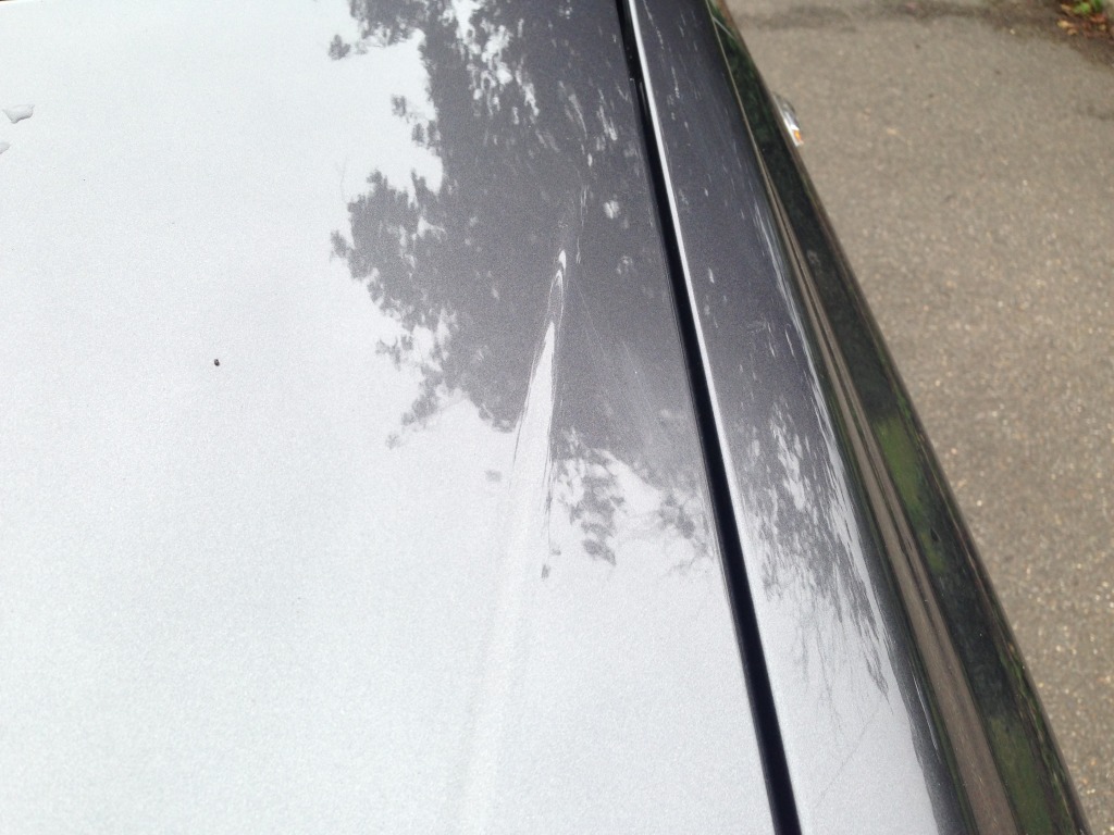

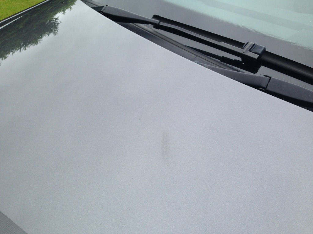

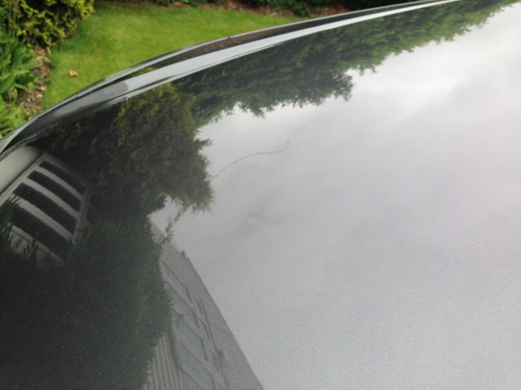

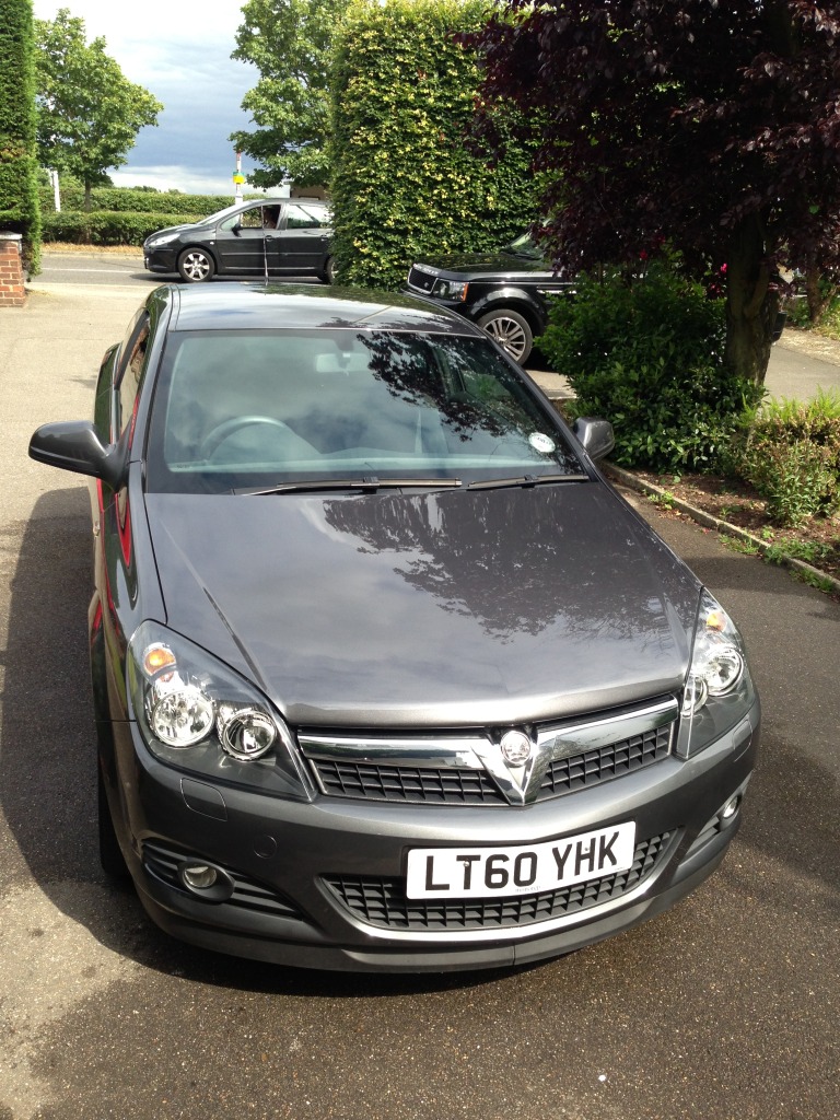

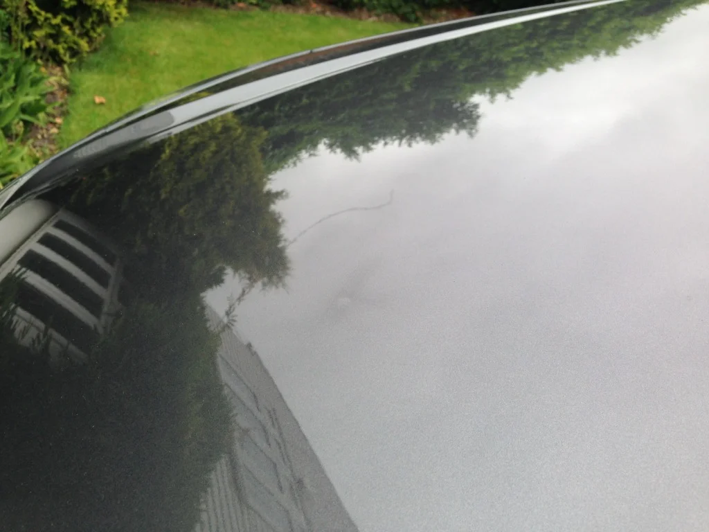

Ok so a few weeks ago my Girlfriends mum decided to remove the stubborn baked on bird poo that was on the bonnet and roof of her 2 year old Astra with a scouring pad.

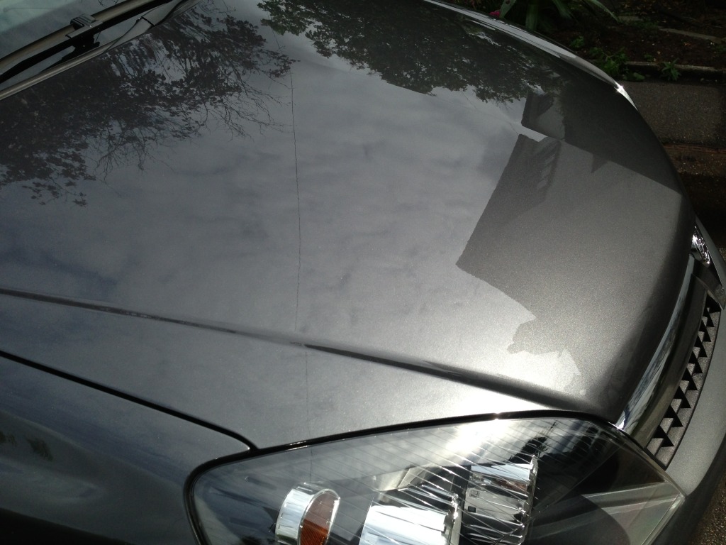

The scratches looked like this, was hard to see in the light and my iPhone camera struggled to pick them up, but you can kind of see the damage.

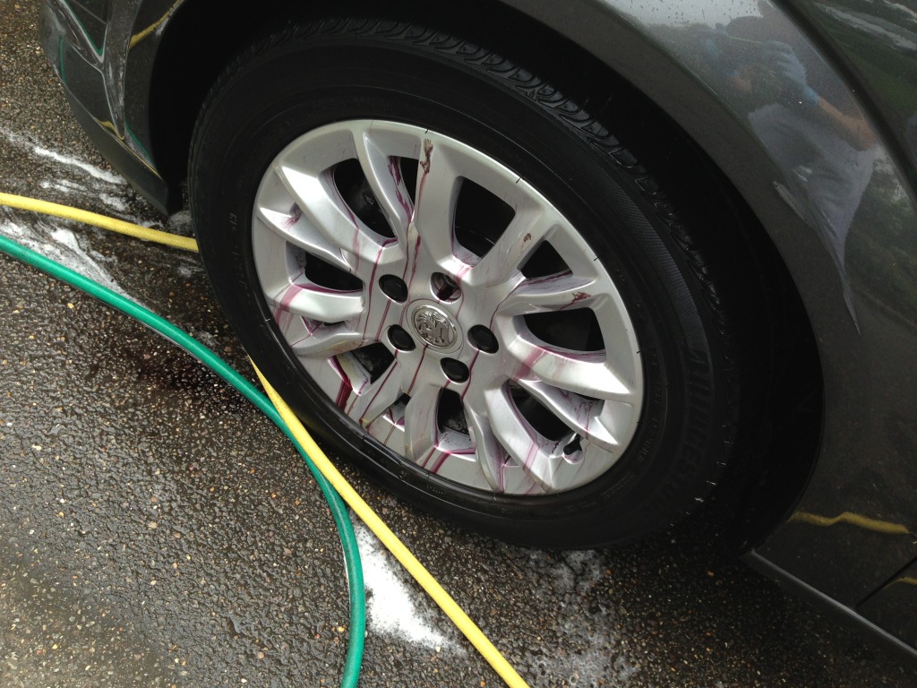

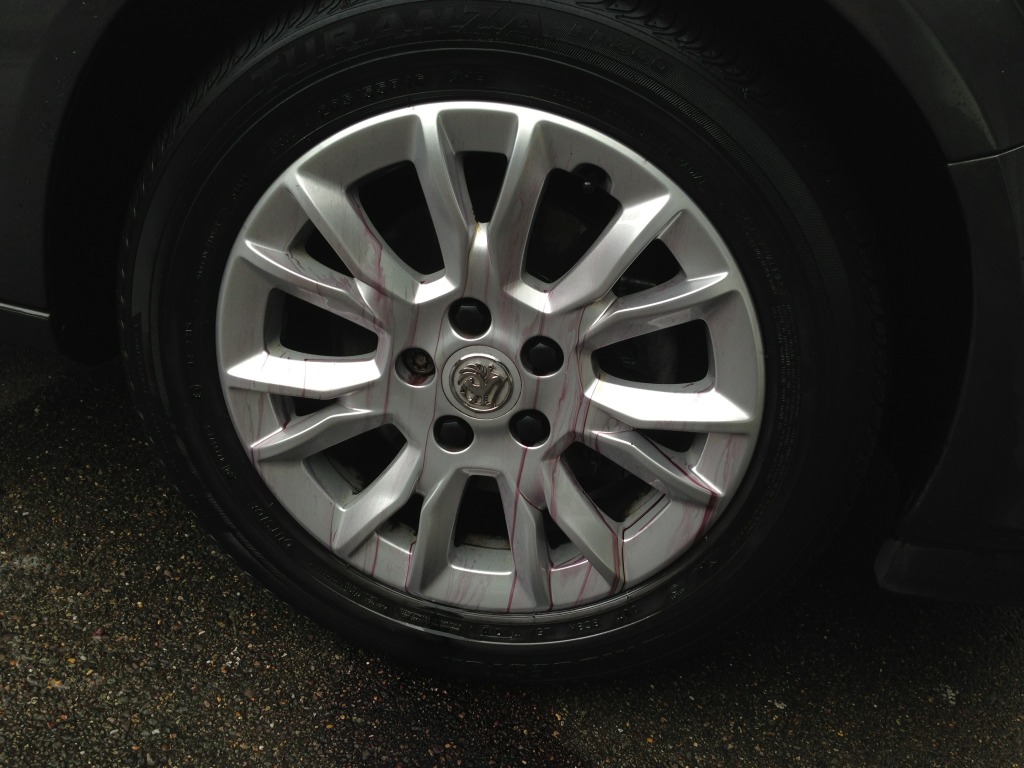

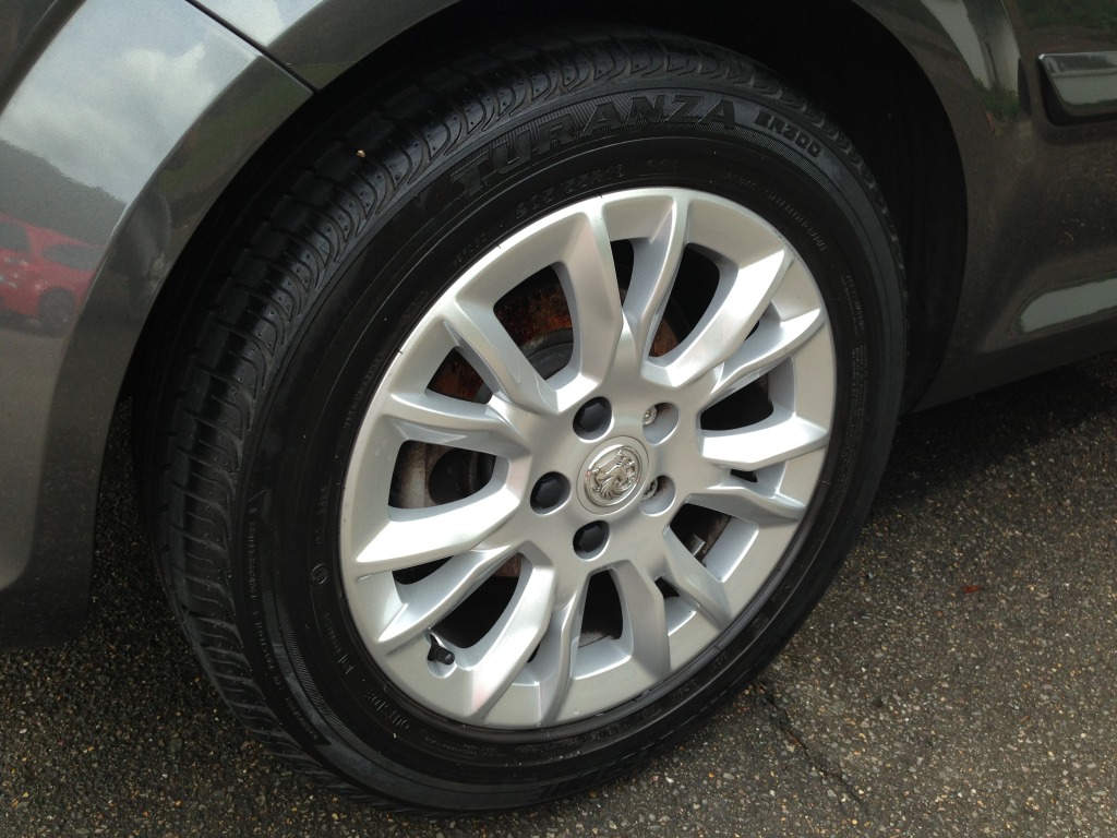

Started with the wheels first, cleaned with Auto Finesse Imperial and then again with iron-x.
They ended up like this.

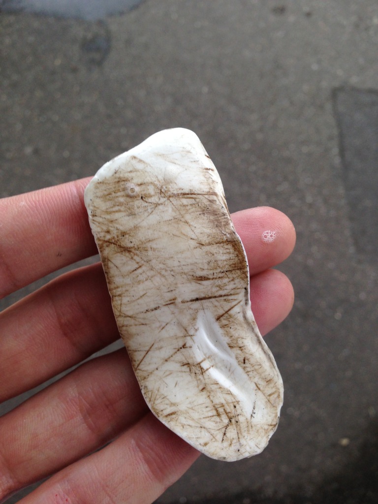

Hardly any tar on the car, so I went straight to claying, I used Bilt Hamber clay and Dodo Juice lube. (Giggidy).
Quite a bit of dirt removed from the front of the car.

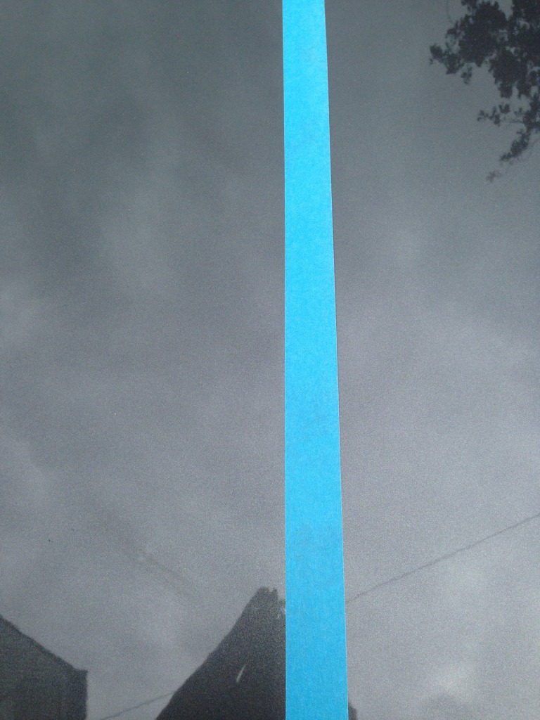

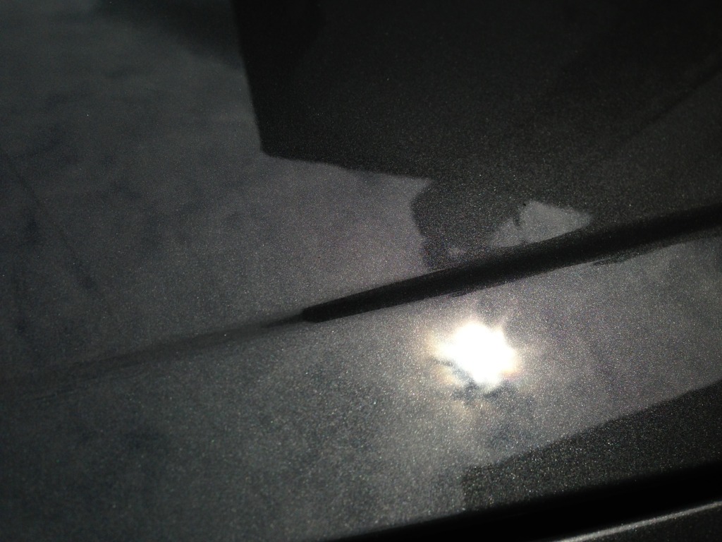

I used my DAS-6 Pro with Megs polish and Megs pads.
I then refined with Prima Amigo on a Lake Country pad.
Car was then re-washed again to remove any polish residue and dried so I could apply the Dodo Juice Light Fantastic Wax.

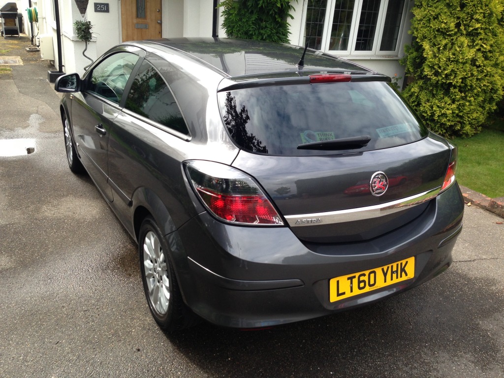

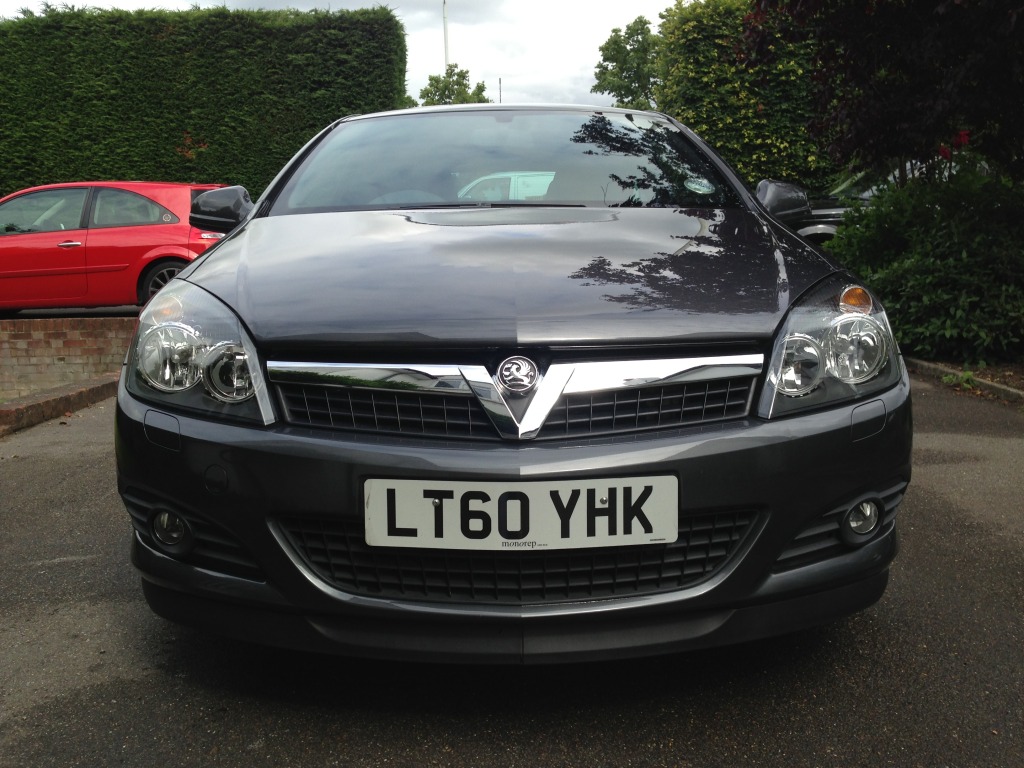

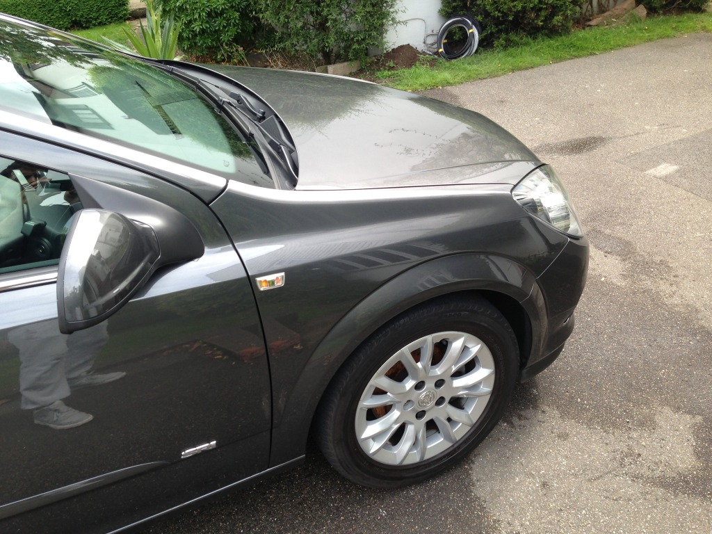

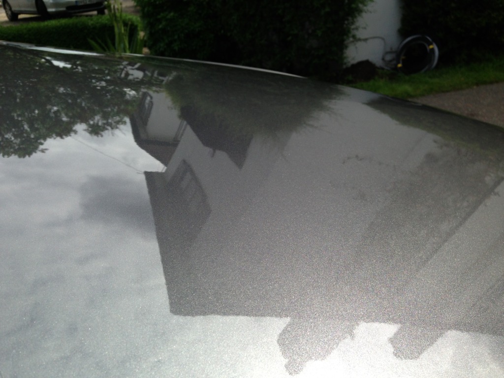

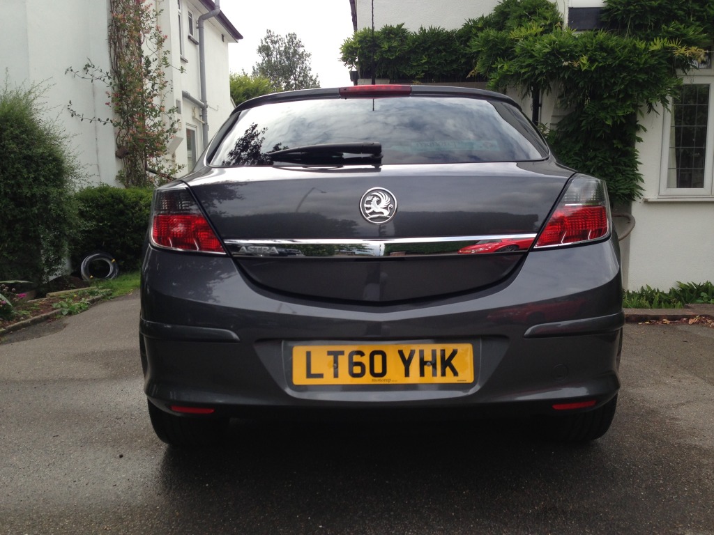

Heres the finished product with all scratches completely removed.

Lovely colour, nice effort! Bet she was pleased
Little tip for next time. Wash or rinse after using the megs compound, not after using amigo as it may wash out some of the glaze / filling ability. Will still leave a great base, or better, for waxing over.
Also looking at the dirt on that clay, invest in a tar remover, use after washing , tar remover, then rinse, then clay. Removes a lot of dirt that the clay is picking up and makes life a little easier for you.
