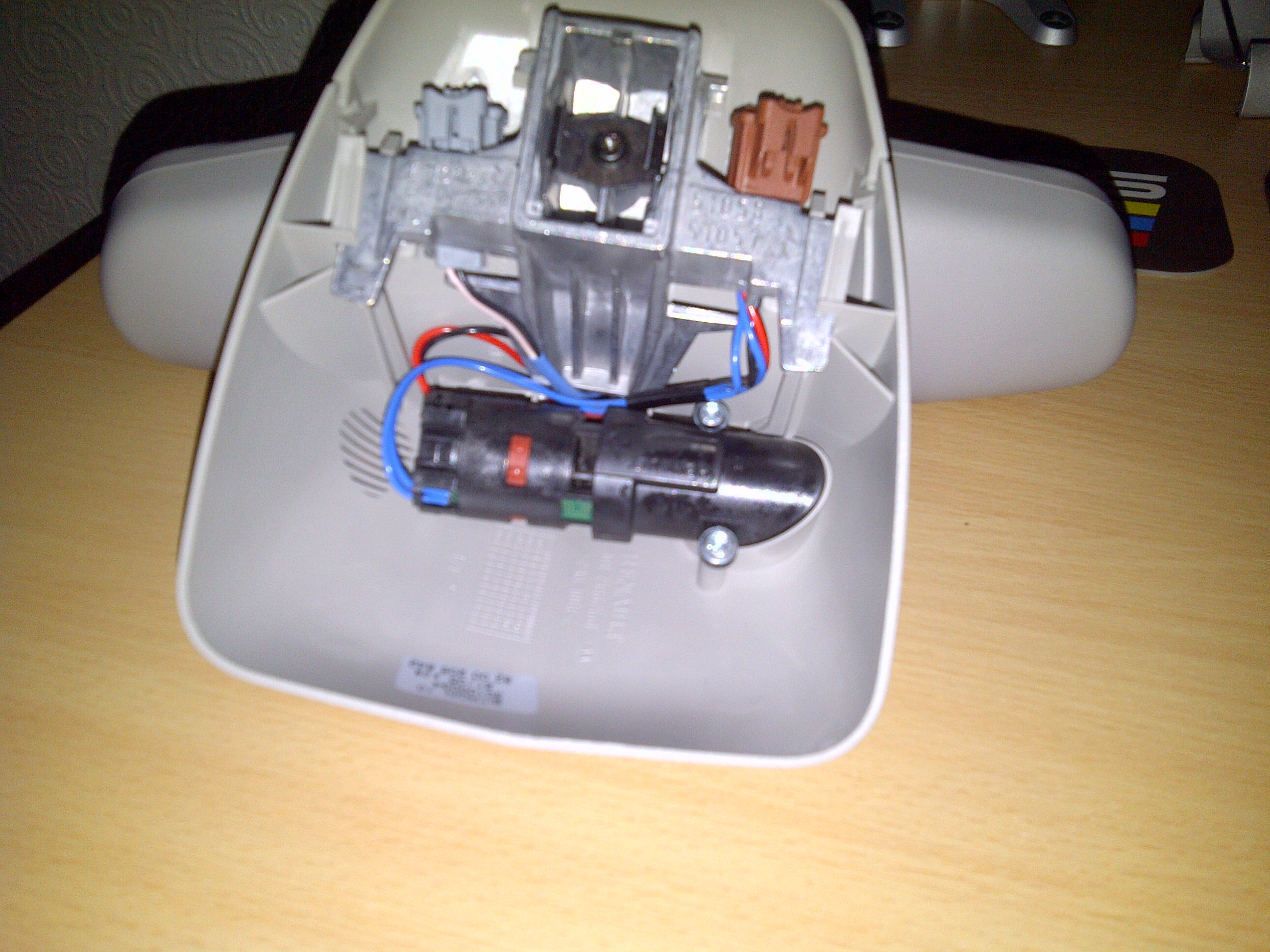

I have really annoying rattle from the rear view mirror in the Megane.
I have managed to narrow it down to this:
Any idea as to what the black little box does and how I stop it rattling?

looks like some sort of sensor.... maybe climate control, or those pressure activated alarm things
put a dab of hot glue either side, should stop it.
and by hot glue, i dont mean super glue!.
hot glue = easy to pull off :)

Thanks for the response mate!
It isn't rattling around, the sensor is secure. It is something within it that rattles when the car is turned on :dapprove:

hmmmm, i'll pull the one off my mum's megane when she get home and i'll have a look into it.
has it rattled before or just recently?

Been doing it for a while. This is just the first time I have actually looked at sorting it out.
Appears to be the climate control sensor, as there is a temp sensor sticking out of it.
Looks like it's the little fan behind the temperature sensor that is causing the rattling/buzzing sound.

just had a quick look, i see what you mean, this one is buzzing aswell :dapprove:.
its either general wear and tear or a common fault.
best thing to do is source a new part.
won't be cheap from renault, my guess.
Climate control sensor, buzzing fan. Seems to be a common problem.
Clean it or new one. Will give it a clean up and see what happens.
yes, have you got some electrical contact spray? put abit of that on some cotton swobb and clean the area. should hopefully make a difference
Done!
Cleaned it all up, and refitted. Much much quieter now!
Going to get a quote for a new one now, thanks mate :)
