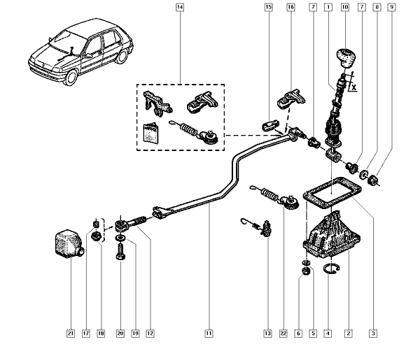

On all early Renault's they have a gearshifter retainer spring on the chassis of the vehicle. This clips onto the floor panel and then onto the gear shifter. It creates a tension between the two which stabilises the vibration / wobbliness of the shifter inside the car.
Im not saying this will cure the fault as it may be something else - its worth a try though
