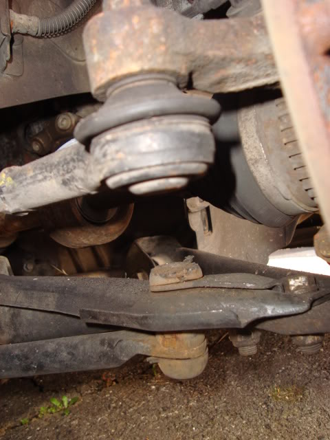

Right, I've had my wheels off today, to have a look, got new discs on order, but just thought I'd have a look as its getting really bad now. Shakes the front of the car!
Here's the photo from the passenger side, could this also be something to do with it, and does this need replacing? :S

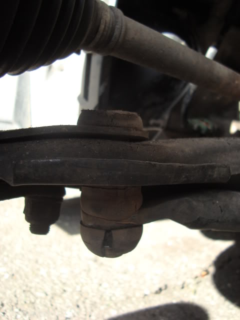

This is the drivers side one:
I haven't replaced the discs yet, so I know its probably them, I'm waiting for them to be delivered.
I just thought I'd check out any other possibilities whilst I had a spare hour, and noticed the above?
It's an ARB mount, only about a fiver to change If it's completly knackered you can generally seperate both parts that it's there to keep together.
Cheers for the help, yea I know its the discs most probably, I've ordered some Brembo ones. The pads have got plenty of wear in them, but think I'm going to change them as well anyway.
So that ARB mount, is it still okay, its still basically together?
