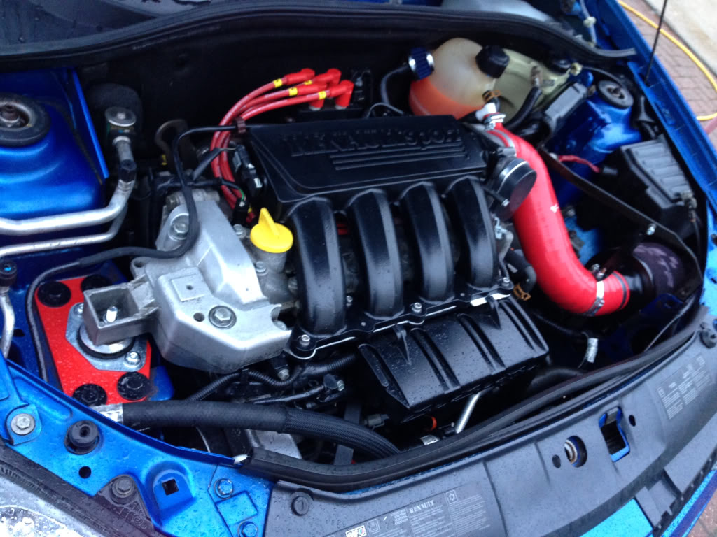

I've just set-up my own K-tec style kit for the grand total of £35..! All you need is the standard induction pipe that connects to the airbox and buy a 90degree 70mm outer diameter stainless induction pipe(350mm long) and a Ramair filter. I have to say it sounds awesome on full chat and very normal for town driving and it feels like it pulls better high up the revs...
A guy did a test with the same set-up as mine on a rolling road(before with airbox and after with this set-up) and gained 3.5 bhp with this setup overall, you lose torque around 3000 rpm but it picks up better once the revs rise. So anyone saying induction kits lose power I don't think are strictly right, right set-up and you can gain power and it sounds great! :D
