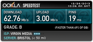

now i'm getting similar problems again with pages not loading but everything seems to be fine (wireless signal full and saying connected to internet and even the light are right on the SH) and when it is working i'm getting 60Mb down 3Mb up

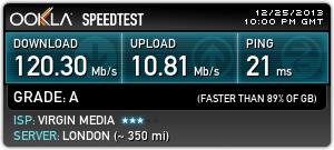

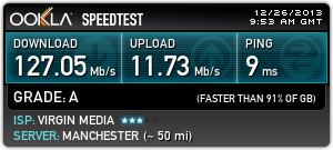

This is with SH2 to netgear 10/100/1000 switch to laptop
