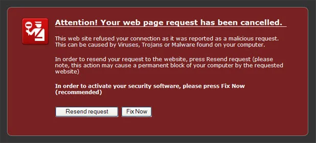

then i turn it i some virus thing pops up and tell's me to scan.i close it and start up "Malwarebytes' Anti-Malware" it finds 6 or 7 virus's
thought it was gone but whenever i go on the internet some pages pop up with this
tried avast,spybot as well.
thanks for the help
not that simple im afraid:(
its blocking most pages
facebook,ebay,
sometimes cliosport.
i think the antivirus scans got rid of the software but left a little bit in the internet explorer and mozilla
