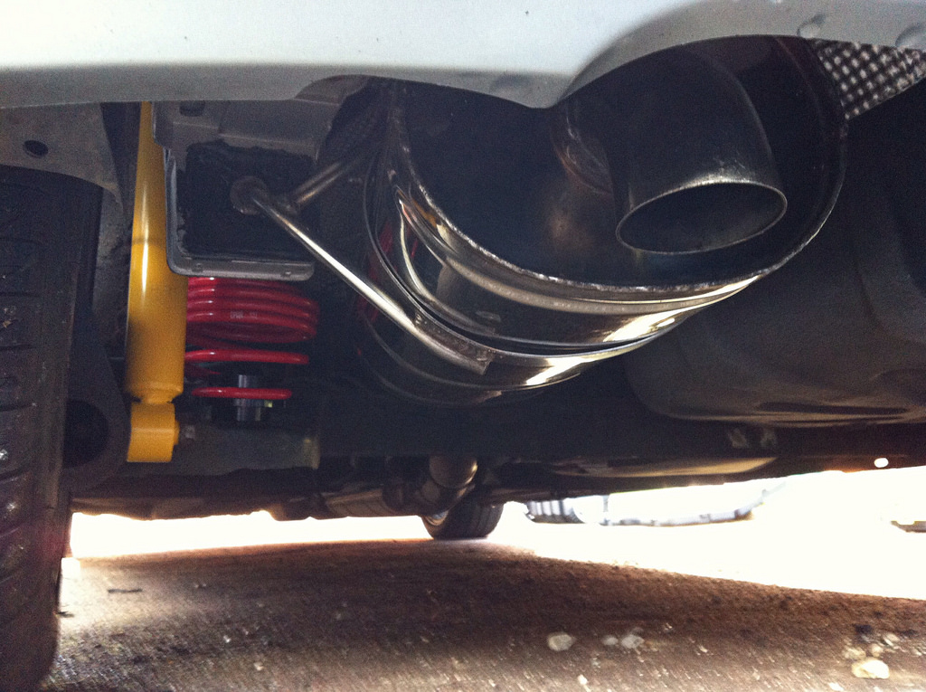

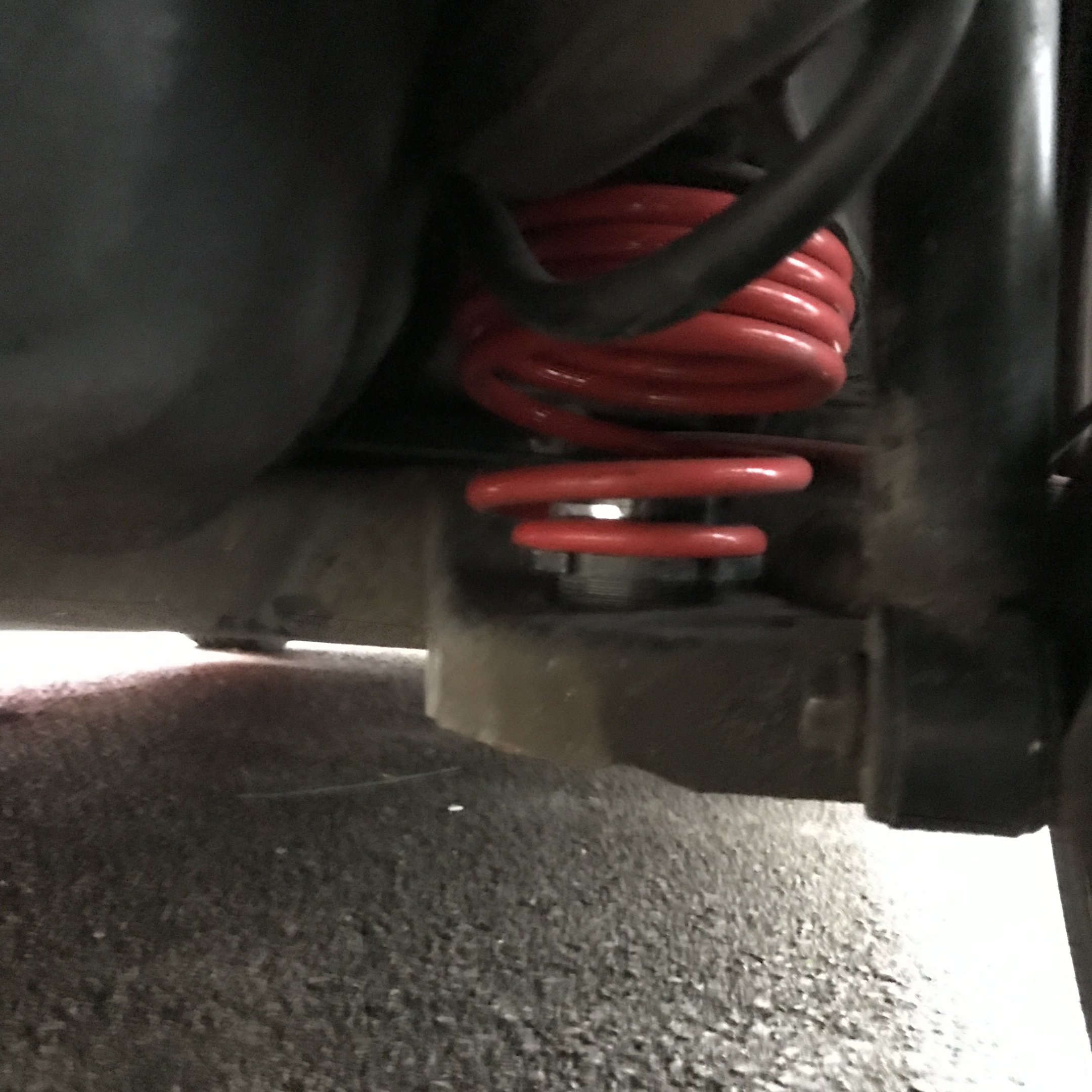

I've narrowed down my awful knocking noise to my cheapo VMaxx spring compressing too much and hitting themselves over bumps.
As you can see just stationary they're far too coiled up?
So going over bumps surely they're gonna make a knocking noise I'm experiencing?
I've tried reseating them and it hasn't helped. Also they can't fit the other way around due to where the adjuster is designed to fit and the shape of the spring itself.

Sure this has been an issue with the Vmaxx coilovers for a while. If you Google, you'll probably come across a couple of threads mentioning the same issue you're having.
I've got some rear Eibach springs knocking around in the garage but I don't think they'd fit with the Vmaxx adjusters.
Jesus, those springs are not doing much like that. Just take those adjustment platforms out and fit the OE rubber platforms to raise the car, which will extend the springs and stop them from knocking.
Yes it seems that way, I'd give that a go, but unfortunately I haven't got the bottom spring platforms/bushes to seat them on!! Only place I can find them is Kam Racing and they're £25 :confused::confused:

Your springs are standard for vmaxx. My old BG and Ph1 both did the same. (2 separate kits, not the same kit on both cars)
Jamess182
Well that's frustrating, cause that means it's probably not the super-compressed springs that causing my knocking issue? If that's normal for Vmaxx and you didn't have an issue?
Jekyll
My first kit (on the BG) was fine throughout ownership. I bought them 2nd hand but was only 3 weeks old and had done very little mileage. The only issue was a knocking on the rear. After some investigation and a thread on here, it turned out to be knackered shocks. They would compress quickly but not return the spring action. I got some new shocks (trophy ones) as a set came up cheap and it cured the knocking. Was fine from then until I took them off as I was returning the car to semi standard. I couldn't really fault them the as they lasted a long time and was used daily and for fun runs.

Appreciate your help there matey. Think I'll swap the shocks over first, got a spare set in the garage.
