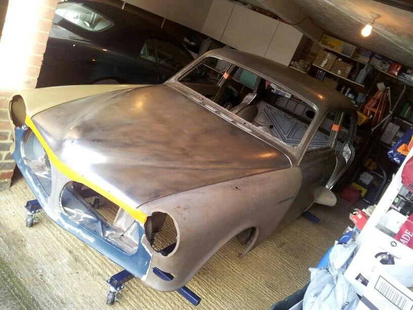

Lol. Sorry Seb. This is all I've got. Not much changed but alot of welding done.
Engine and front suspension will hopefully be done soon enough. But finding time off work is proving harder than I thought!

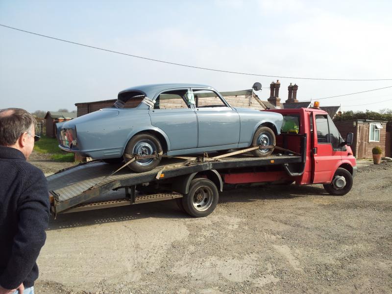

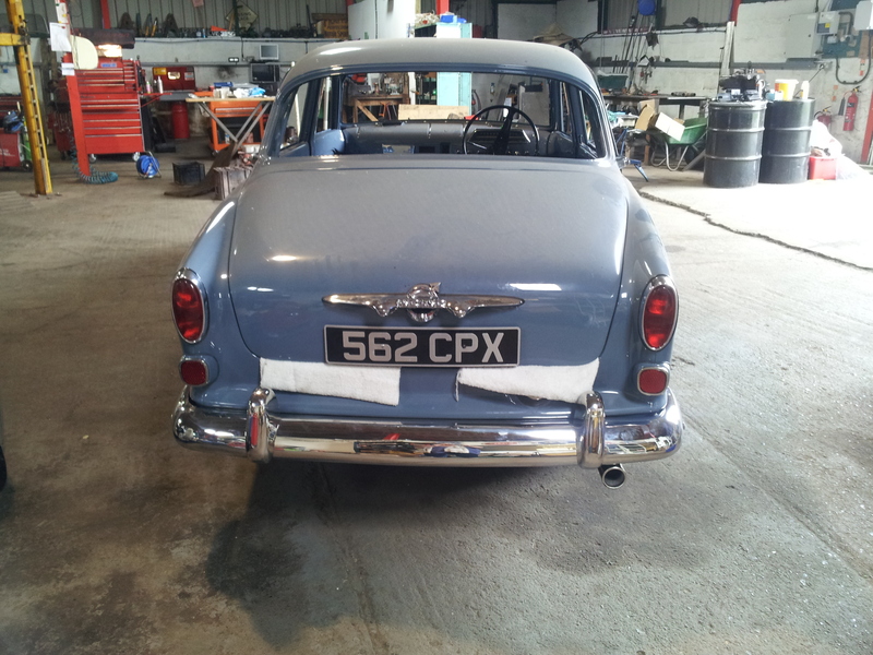

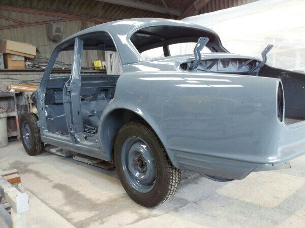

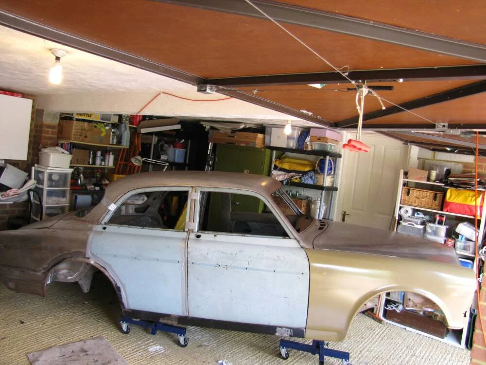

So, doors that I did have were way too far gone, another set were sourced so now starting over with alignment. You can also see from this picture that the sills and arches have been completely replaced. As soon as I can get transported sorted it will e off for paint.

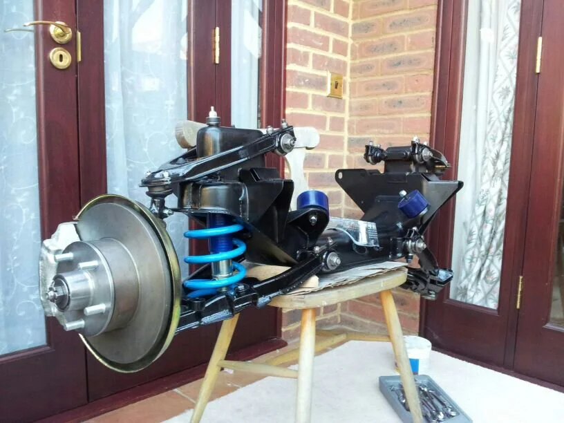

In other areas, front cross member is fully rebuilt, one bearing is a little stiff which I will have to take apart, hopefully it's not the had carrier itself. You can also se my shiny news discs which are a conversion from the original front drum brakes. I have also poly bushed everything. Adjustable Gaz dampers and custom lowering springs.

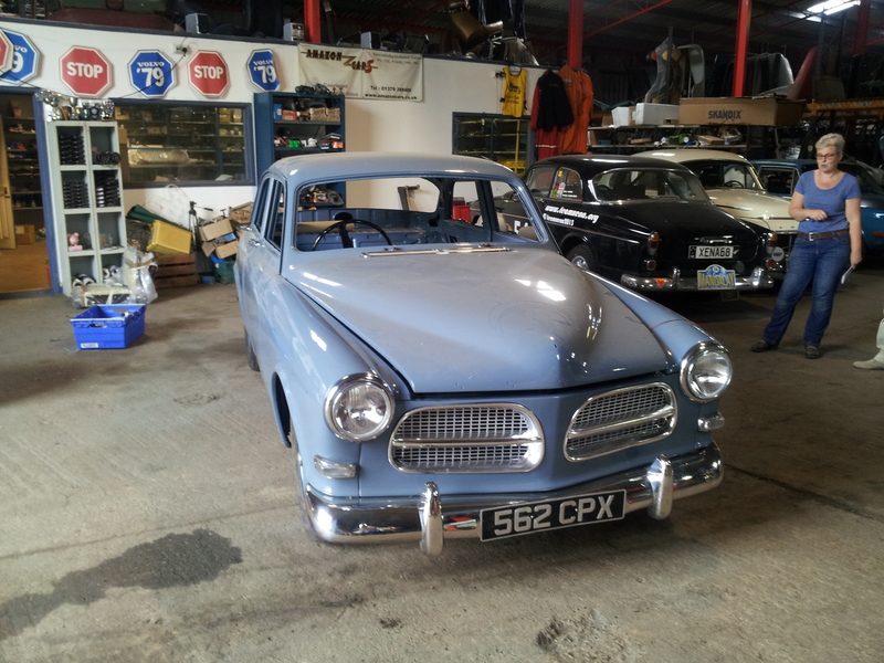

It is just the first two pictures Dave?

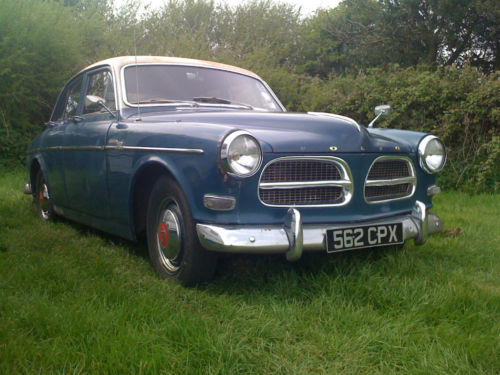

Picked up looking like this:
Have since found its original colour code so am actually aiming for this:

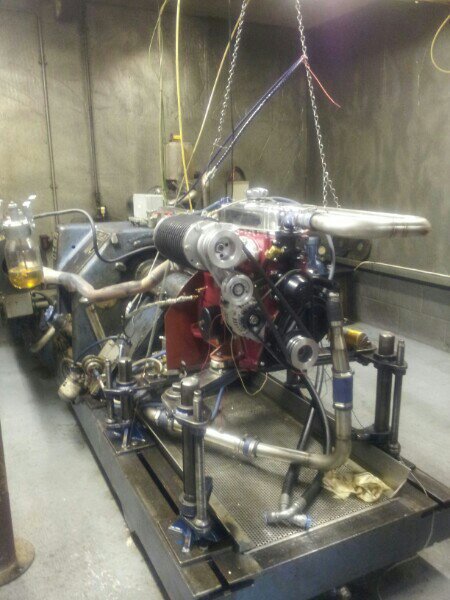

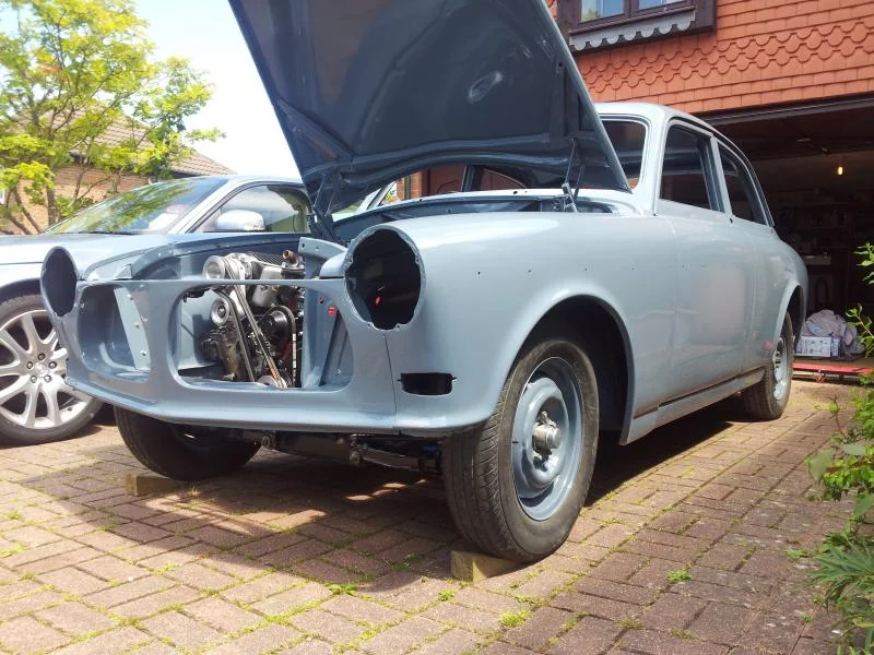

In Engine news, plans for the tuned 2.0 B20 went out the window. It's an early car, so has a thinner transmission tunnel, which limits me on gearbox options. Also wanting to keep some of the originality about it I decided to stick with the 1.6 B16.
So these had about 60bhp. So to keep up with modern traffic I needed more power. So to keep within my rule of 'period' modifications, managed to source a Supercharger. Engine has been rebuilt and dynod, 110 bhp peak but more importantly 90-110 ft-lb torque straight across the rev range. So happy with that!
