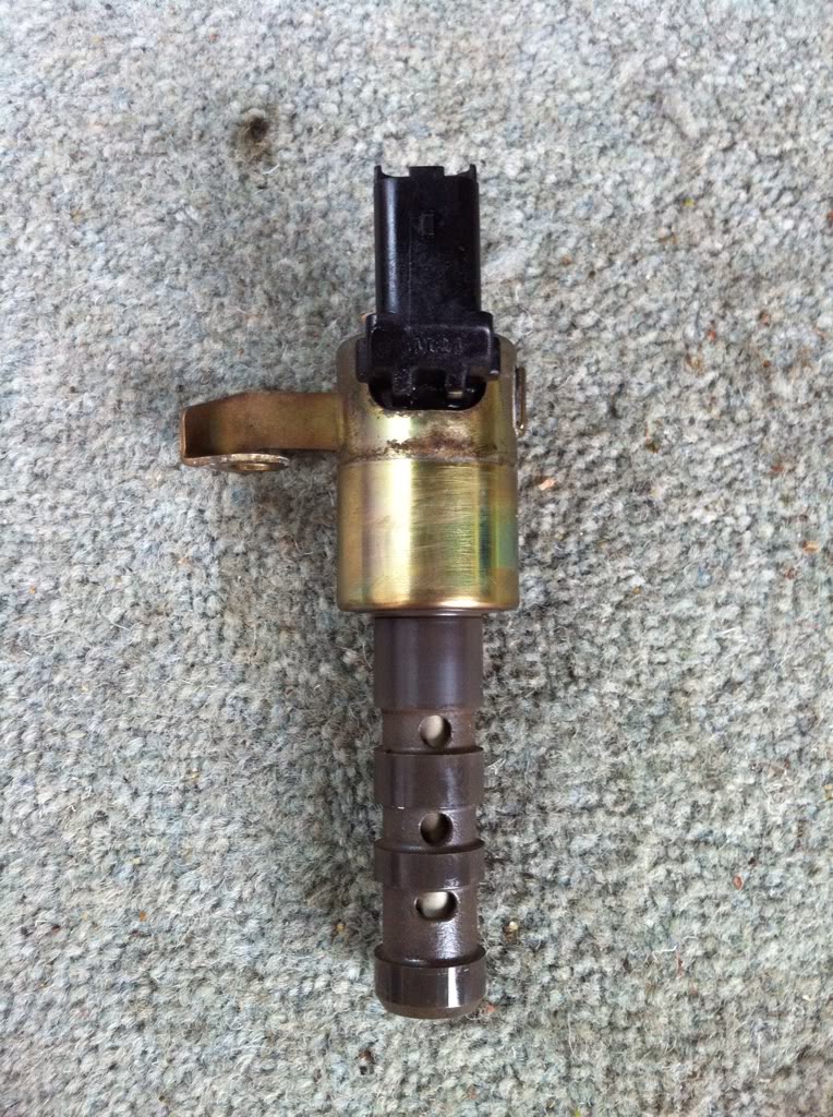

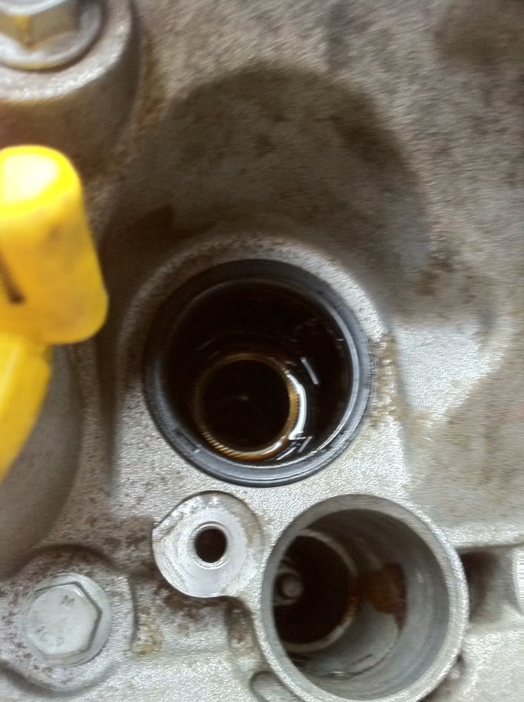

When I was changing my plugs, I noticed around the top of number 1 (near Vvt solenoid) it was damp with oil! On closer inspection, ther was a ring of sealant around the top of the solenoid, I removed the solenoid to find the only seal is the one in the top of the cam cover...and some more sealant inside (around the base of the fatter part of the solenoid)

Sealant?? i have had the same problem with seeping oil so i changed the seal (the one in the pic ) seems to be fine now, only costs around £7.

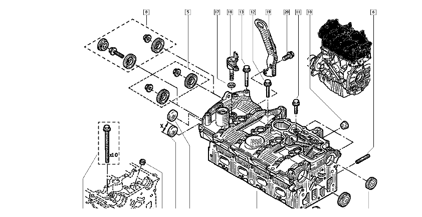

You wouldn't believe it but that vvt solenoid seal is actually a renault 5 headlight seal

ordered a new seal from Renault today for £6.87 :)
Should I remove the silicone from inside the hole then lol?
If theres any silicon sealer around there get it all removed and cleaned out!
Can't see any on the pic though
Pull the black seal out and tap the new one in with a socket - they're a bit delicate so be gentle :D
Yeah there is silicone in the hole. Where you see the oil...the oil is sat inside a ring of sealant made from when the sensor was fitted and squeezed sealant out! Lol who knows what goes through some people's minds :S Lol

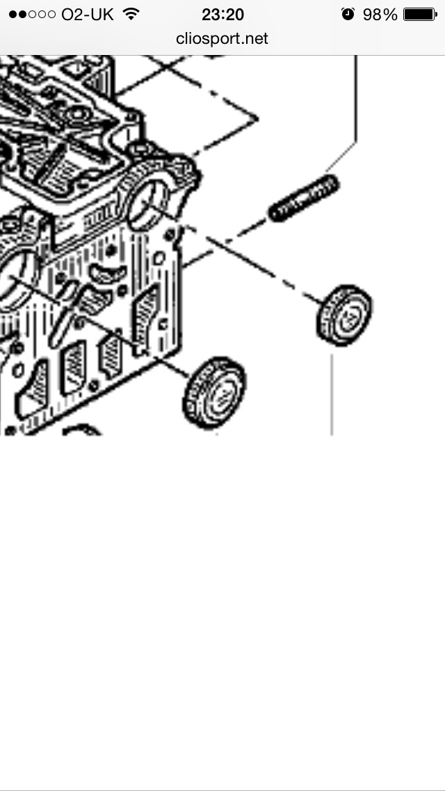

Can any one tell me what the 2 caps/seals on the rhs of the engine/flywheel end in the pic above are called please or what they are for? my lower/front one is leaking.
