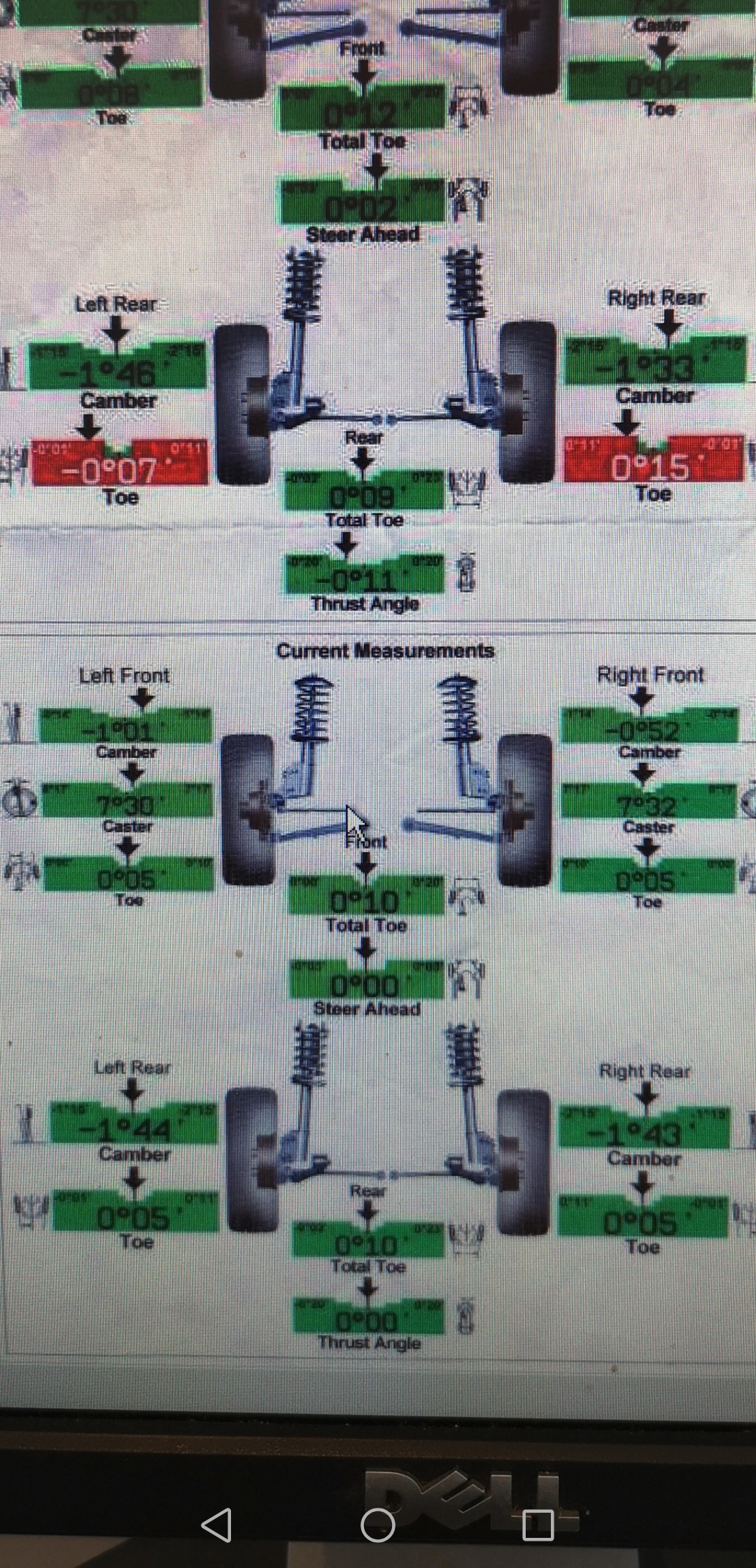

R3k1355
Settings look to be ok.
Have you done the basics, check the tyre pressures? Otherwise it's time to look at the brakes.

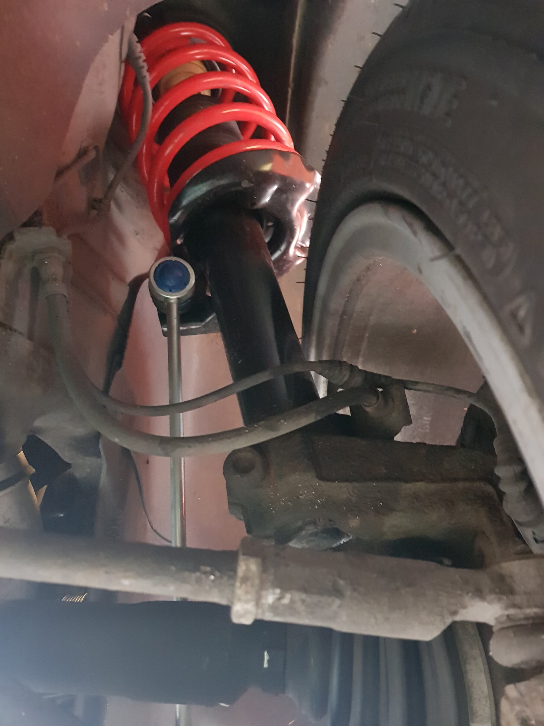

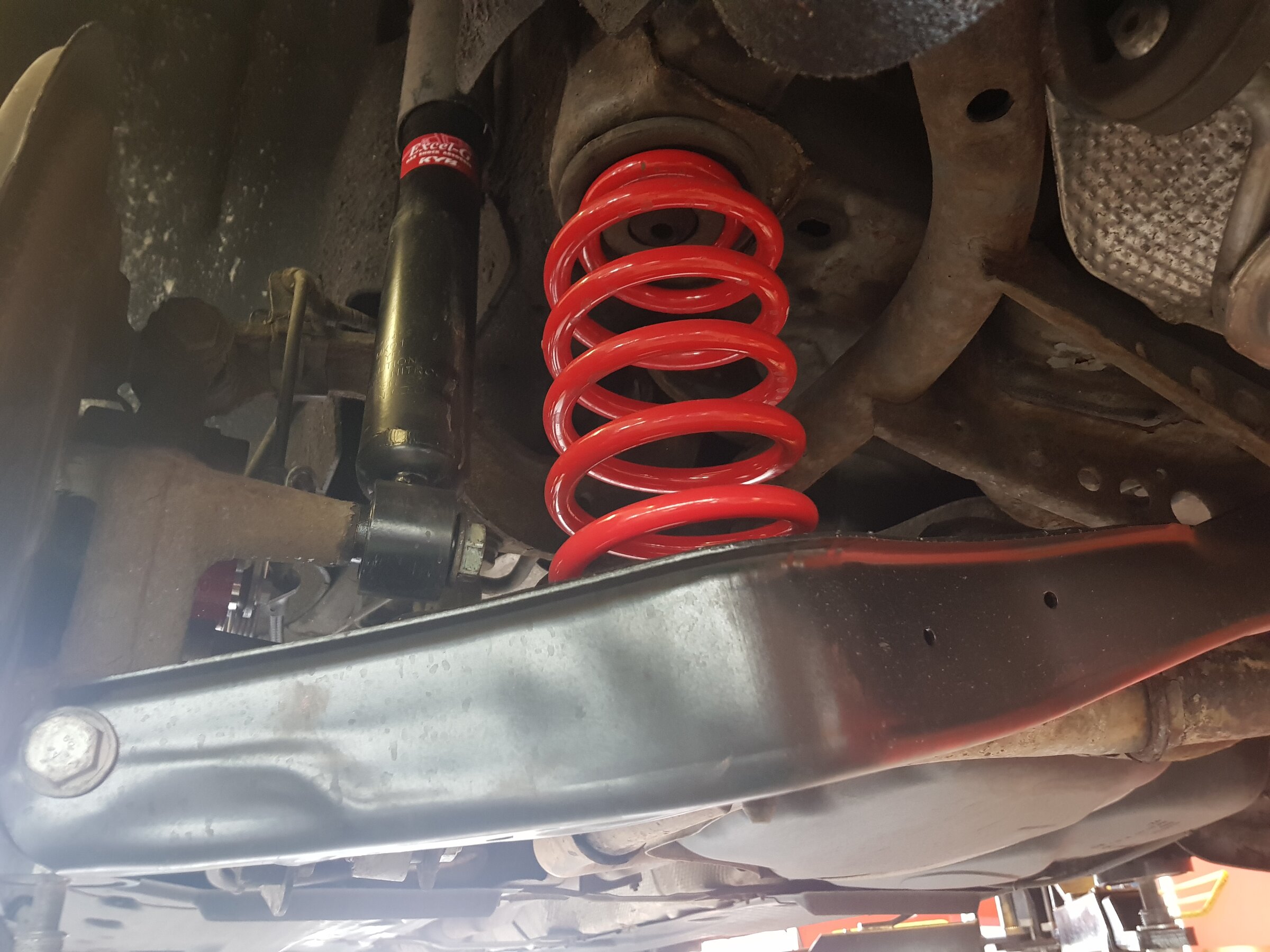

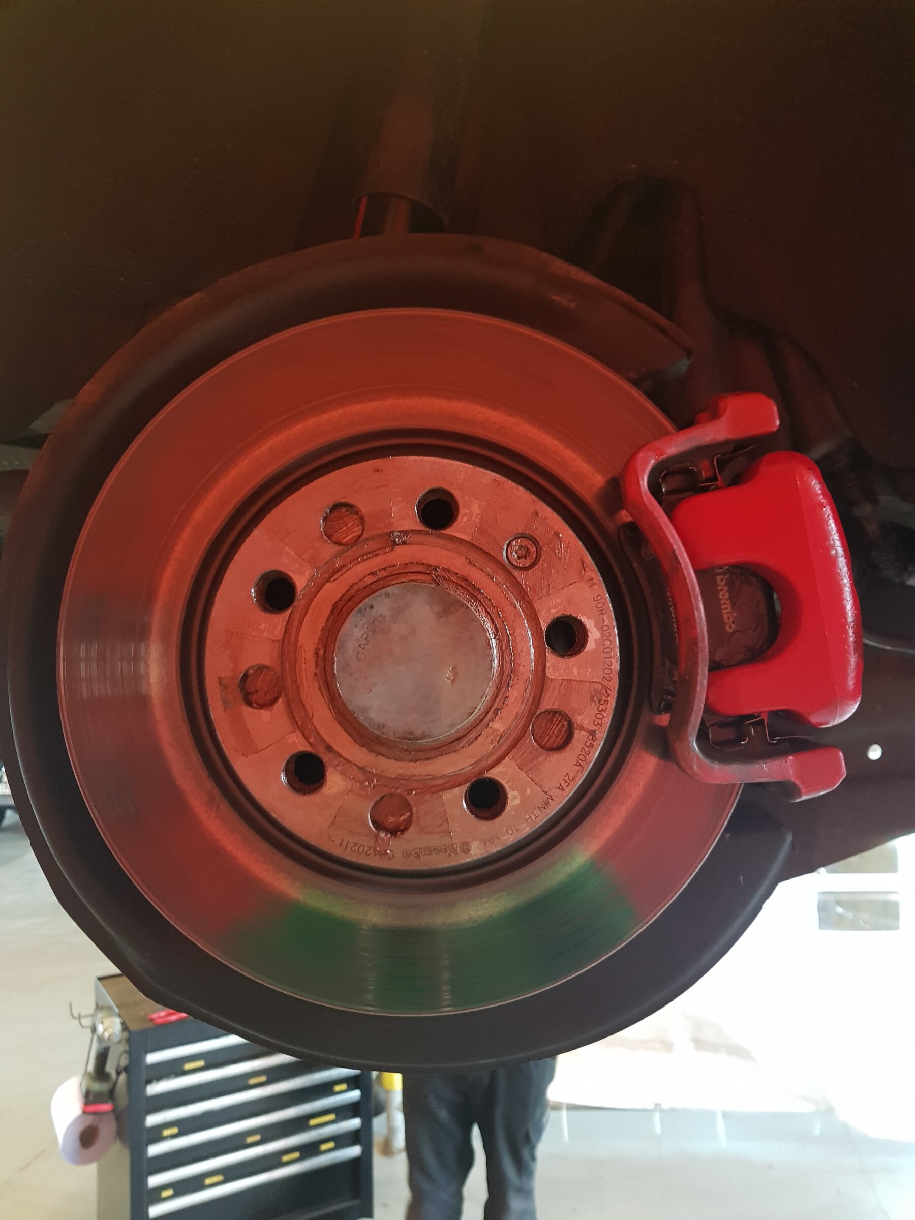

My so called refurb calipers I got were s**t so we ended up fitting new ones and the difference was night and day. The issue with the steering wheel rubbing is sorted. Handbrake is all good, then I got my refund from the alignment place so gonna book it in and that should be the final job lol and I need to adjust the trim around the stereo. Whilst the car was there I had a look underneath and got some photos.
Almost there now! Alex from Car Throttle was creaming over my springs 😂

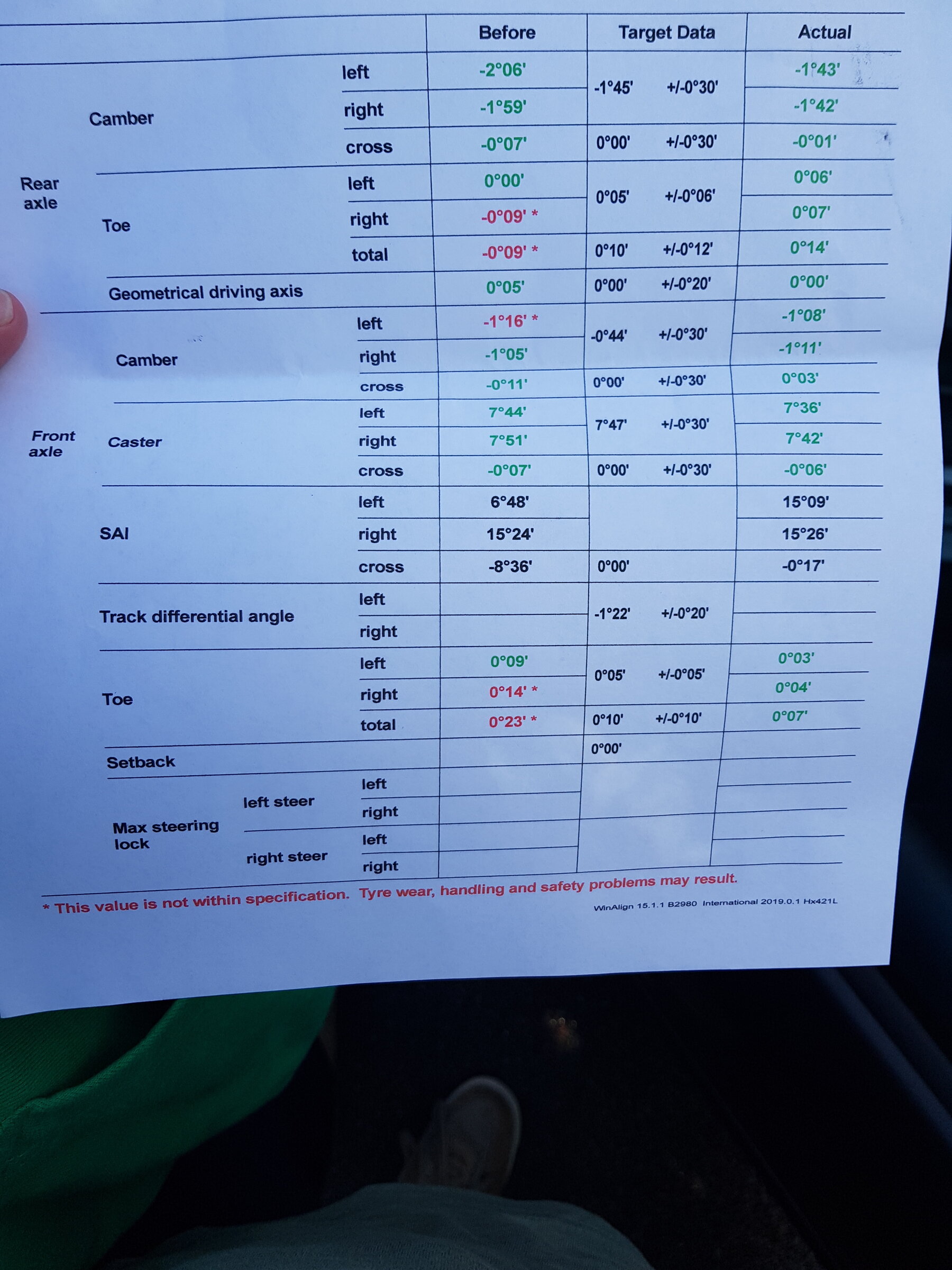

Went for a proper alignment today, discovered one of the front wishbone bolts was wrong and dangerously too short so I went over to the local dealer who kept them in stock and got that fitted at the same time. They had to do alot of moving around which is what I expected, but it's so much better now especially at the back.
Settings below for reference.
