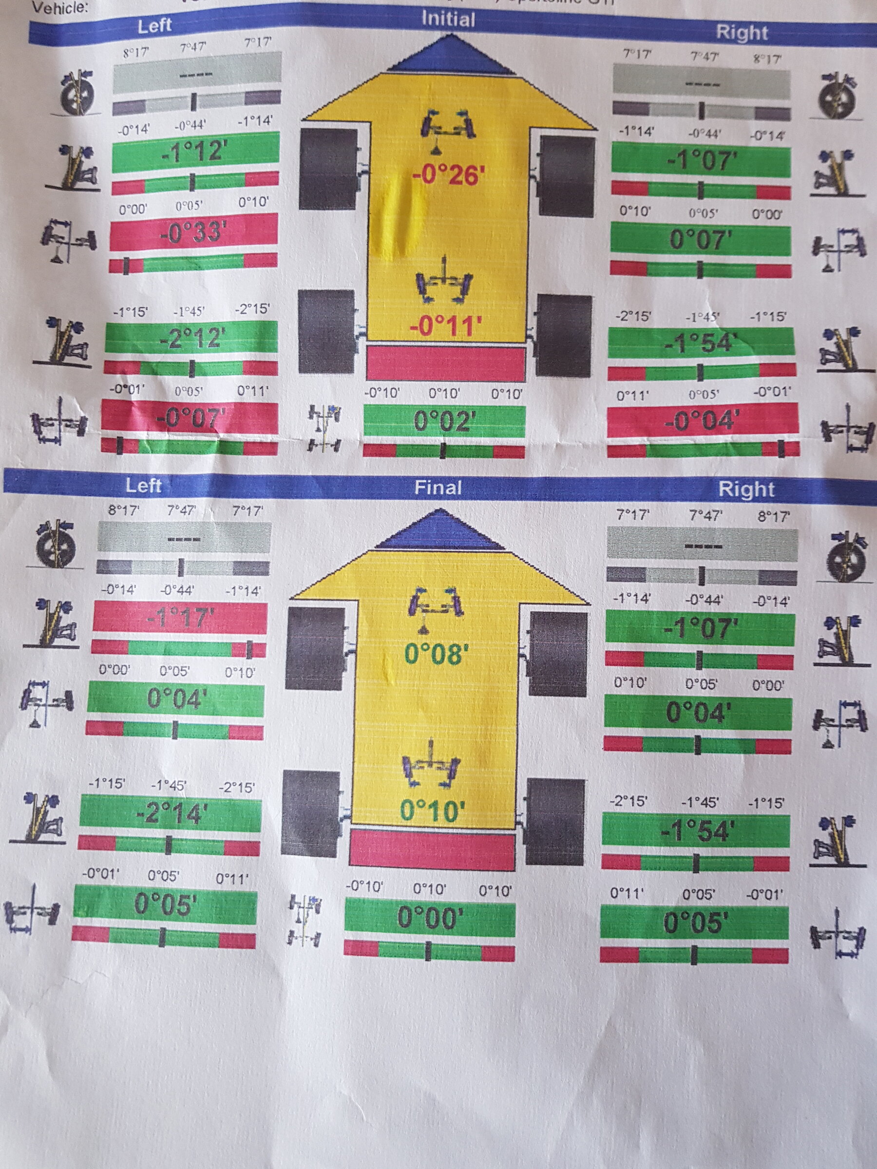

Got it back from alignment and it pulled left took it straight back and they said "we will put it on the ramp" I walked round the back and he was lying on his back adjusting it. I drove it again and it was pulling right and under harder braking it felt unstable almost crabbing. They closed so I couldnt go back again, but I think I'm just gonna get my money back it was 65 in total, but I think they forgot I already paid a deposit so tomorrow I will get a refund and go somewhere else. If anyone else can make sense of the figures below it would help.
Good news is I sorted the stereo so it seems to remember settings now and steering buttons work, just need to monitor the battery if it drains. I might need to work on the fitment as it's not great either, but at this stage I'm just happy that it's in and working!
The above alignment shouldn't cause issues under braking. Seems like a brake bias unbalance. Have them put it on their rolling road used for brakes if they have one.
