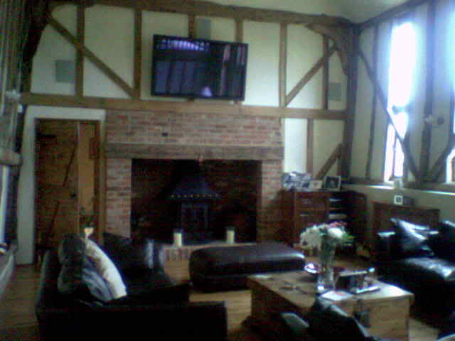

This is what I call a plasma think it was a 65" badboy, but was rather large in depth as was bought years ago.
thats a ridiculous place to mount that, your neck must be sore a fukc watchin that! ive installed quite a few plasmas, ideally they should be eye level when seated should they not?
