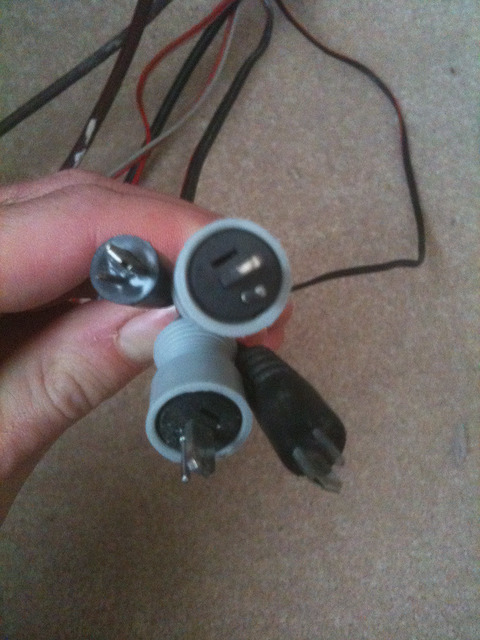

I am going to keep my built in speakers, but would like to put them into the back of the tv? but they come with the picture below wiring, can any one help with how to fit these into the back of the tv?
Thanks
Saround Sound Wires by apicken21, on Flickr

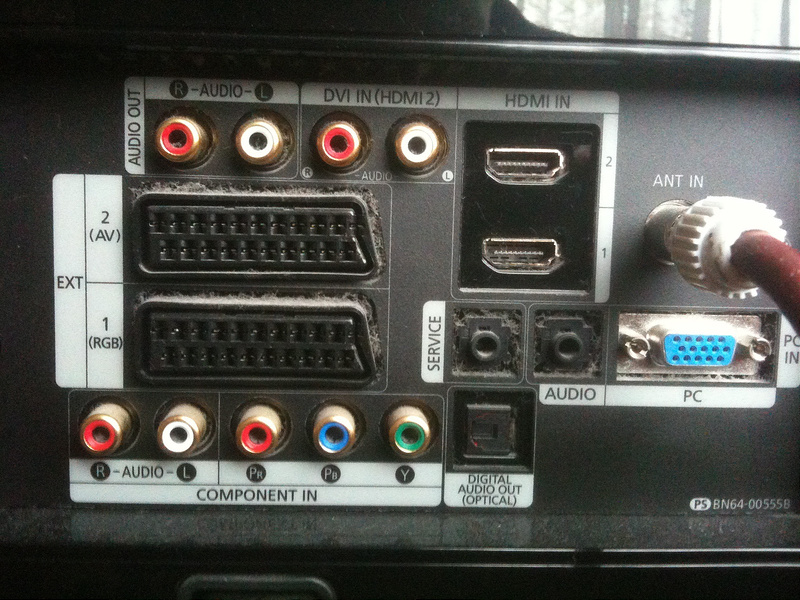

What outputs do you have on the back of the TV?
Just chop the connector off and attach the appropriate connector for the TV
Some older TV's "might" have these type of connectors for speaker outputs..but I "think" most newer ones have that type of output as well
Although it might not be that easy of course if you only have one speaker output, it looks like you have 4 speakers there.
Yeah you cannot do that unless you take the audio outs (red and black in top left of your picture) to a woofer/something that splits the signal first. A surround sound box basically.
So basically you would come out of the tv via those two RCA sockets, into a unit that then feeds all your wall speakers.

If they're normal speakers with a twin cable with the connection pictures above it's probably possible to chop the connector off and use bare cable into an amp that accepts it (many do). Hard to advise really when we don't know everything you have / want

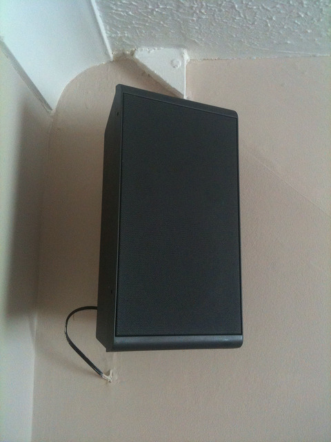

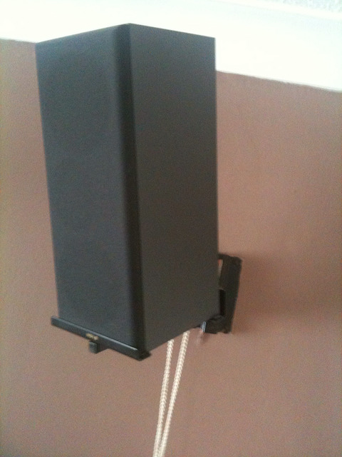

I would like to use the speakers that are there, as the wires are plastered into the wall, when we moved in they weren't plugged into anything, All I have to work with is the speakers that are built in, which are nokia SRP 1001, and the wires (picture bellow)
Untitled by apicken21, on Flickr
Wall Speaker by apicken21, on Flickr
and my Samsung tv (picture bellow) and PS3 system
Back of tv by apicken21, on Flickr

Option 1.
Cut the wires off the back of the speaker if they don't disconnect, and cut the plugs off. New speakers, amp and rca cable, job done.
Option 2.
Cut the plug end off, buy amp and rca cable, job done.
I don't see what the problem is really.
