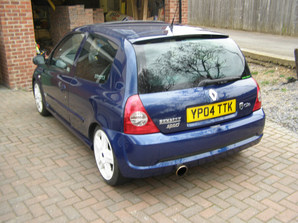

Why not get a 172 rear bumper? Looks identically except minus the two exhaust cutouts. Therefore no need for new exhaust and a much cheaper way of doing it.
+ Im not sure what colour yours is, but the 172's came in pearl black, which means the colour is the same as on black non sports, so no respray needed either, you literally just swap the bumper. Not sure about Campus colours though.
Edit: here's a pic of a 172 bumper:
