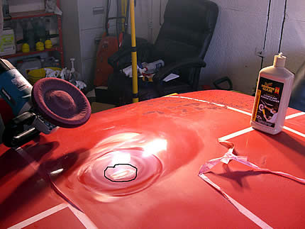

Paint work is fully machine polished using a range of fine abrasive polishes to remove fine scratches, oxidation, swirl marks and other paint defects
(A combo of Menzerna 3.02 and 3m fast cut and then finished off with Menzerna final finish)
