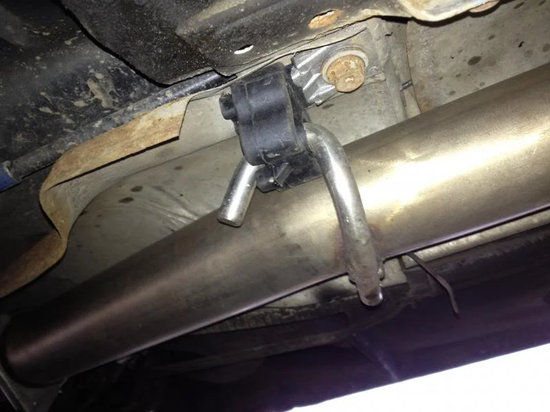

Picked the car up after work and the centre section looks good (as I'd expect). The blow is gone which is great but as I've only driven it home in rush hour traffic I haven't properly tested it. The normal cruising noise isn't much louder at all so I'm happy about that. Will get a pic up soon and report on the noise during more spirited driving.

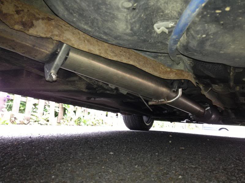

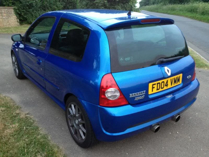

Ok so time for some update photos!!

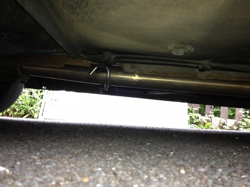

Firstly, here's my new exhaust centre section. The photos suck but you get the idea:

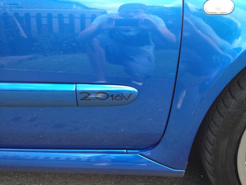

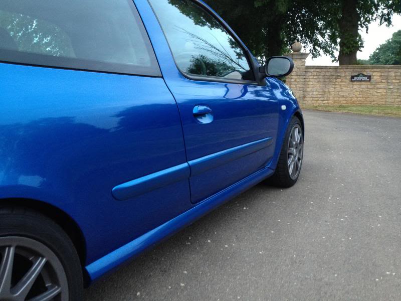

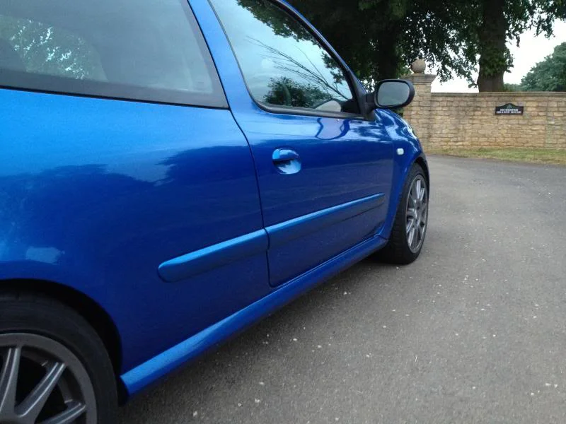

Moving on, my nice new colour coded bullets from Bobby on here. Fitted them only a couple days ago and I think they look great. I like the understated look:

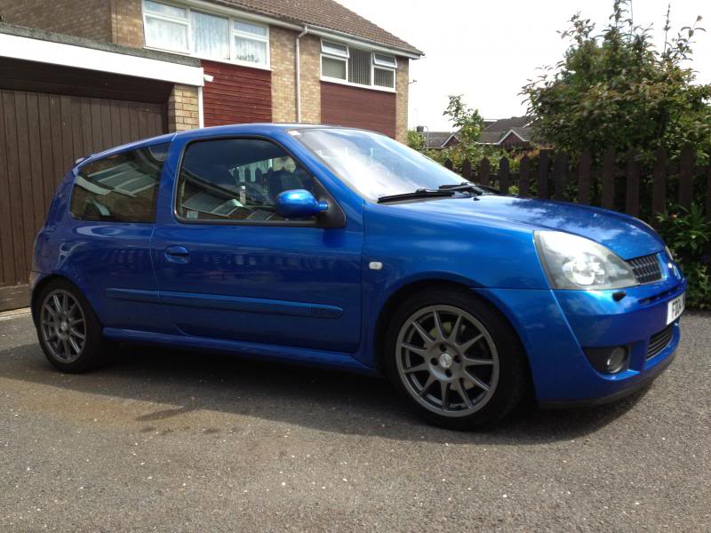

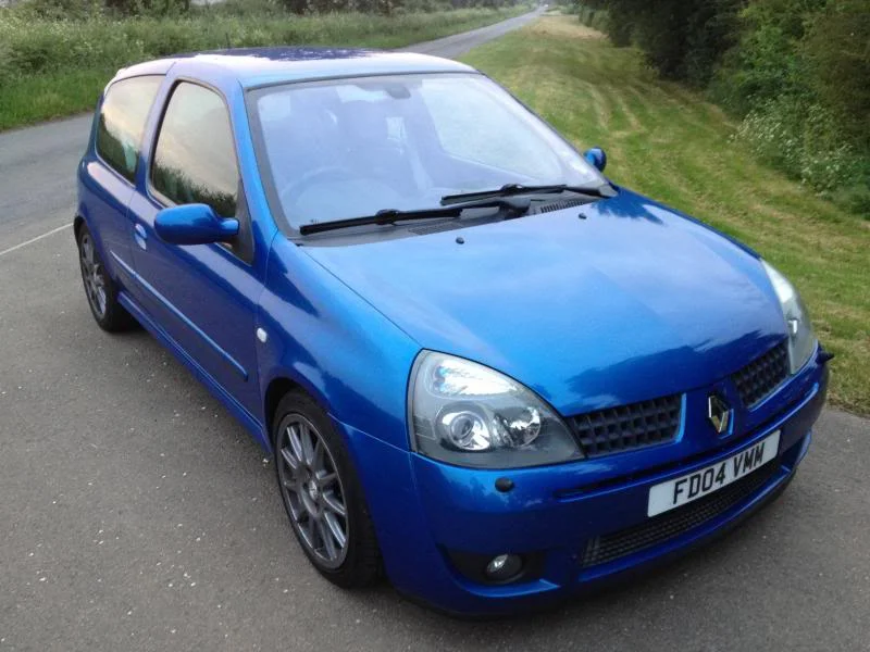

And here's some shots of the car now after a quick clean:

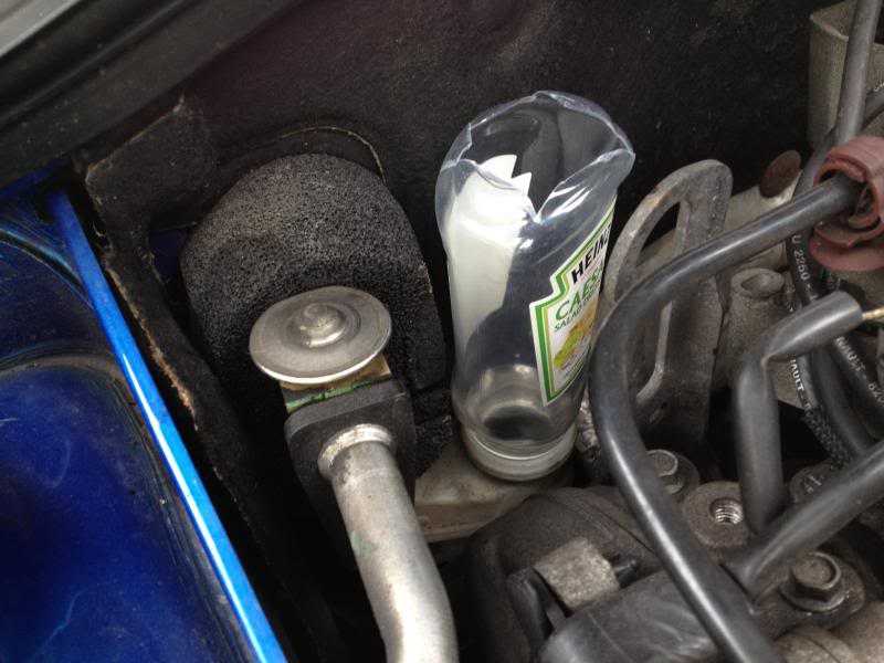

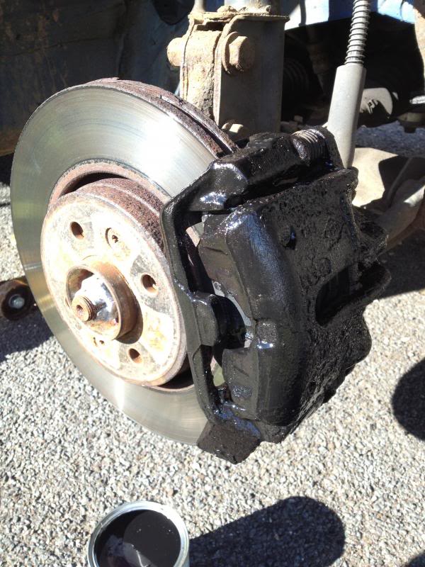

Topped up my brake fluid. Can't beat a Heinz funnel:
Also decided to paint my calipers, just a simple bit of smooth black Hammerite:

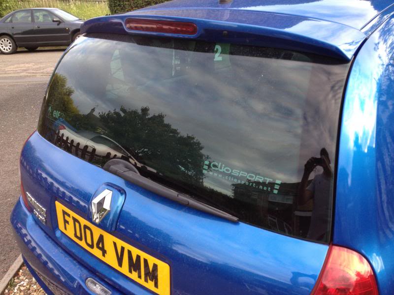

Little job I've been meaning to do for months!! Fit my CS decal in the rear window. Excuse the filth - it's getting washed over the weekend.

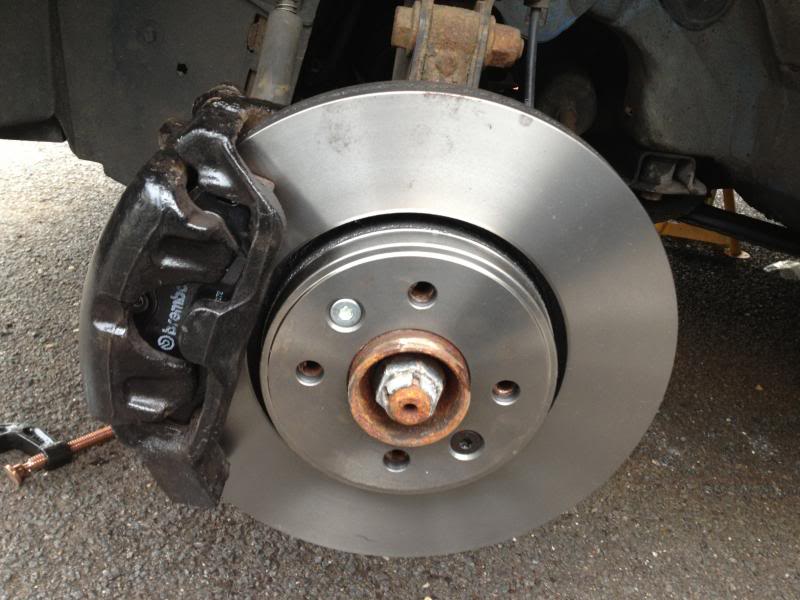

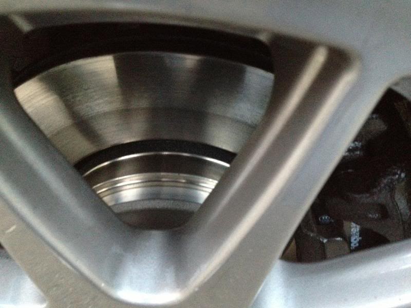

Monday evening after work it was time to fit new front discs and pads. I opted for Brembo HC discs and Brembo pads, these were £74 delivered from G172 and arrived on the second working day after ordering! Great service. Now this may not be a big deal to most on here, but this is the first time I've changed my own discs and pads, and I must say the feeling of self satisfaction when you are done is brilliant!

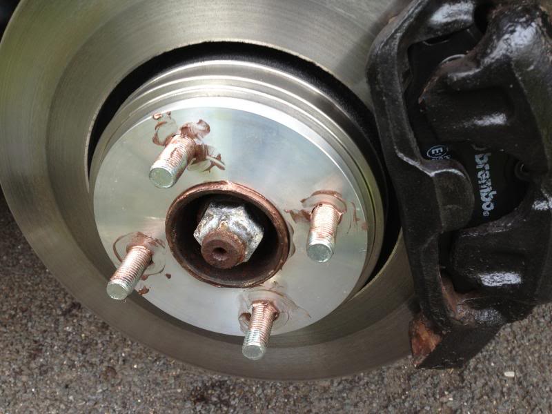

Today after work I set about fitting my front studs and spacers. The studs are 60mm and went on a treat with some stud and bearing loctite. The spacers are 10mm from Dan@MAD and the quality of them is outstanding in my opinion - so glad I opted for these over the crappy universal ones.
And this is how it currently sits on the drive. The wheels will go back on in a couple hours when the loctite is fully set and I'll get a photo to show how it sits. Regrettably, in the excitement, I forgot to take a 'before' shot - I apologise.

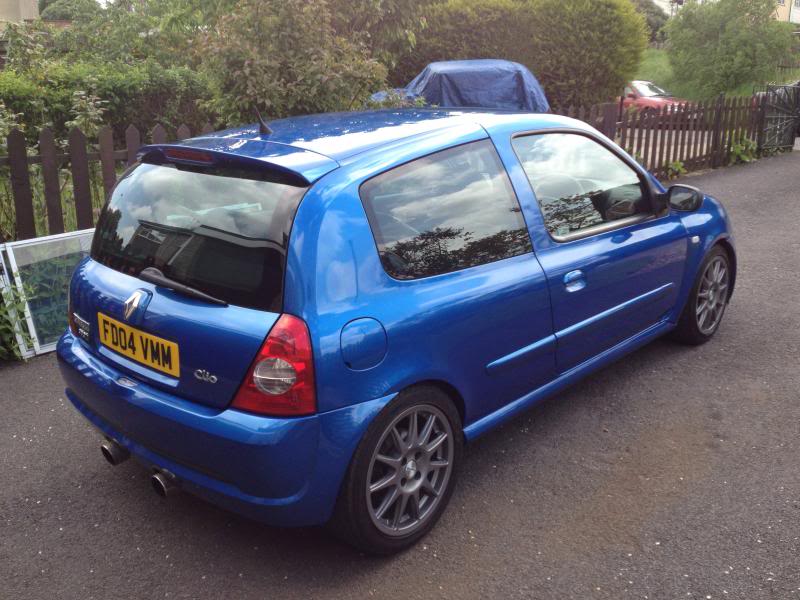

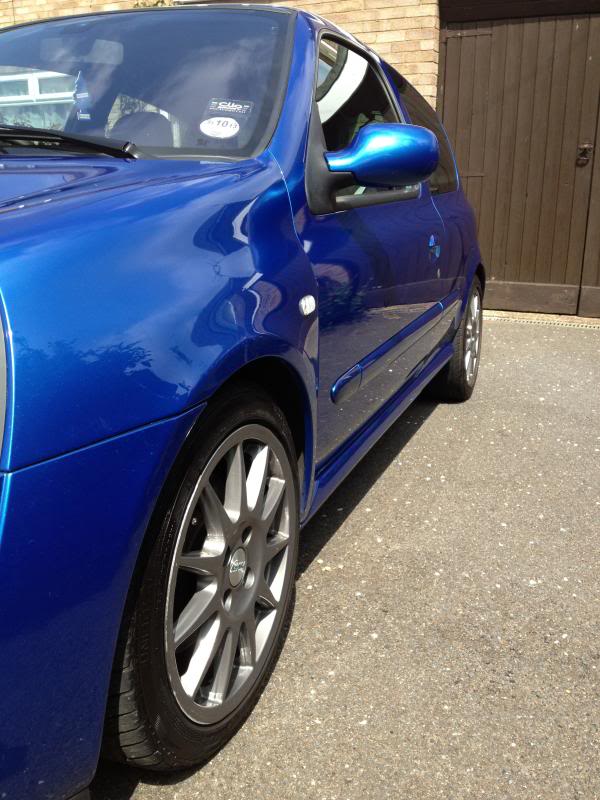

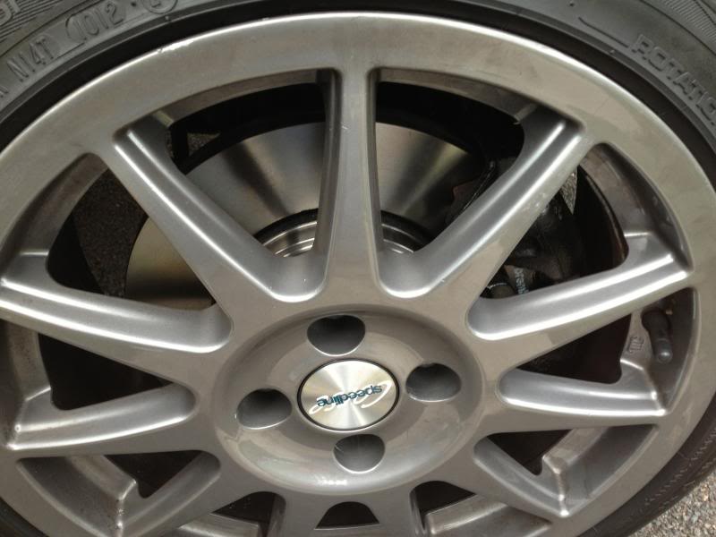

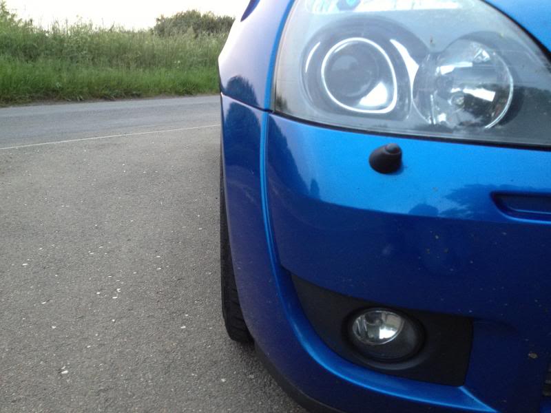

Here is a few photos from a couple of nights ago showing the spacers fitted on the front.

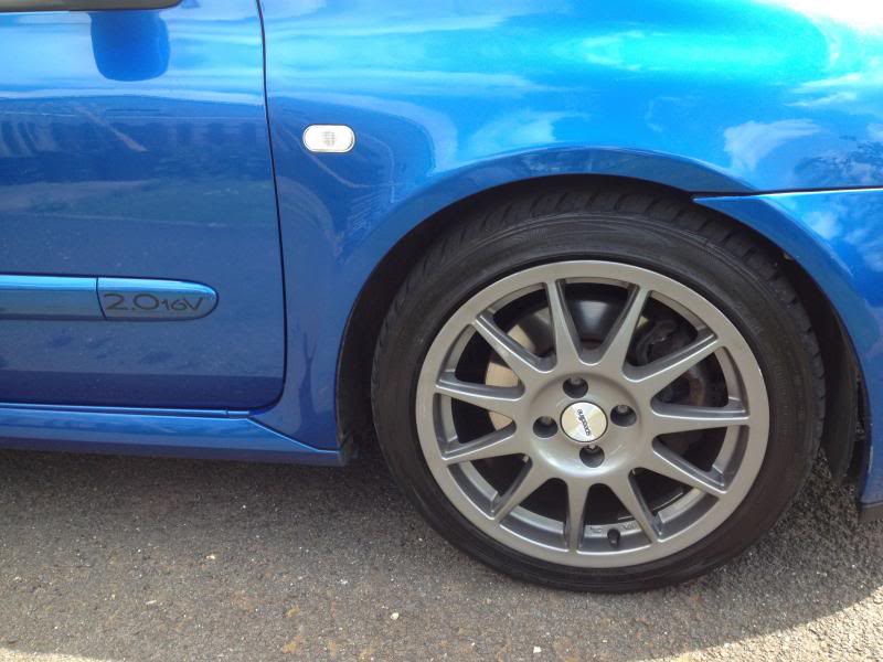

Added some Speedline Corse decals to the Turinis, supplied by n2grafix off here.

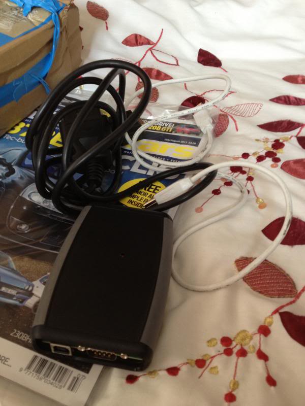

I purchased an RS Tuner off of here last week and am currently in the process of upgrading to the 98ron map. I have run into a couple of little technical issues with it (cal download issues from the website and the inability for the tuner to back up my ECU) but Henk @ fastchip is fantastic and responds with the answers within 24hrs. I'm next at home on Thursday so that will be when the map is installed and I get to experience the hype that is the 98ron map!

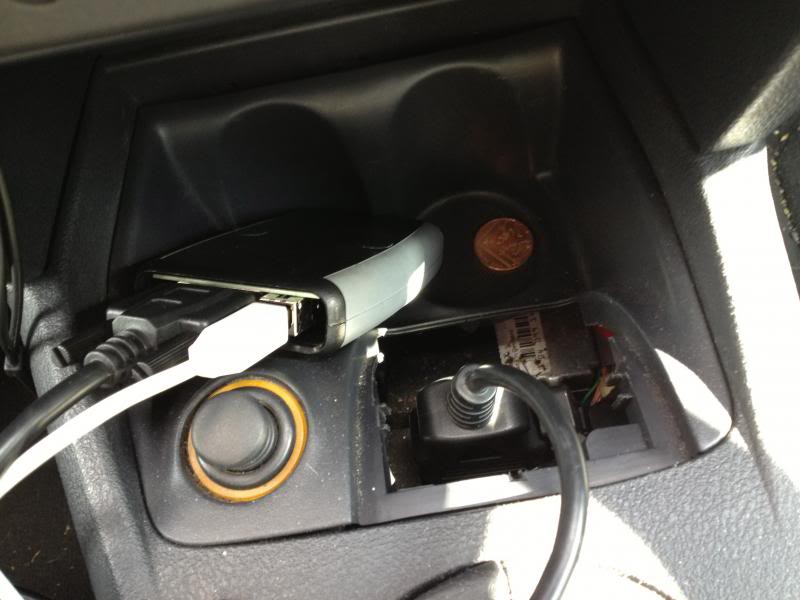

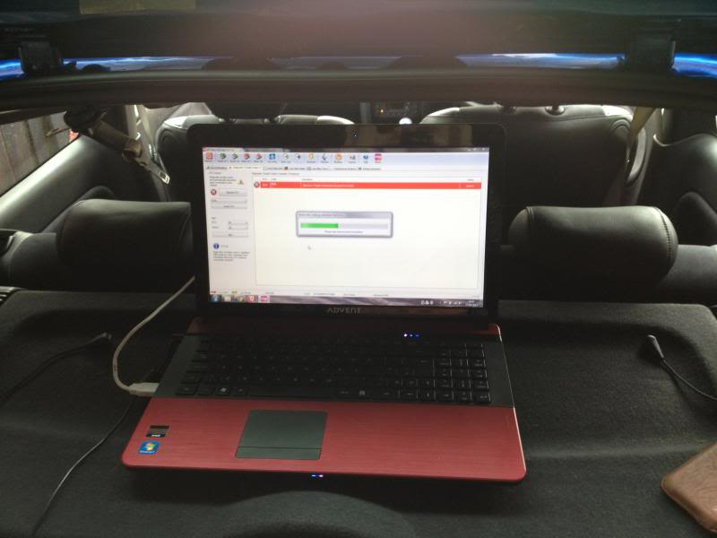

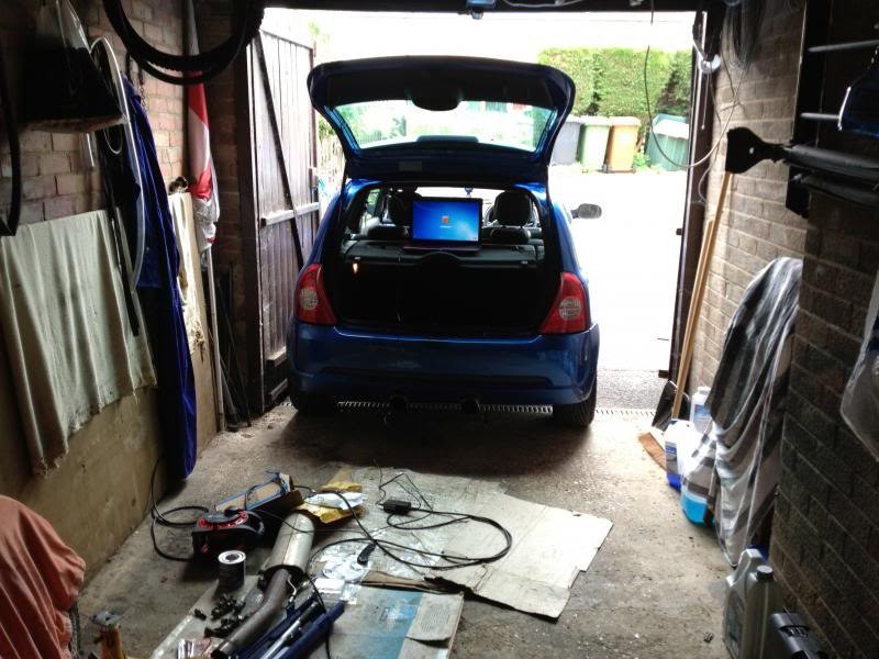

So today I got in from work and finished the RS tuner remap. Henk had sent me the rst and cal files through email as I had problems accessing them through the fastchip site. First I needed to update my ECU as my current version was 8000, the update took it to version 8200 and took around 15 minutes. Next was copying the actual 98ron map over which took about a minute. I was a little hesitant before copying the files over as the RS tuner software pops up all sorts of warnings and scary stuff, but once it's clicked you soon realise that it was a success and there was nothing to worry about.

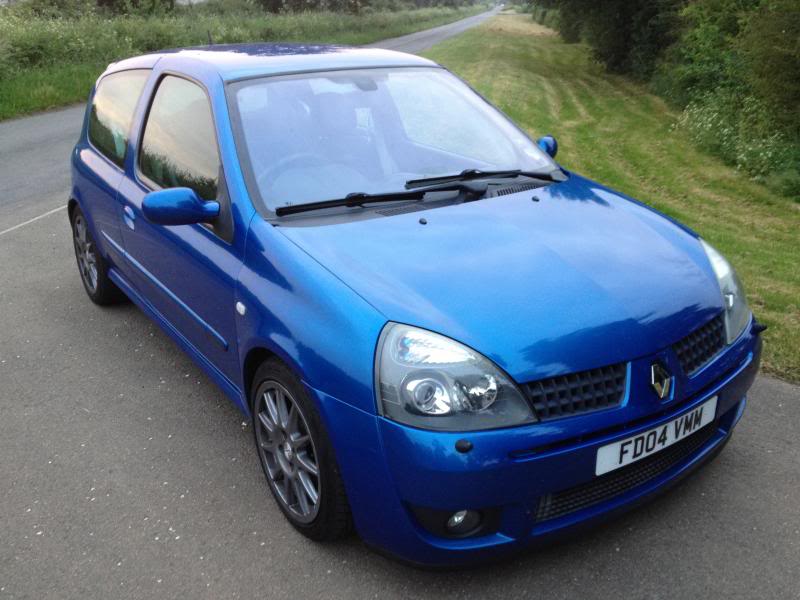

I took the Clio for a little test drive, bare in mind it is currently raining here and in rush hour so I couldn't really test it properly at all. What I will say though is that it is immediately noticeable - as soon as I drove up my road I could feel that little bit of extra low down power. On idle the car feels a lot smoother. I won't comment any more on it until I have had to chance to drive the car properly in some decent weather. Here is a couple pics to accompany my update:

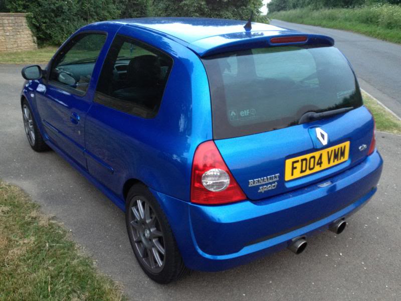

So this weekend I took the Mrs away for the weekend up towards the Lake District. The roads around the lakes are amazing and are such a pleasure to drive. If any of you guys actually live near there I am very jealous that you can drive these whenever you like. All in all I did around 500 miles over the weekend and the Clio didn't miss a beat despite the blinding heat. I was expecting at least something to happen but no, the 182 is a great machine - I'm loving it more than ever!
Also to report a bit more the the RS tuner, awesome, the best word to describe it, truly awesome. The difference is very noticeable and it makes motorway driving a lot more pleasurable. The 5k spike has almost disappeared in 4th and 5th and the lower torque is brilliant. A few pics:

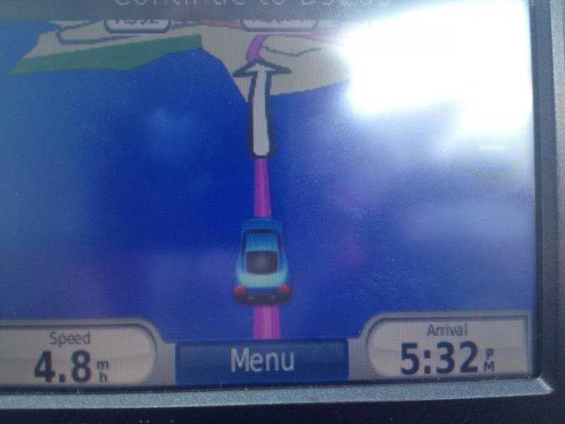

As you may or may not be able to see, we crossed on the ferry over Lake Windemere, a very pleasant little crossing and it made me chuckle when the sat nav clocked the ferry at about 4.5mph haha!

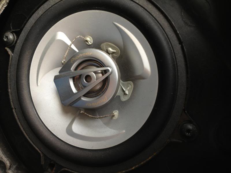

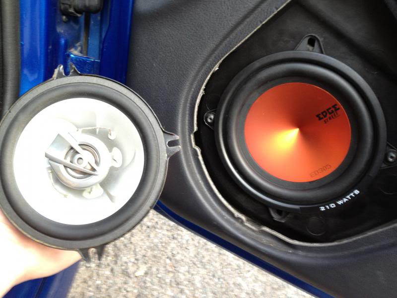

Off came the speaker covers in each door card to reveal the speakers that had been installed by a previous owner - some sort of Pioneer coaxials that sounded dreadful. Coaxials don't fit right with the Clio set up as there are tweeters in the dash.
Out came the Pioneers and in went the Edge ED305s, this job took minutes and the improvement in sound quality was already very noticeable with a little extra better bass as well.

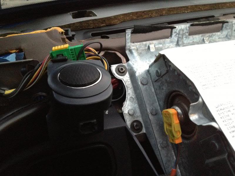

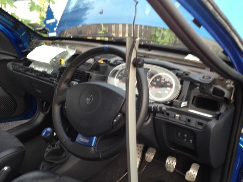

By this time it was about 8.30pm and I knew that I would need to fit the tweeters before I was happy with the job. I quickly got up the guide on here for removing the dash and set about finding and unscrewing all of the screws that were holding the dash on. This probably took about 5-10 minutes and the dash was soon out. I was surprised just how easy this was.
Out came the standard tweeters and I used a stanley knife to widen the holes. After a little bit of cutting the tweeters fitted in the holes nice and snug. I cut off the old connectors and it was a quick job to wire in the new tweeters. Lovely job.
Dash then goes back on and all the screws and trim put back in place just before it starts getting dark.
