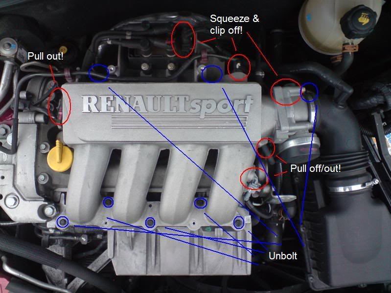

It may be an idea to try d1cky's? He can try yours also both go out on a drive etc.. then see what happens.
Its the one on the left hand side. That says Pull out! If its sough use a little bit of penetrating oil to get it in/out.

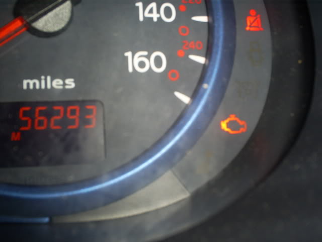

Just went out to get pics.This is the first orange lights that comes on
and this is the second one that comes on sometimes, just directley underneath the fuel light
How is it fixed in place ?
And is it easy to get to ?
AND CAN I BE SWAPED FROM CAR TO CAR WITH NO ISSUES ?
MEANING WILL THERE BE TABS THAT CAN BREAK OFF ETC ON REMOVAL AND RENDERING IT USELESS WHEN FITTING IT BAACK TO MY CAR ?
Ahh :mad: Bloody Caps Lock :(
theres 2 little o rings on them thats the only thing that can split but if you use a little penetrating oil the chances are very slim
can you buy these o ring seperate just in case they split etc ?
And what if i split/damage these o rings and refit it ?
Will it cause issues with running etc ?
Jesus your relentless arnt you!
I have take mine out and in probably about 5ish times with no problem
Itl be fine just pull it gently and twist it as it comes out. little wd40 works wonders.

Just took the car out there and the warning light directly underneath the fuel light came on:evil:
The car then went into what i can only desribe as limp mode, turned it of at the lights and the light went off, the car then revved freely, Im getting soooo pi55ed of with this car now

Hmm thats the electric light. Its probably either the map or lambda I reckon!

the one underneath the fuel light i think is an immobiliser light and the other is an engine management light saying there is a fault somewhere. So i believe but am not a professional though so may well be wrong lol.
Itl be the electronic warning light not the preheater like d1cky said its not a diesel
