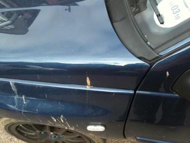

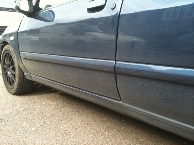

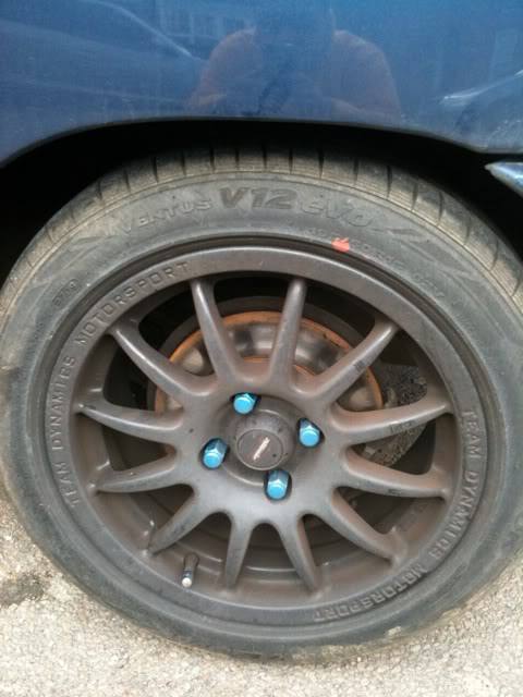

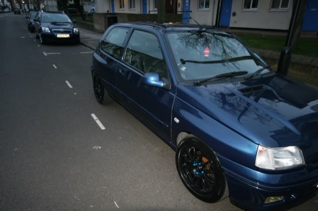

I know most people wont like this but anyways:
Process used was:
APC 10:1 sprayed on the wheels and agitated
HyperWash - then left to dwell for 5 minutes
whilst HyperWash was dwelling wheels cleaned with wash mitt
hyperwash PW'd off and then car shampooed using megs gold class and 2 bucket method.
car then dried off
werkstat prime strong on the body work
left for 20 minutes then acrylicc jett trigger used 3 coats with 1 hour breaks.
apologies only before and after pics and not very good ones at that but after any tips/criticism to improve my technique
Thanks
Jonni

first time ive used it, but my friend uses it quite a bit.
i've just got some dodo juice lime prime off here and some purple haze and will be giving that a try when they come.
was really impressed with the jeffs kit - so easy to apply and take off. i think i left the prime a bit too long to haze over but thats my fault.
clay? no why do i need to?

If you've never done it before, then, yes! You'll be amazed at the difference it makes. When you applied the Jeffs Prime (by hand applicator presumably?!), did you notice it 'dragged' a little?! Maybe a few areas were a bit 'rough' to touch!?
Over the years, 'kack' falls on the car, and, welds itself on! Iron filings, tree sap, rail dust, general fallout etc.. Stuff that will not wash or polish off.
Take a look at the recent Mercedes I blogged: http://www.cliosport.net/forum/showthread.php?t=497665
Only a few years old now, but, the amount of contamination was pretty shocking.
a thought my car was fairly clean an smooth but i clayed it today 4 first time an i was shocked with results the final finish was awesome
