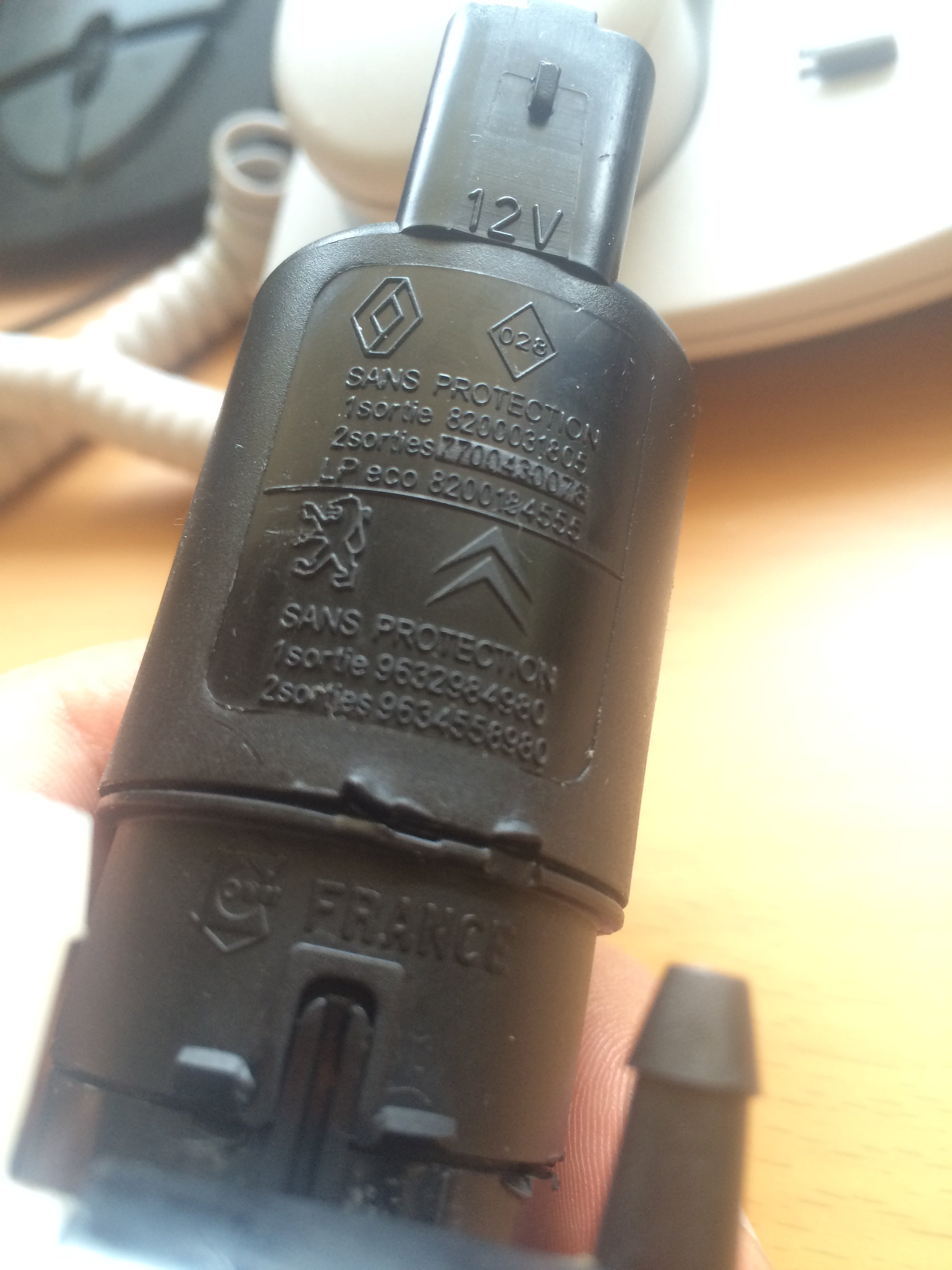

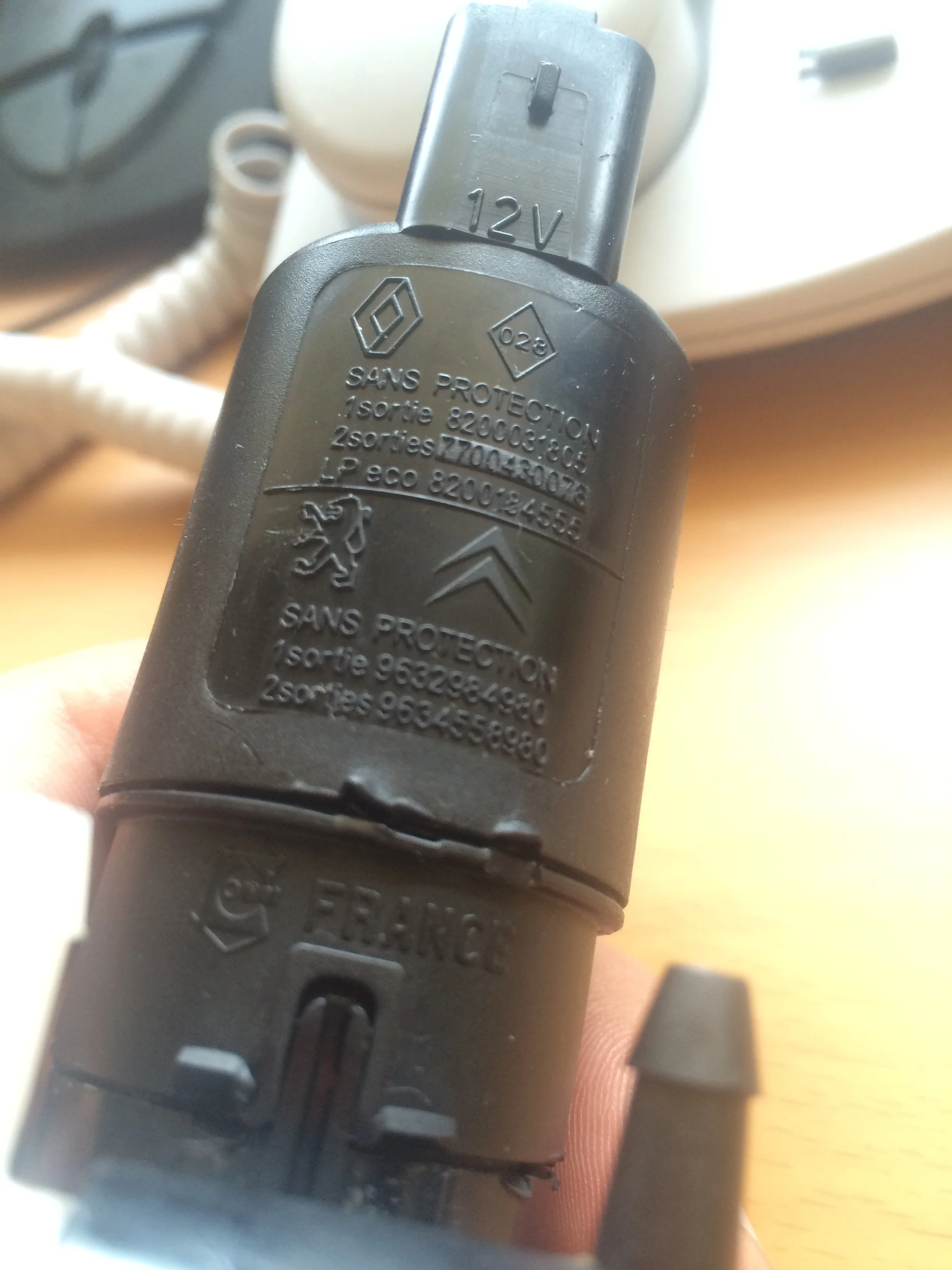

Here's a pic of the part numbers... Hope it helps

There are 2 versions, the 182 needs the one with 2 pumps IIRC.

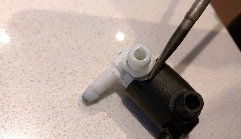

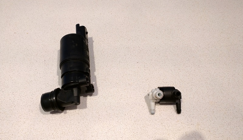

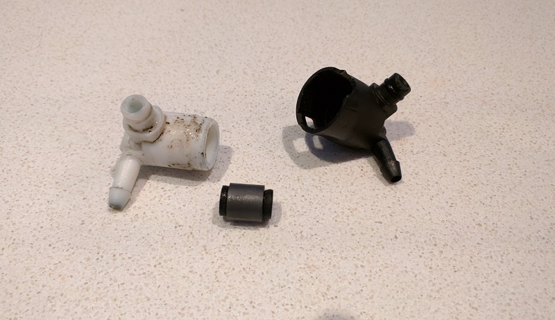

Yeah I had this. When I disconnected the pipe at the bonnet and tried the washer pump its just pulsated / spluttered out.
Once you have the pump off its fairly easy to fix (make sure you have a wiper puller) -
1) Separate the two output nozzles from the pump
2) Separate the two outputs

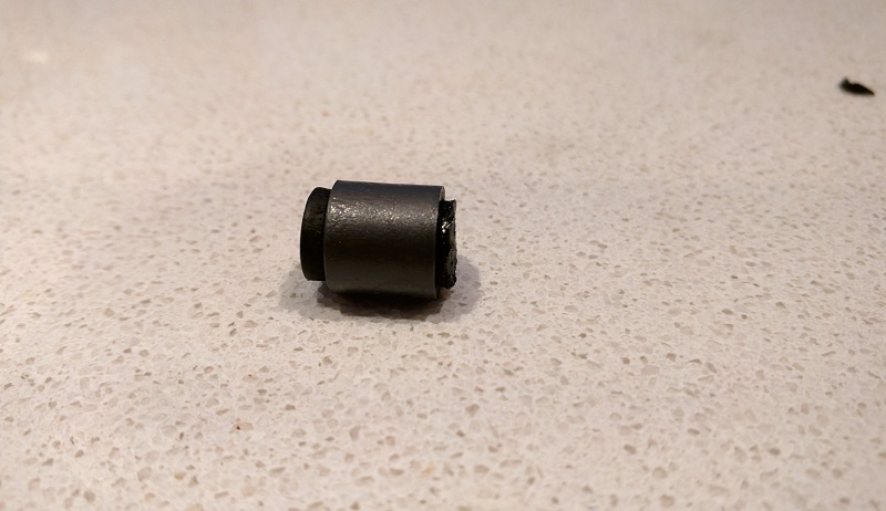

3) Remove the rubber bung (notice how it is swollen on one side)
4) Trim back the rubber with a sharp stanley blade (I probably took off too much but it worked nevertheless)
5) Re-assemble and enjoy (don't forget to put the wiper mechanism on the locating slot on the top of the bulkhead)
did this with mine last year and worked a treat
