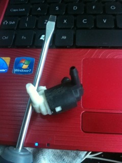

Help please :)
Is this the part I need to take apart and trim?
