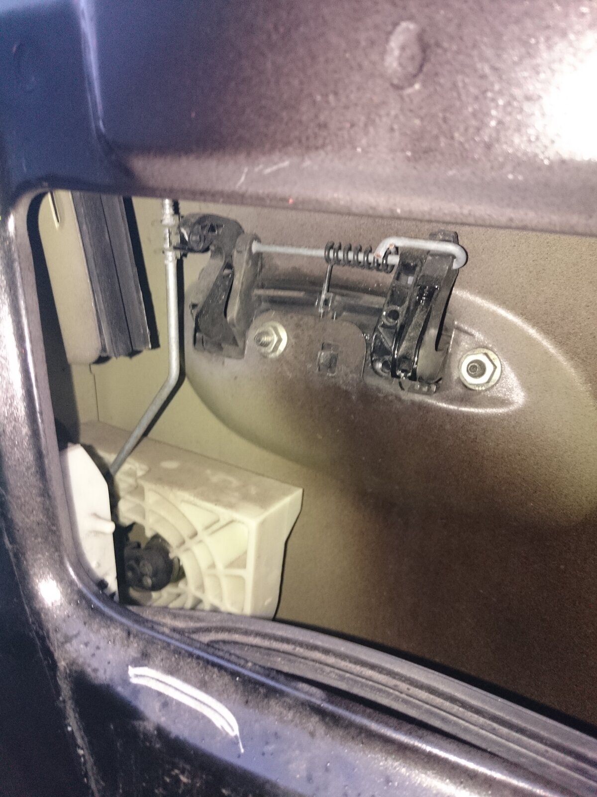

I've had the door cards off the last few days whilst my new speakers came, I've noticed today whilst it was raining and the windows were up a lot of dripping from the bottom of the passenger glass and a smaller amount from the driver side. I know its normal to get some water as it's got the drain holes down there but I wanted to know how much should be dripping if any? I have also noticed when outside the car I can press the bottom of the glass and it moves a bit thanks in advance

I have this on my passenger side, it gets into the speaker connections causing them to corrode. When I hose my car off I can hear it running and dripping inside the door card.
Mine hasn't done that yet, I was thinking about changing the window rubber to see if that helps things
Yeah thanks for that, I wasnt convinced until I ran a hose over it and heard the dripping and water running over the inner door seal

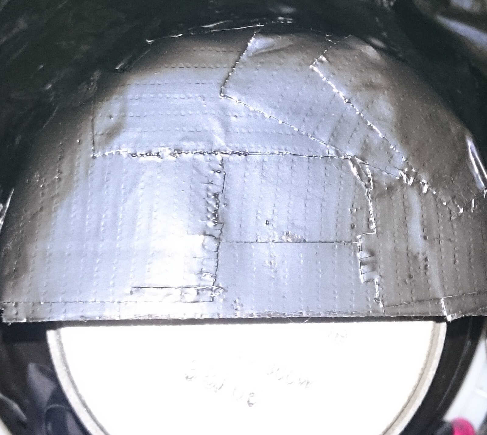

Oh god, I'm going to follow the old sealant to try to avoid this. I've put in 16cm speakers so had to remove the old rain cover so I made a new one to cover the speaker a lot better
That's what I did too.
What are the rain covers like as i havent got any?
