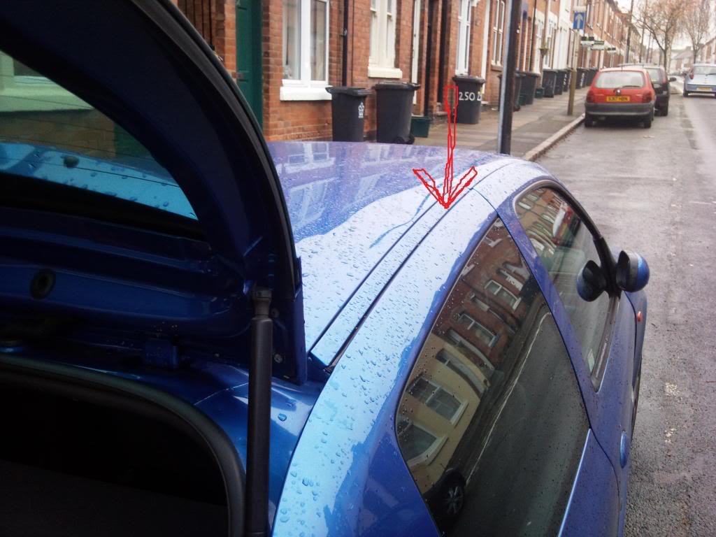

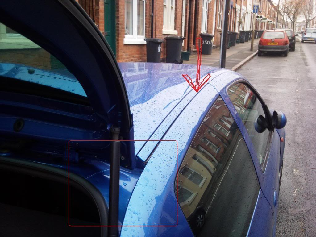

There is a very small dent on the edge of the roof, do you think it could be getting in here and working its way into the foot well?

Do you think there is any possibility it is connected to the small dent in the roof? I know it sounds stupid as it is very small, but where it is I could see it causing some sort of seal being broken and it right above the general areal the water seems to be coming from!
Also would it be possible for the water to come in somewhere under on the side of the car, but only as a result of driving in very wet weather? Think i have heard this mentioned before in other threads, bolt whole or something?

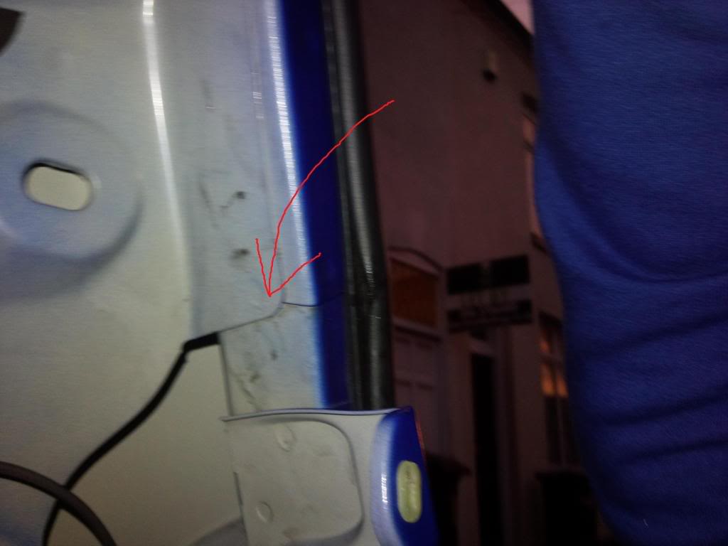

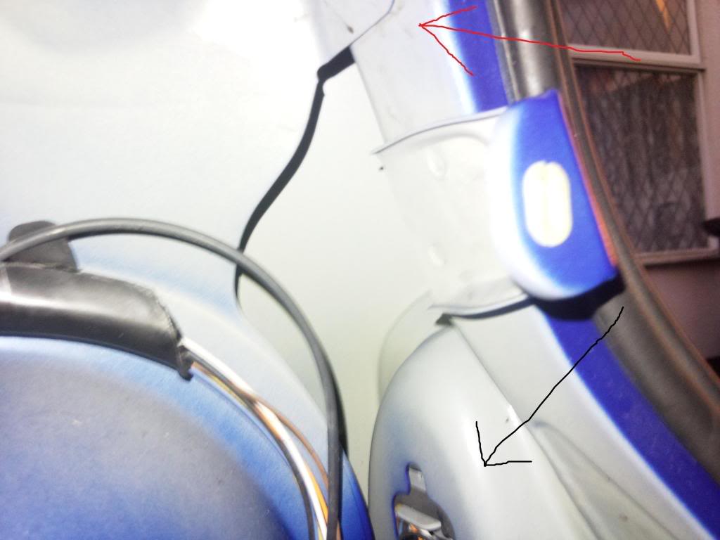

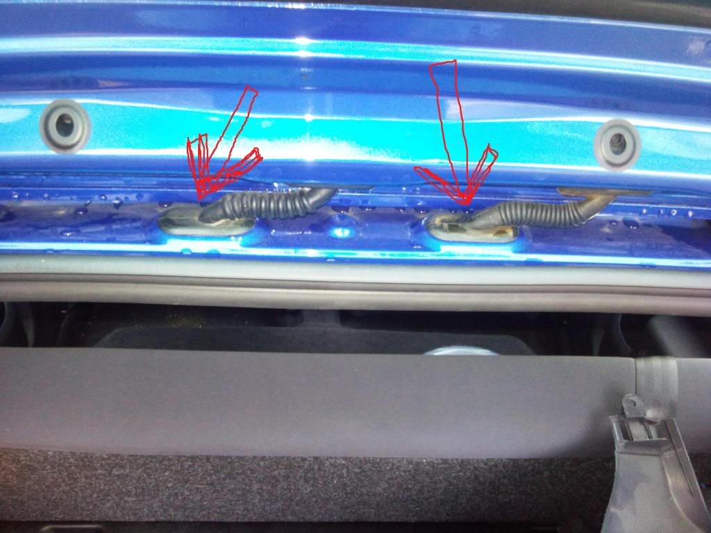

Re: Water leak again!!! (just added pics, help needed!)
K guys i have had some of the boot interior out to find this leak and have traced it to where there is a metal sheet join, just above the light cluster. (see pics). The red arrows are where its leaking from and the black is where the light cluster is, to give a bit of a refrence point.
Problem is I can't work out where it is coming from above this point or how its getting into the car.
Any help with where the water might be getting into the car would be great as its really pissing me off.

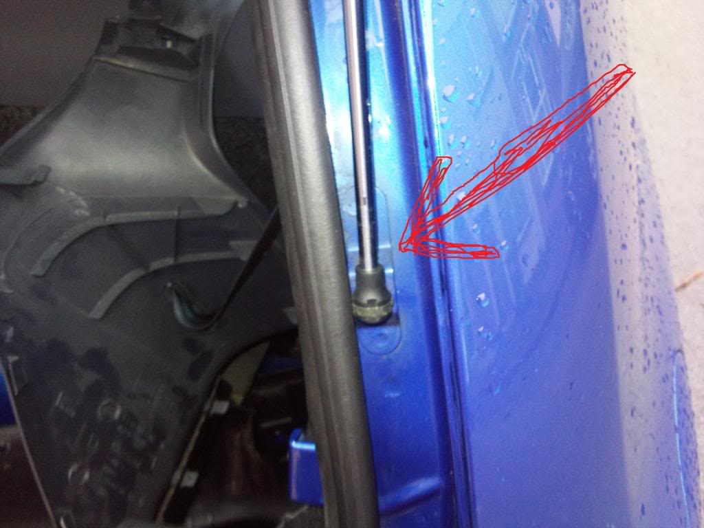

Check the plastic circles that are the bump stop things for the boot, take them out, bit of silicone = Done!
Bet there leaking from the same place mine were
I have done that already, but thanks. The leak is coming from somewhere above them!
_WILL_
  172 Cup
yeah think i might have to, but i'm pretty sure the join in the sheets of metal is where it is entering the boot, problem is i can't find where it comes from before that, or how it gets into the car, plus i don't wanna seal it til i know where its coming into the car in case it just pools somewhere else in the car that I don't know about.

Is this the plastic strip? I can get it to move about a bit but i can't get it off!
The other places it looks like it could be leaking from?
or (but i think its unlikely as i don't think there is actually a hole here!!)

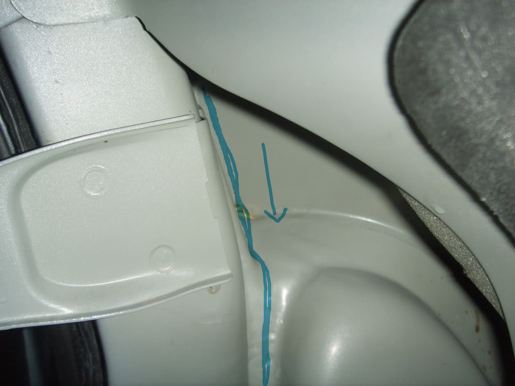

The water is def coming into the boot at the join (see below), so its just a case of finding how its getting there. Would it be possible for the water to get in at one of the points shown above and make its way to the boot through the join below?

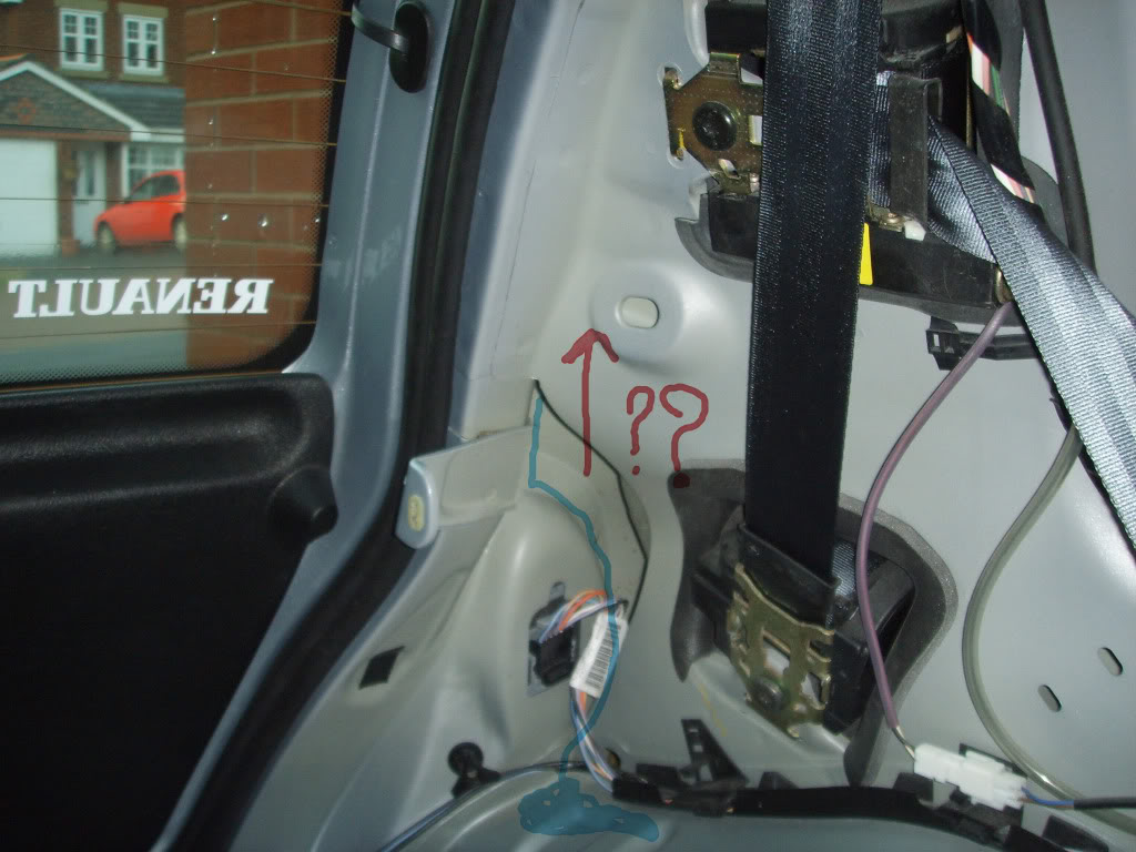

Haha, yeah i know what you mean, i got my hand pretty stuck last night trying to find out where the f**k that went.

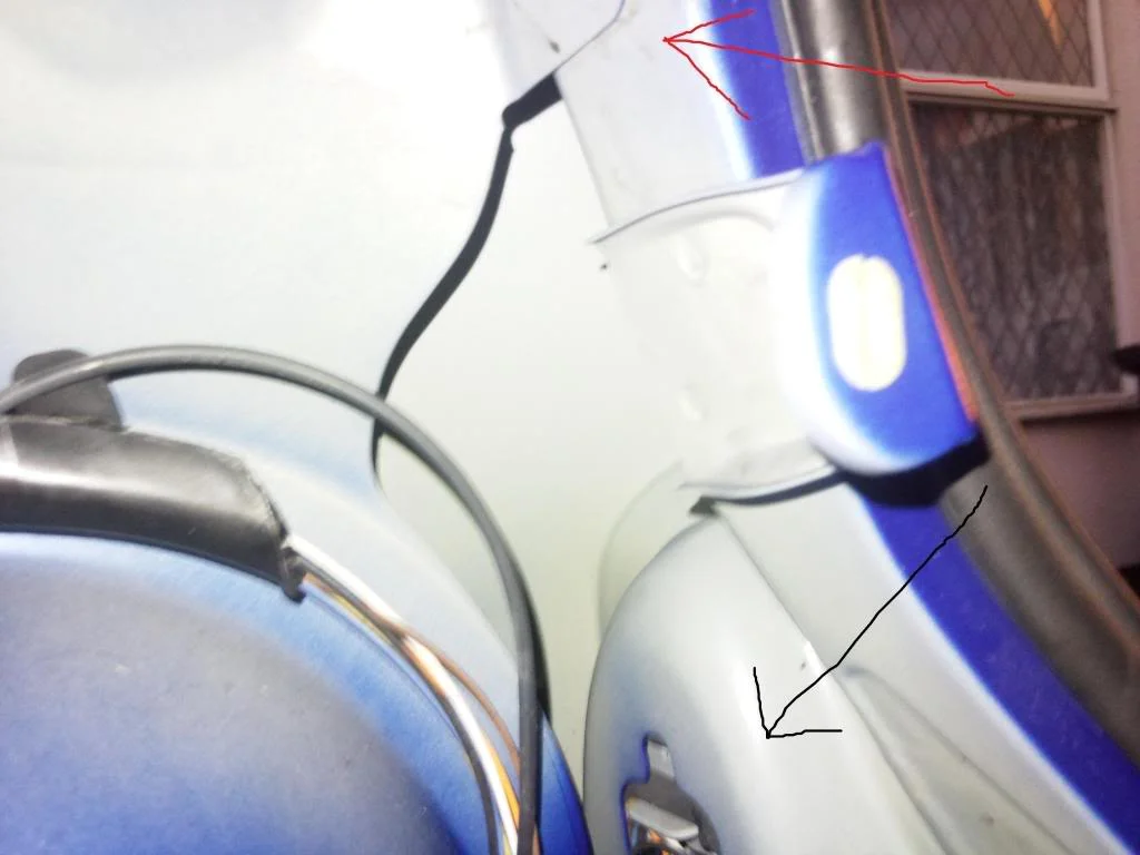

Are you sure it id def coming from up there cos thats where i thought mine was leaking but it was actually coming from the join next to it! (the join is in the very top left of your 1st photo, it looks like there is a small run of water coming from it as well??)
ps. your photos and arrows are way better than mine:eek:

yeh the mark looks like a water trace but annoyingly its in the paint, you might be right though about it being the join though I've never caught it in the act yet, when I put my hand up it was wet but the more I've looked into I think thats just condensation as the roof is like it which you would expect in this weather.
My next job then is to whip the seam sealer out of the shed and seal all those seams.
Incidentally on my old williams it was in a very similar place where one panel meets another, I just can't believe that it might the same place on two different cars!

I thought it was coming from up there as well because it was wet, but there was a bit of sponge in the gap that absorbed the water, so once i took that out it was easier to find the actual leak (if that makes sense?)
Im worried bout sealing it until i find the source as i don't want it pooling somewhere else!!
