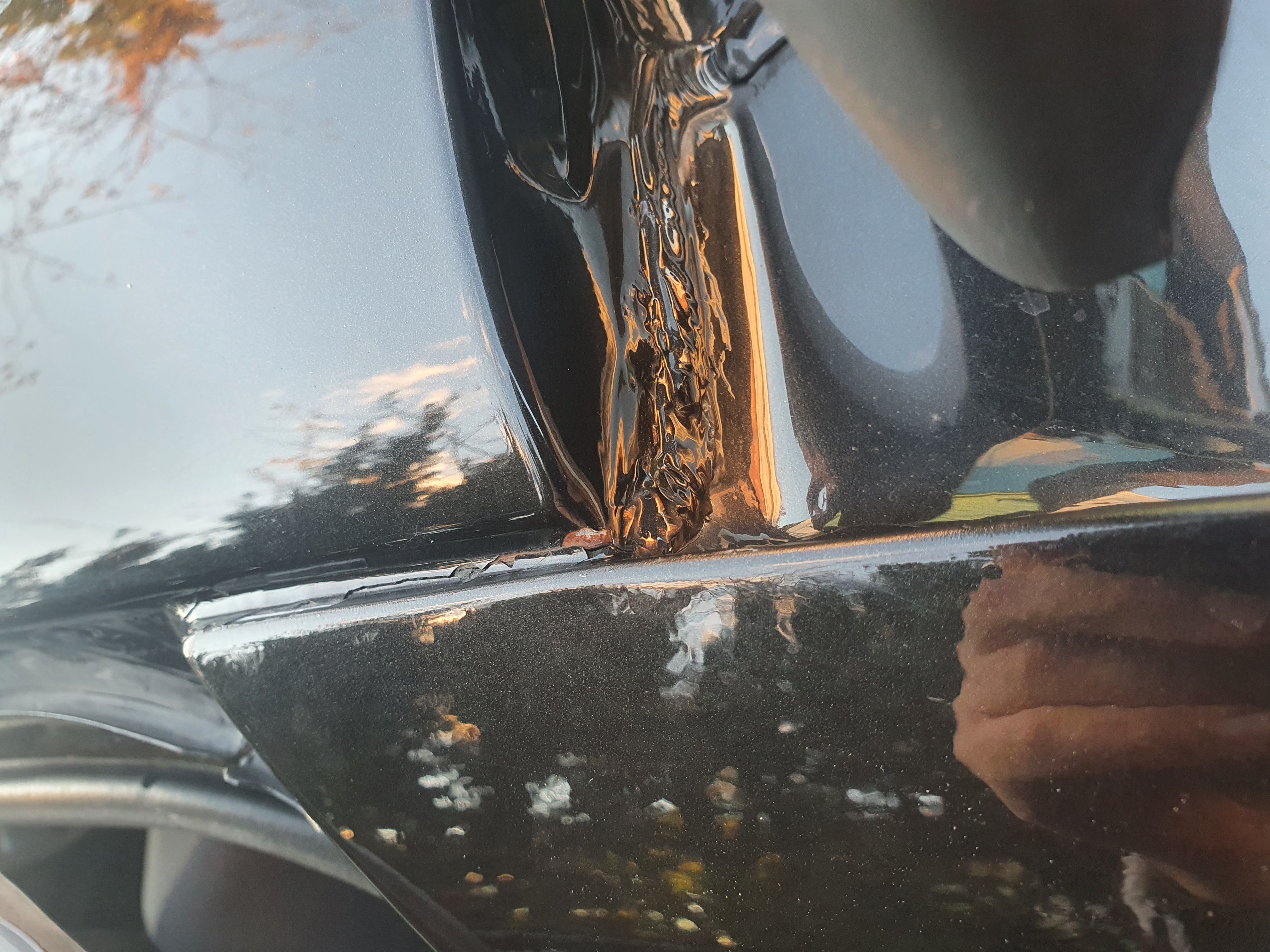

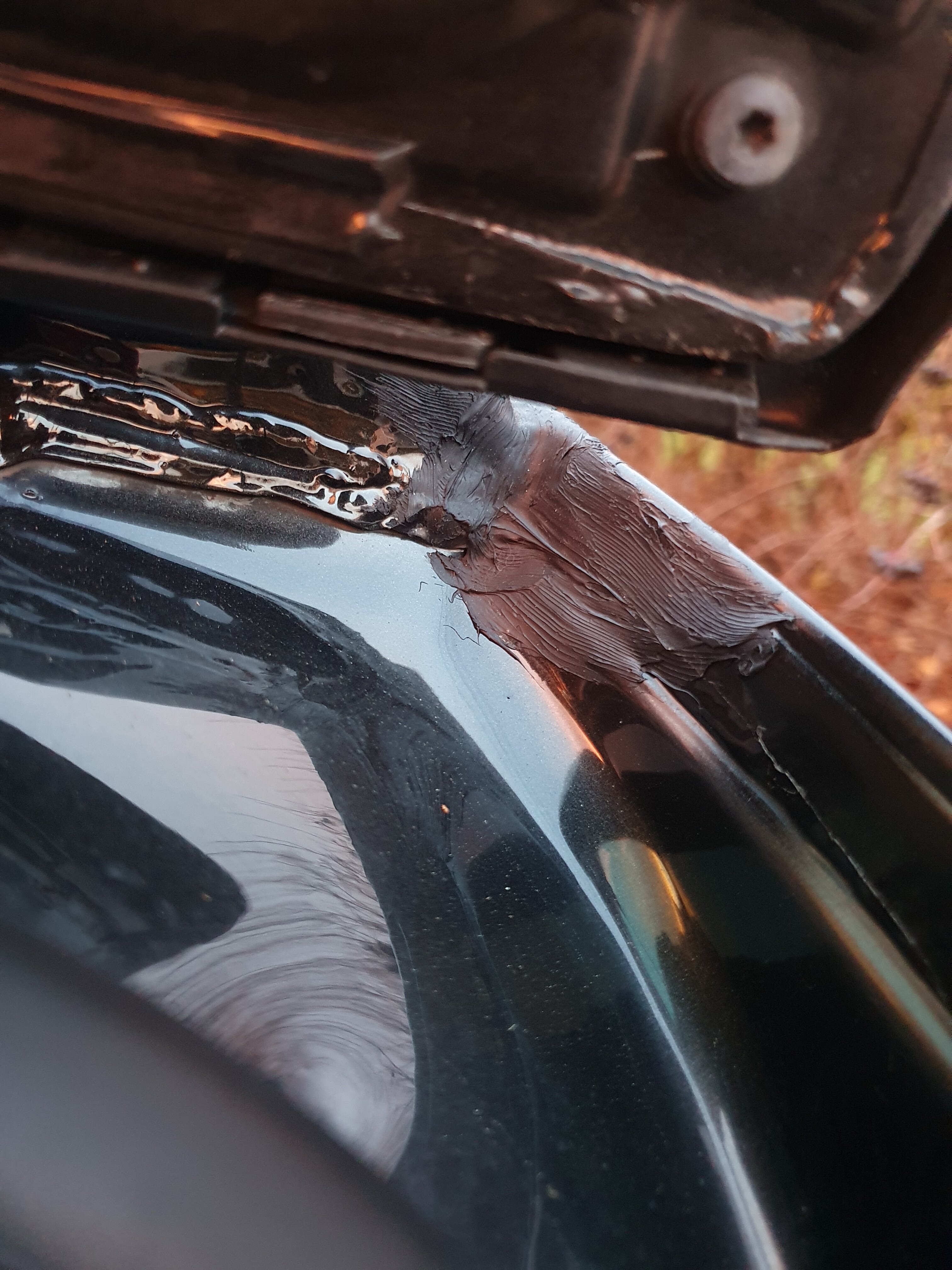

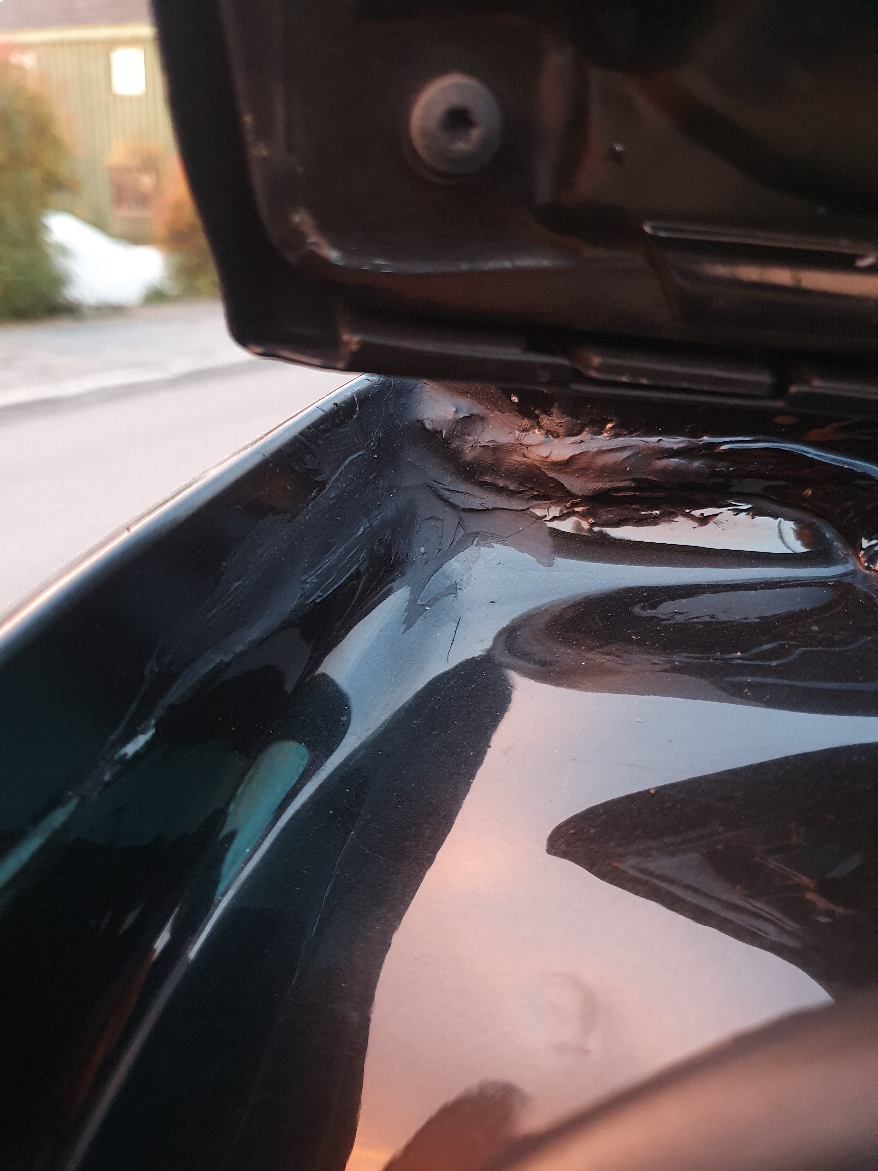

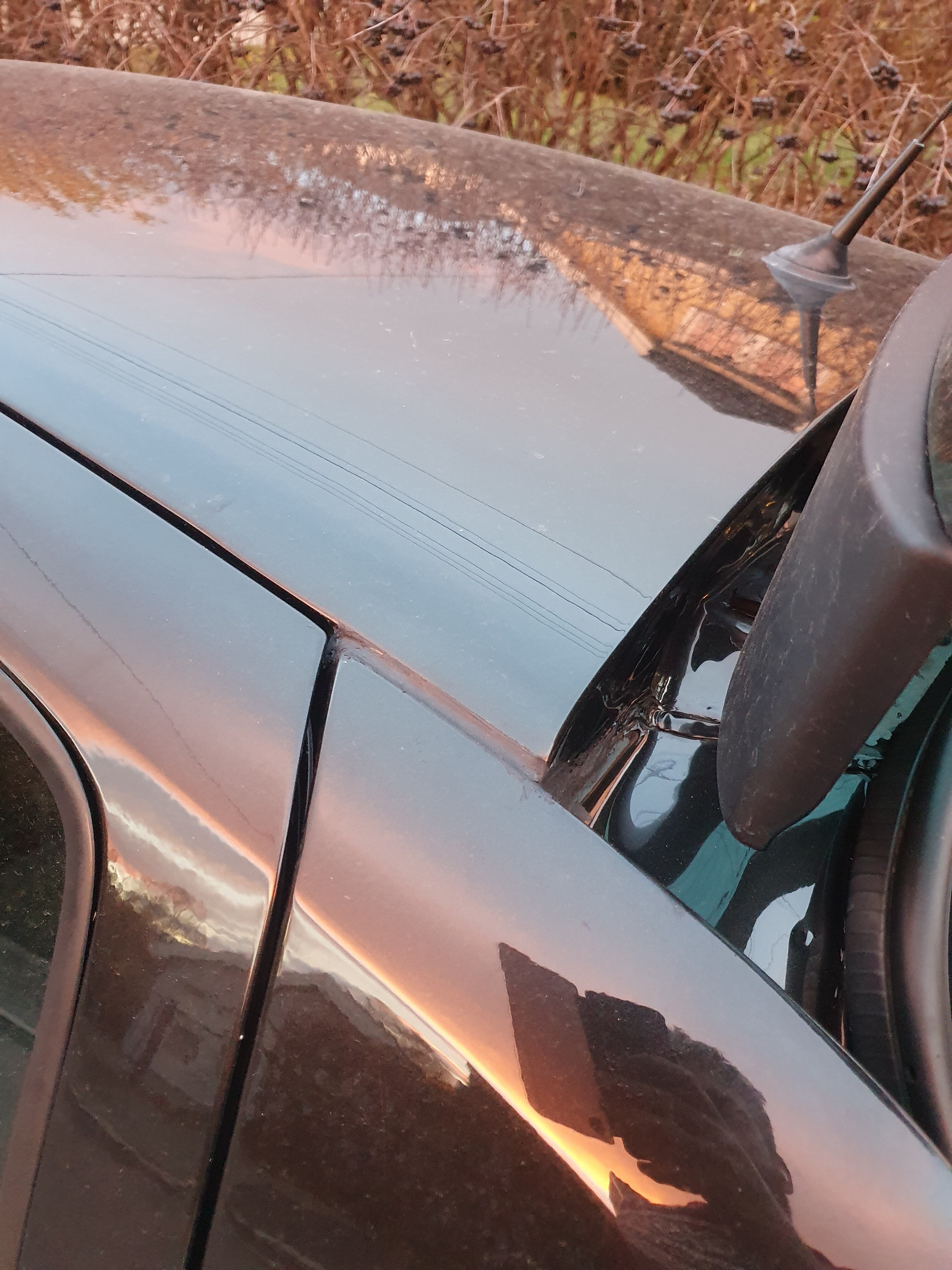

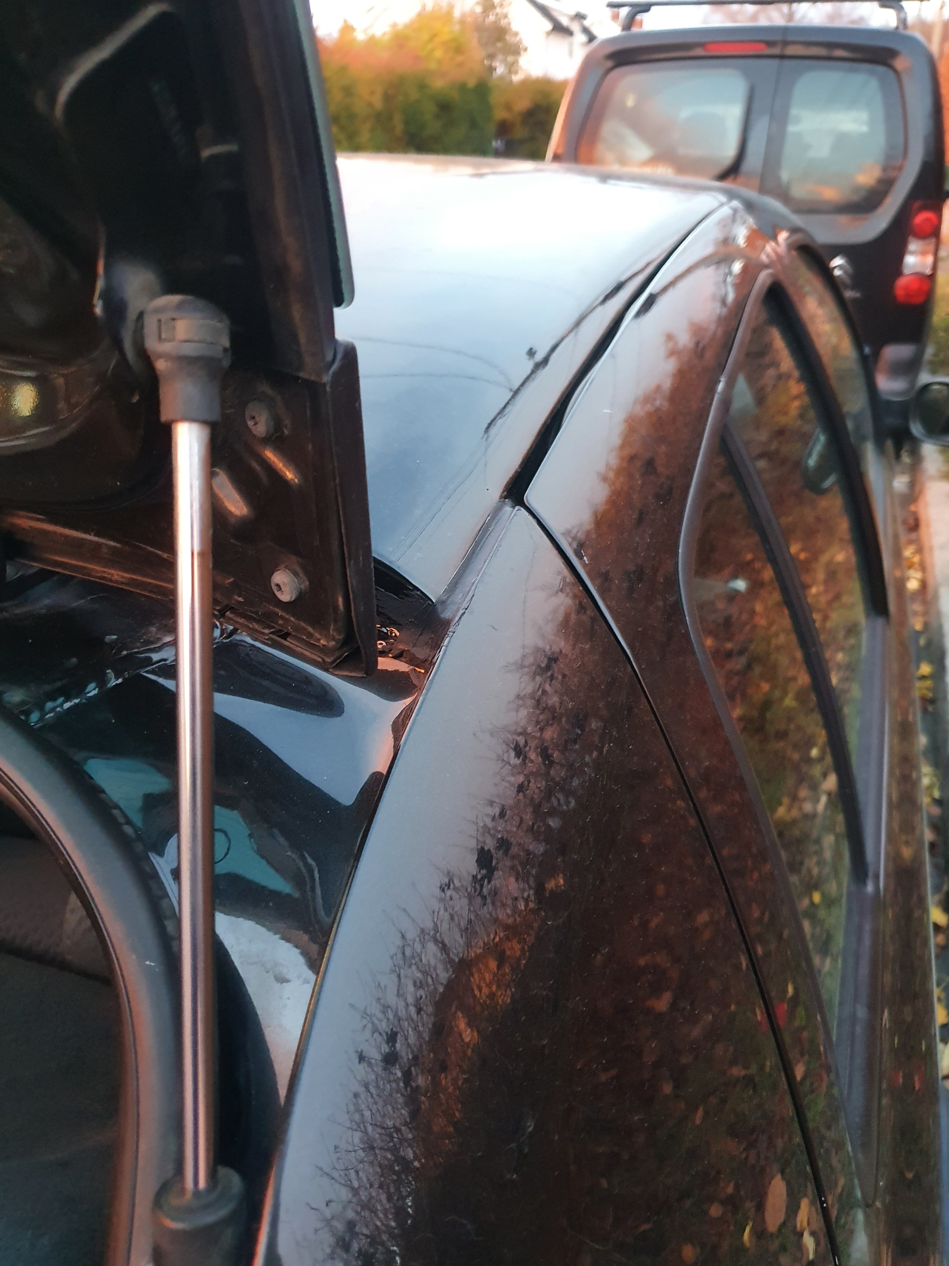

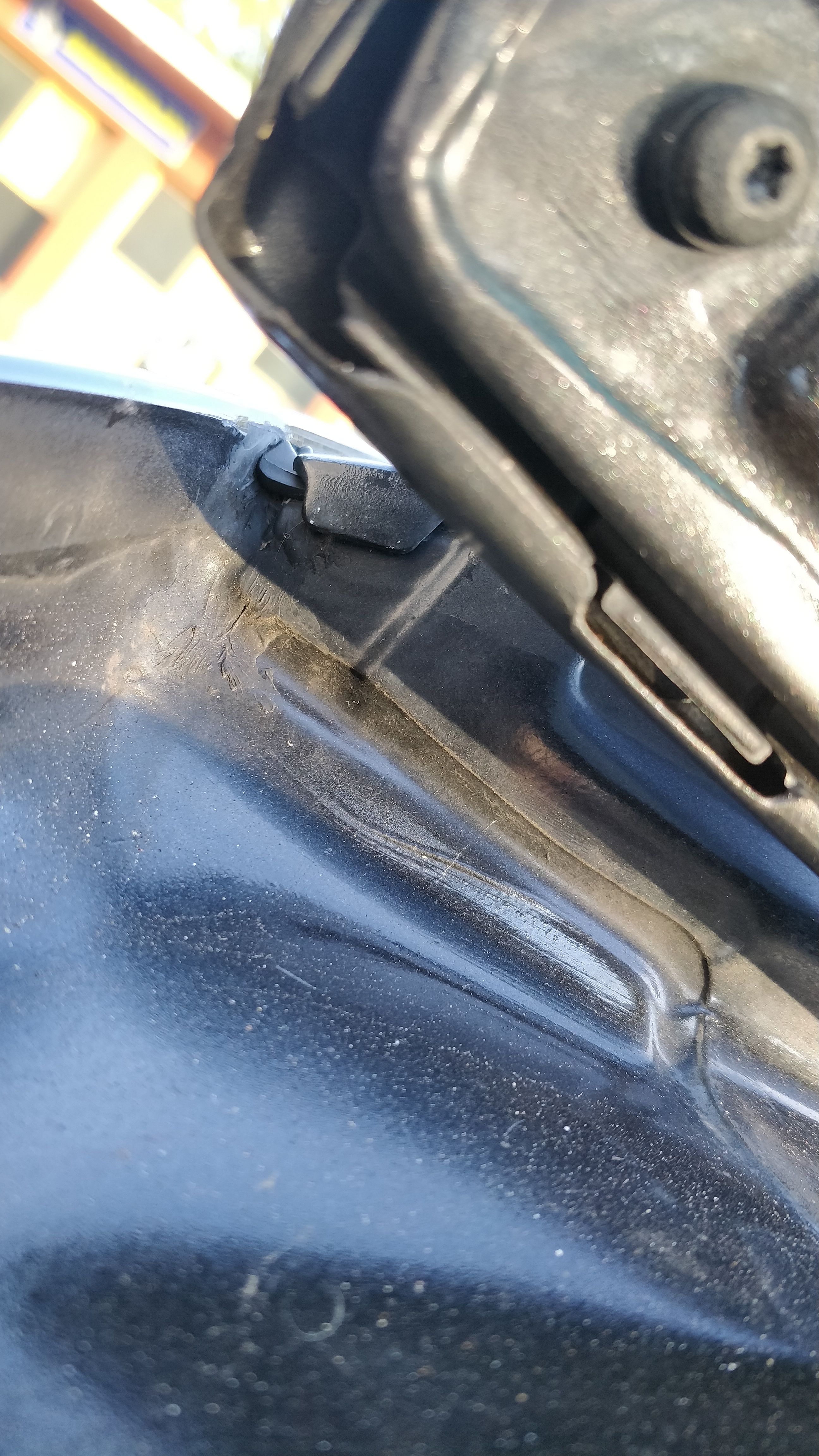

I think i found mine
Crack in the paint (and?) weld, between roof and pilar on both sides.
Filled it with tec7 and it seems like it works!

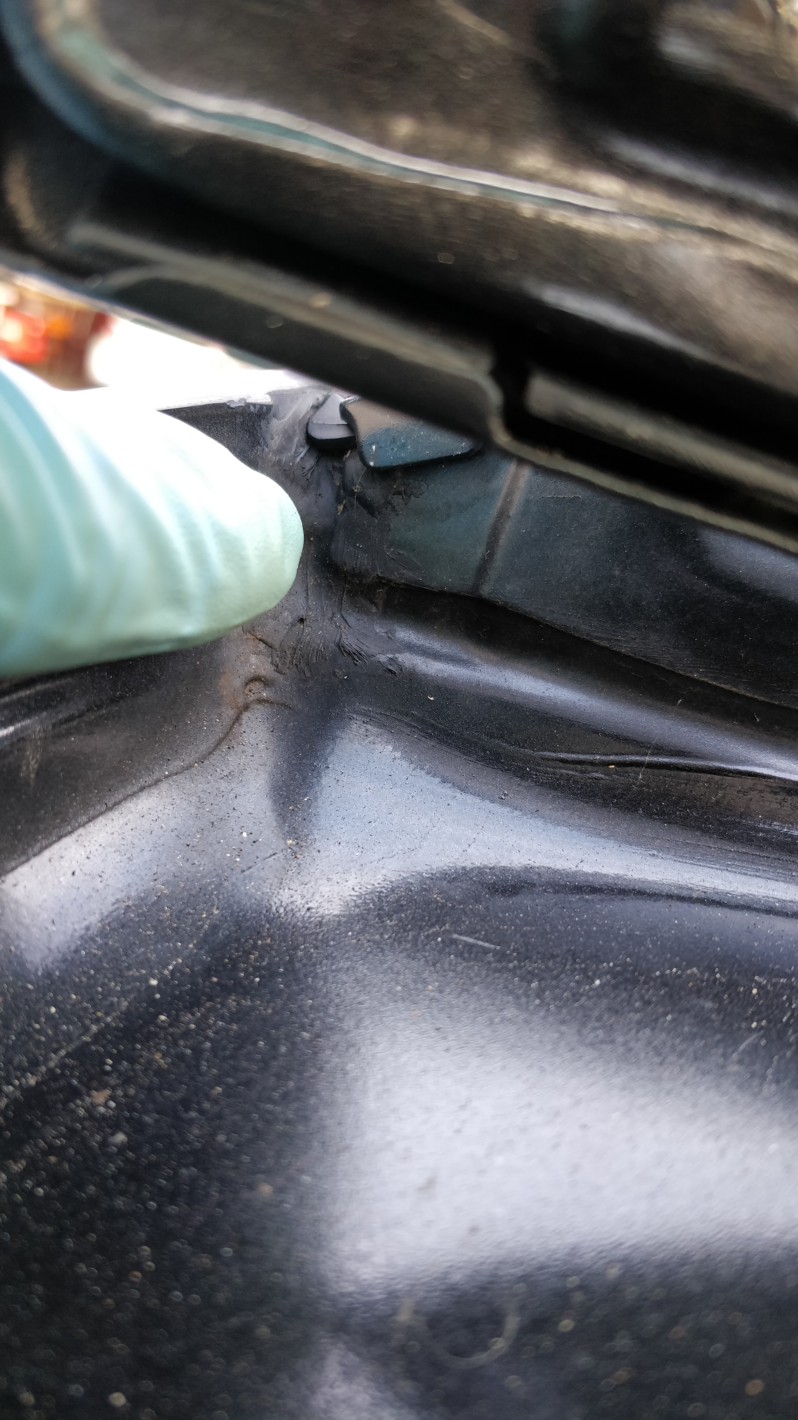

Okay, so i found this by pure luck. It was a small hole in sealer and had to look very hard to find it. It is on a join between roof and side panel, right below the plastic trim on the roof.
Took a screwdriver and made the hole bigger and put some silicone in it.

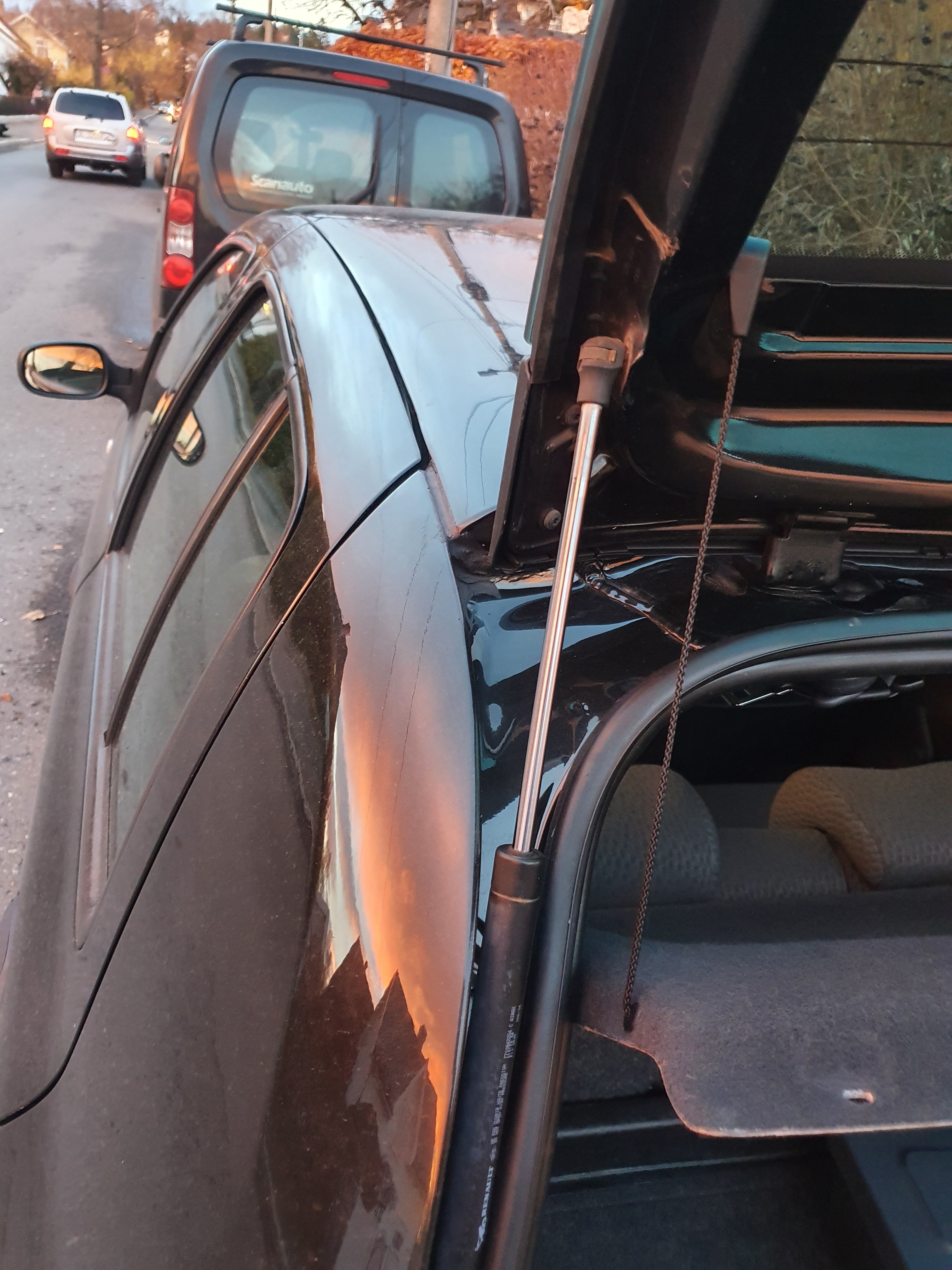

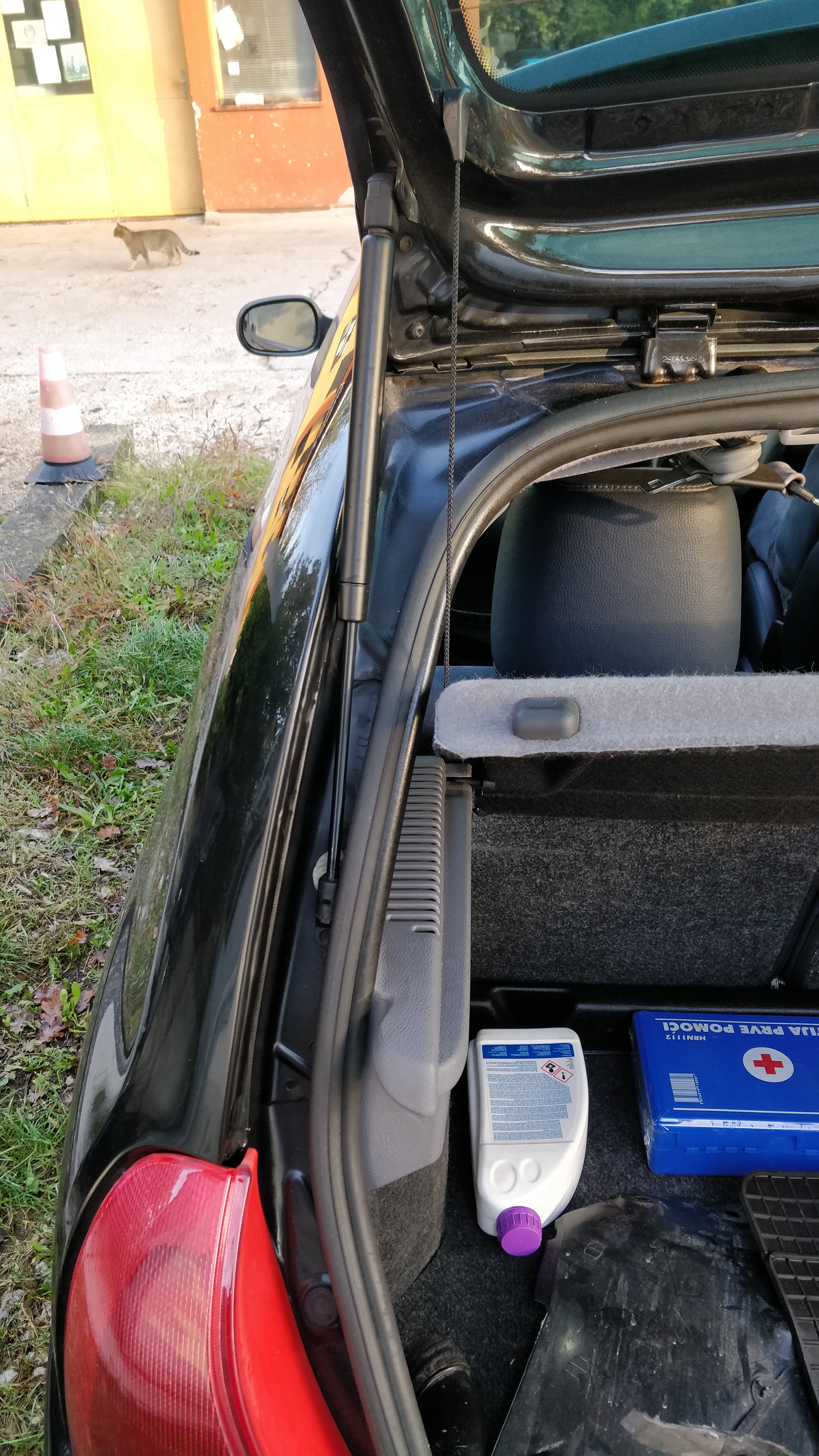

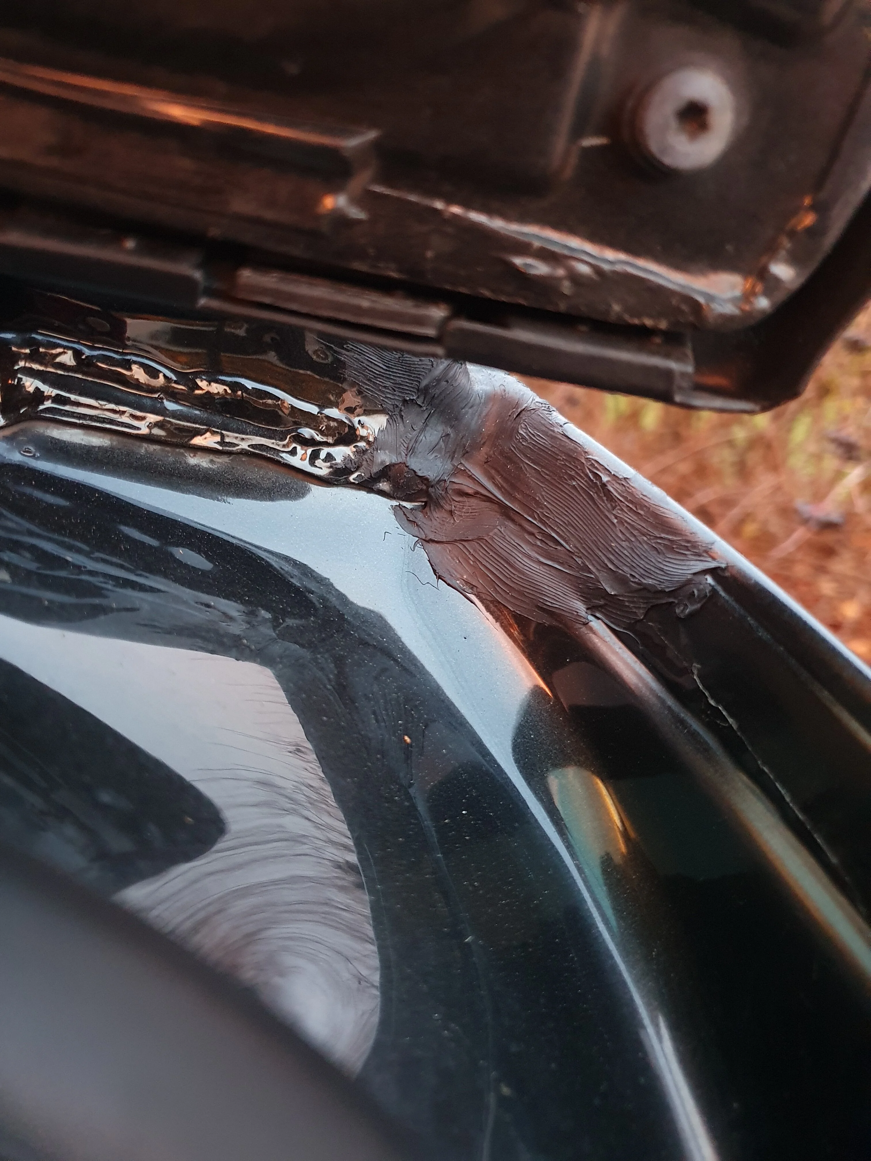

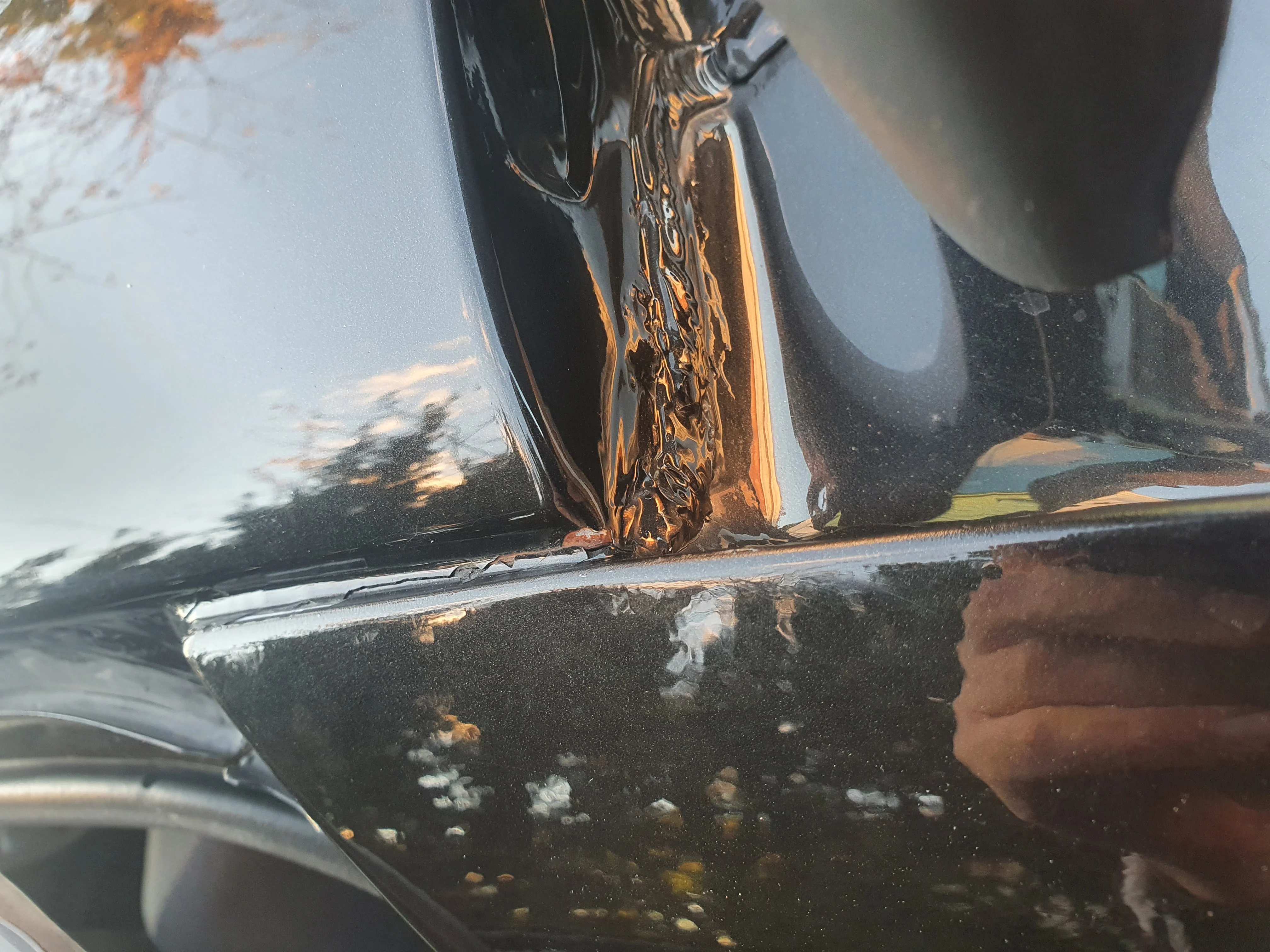

More pictures of the repair that seems to work i

Ahhh thank you, I see now why I got confused, you've got a five door!
Got it now, I have a hairline crack in the exact same place. As you say, bit of silicone and all fixed.
Just stumbled across this thread after I fixed the same problem, exact same drip path and the exact same fix. Here's hoping it works. Top job lads
