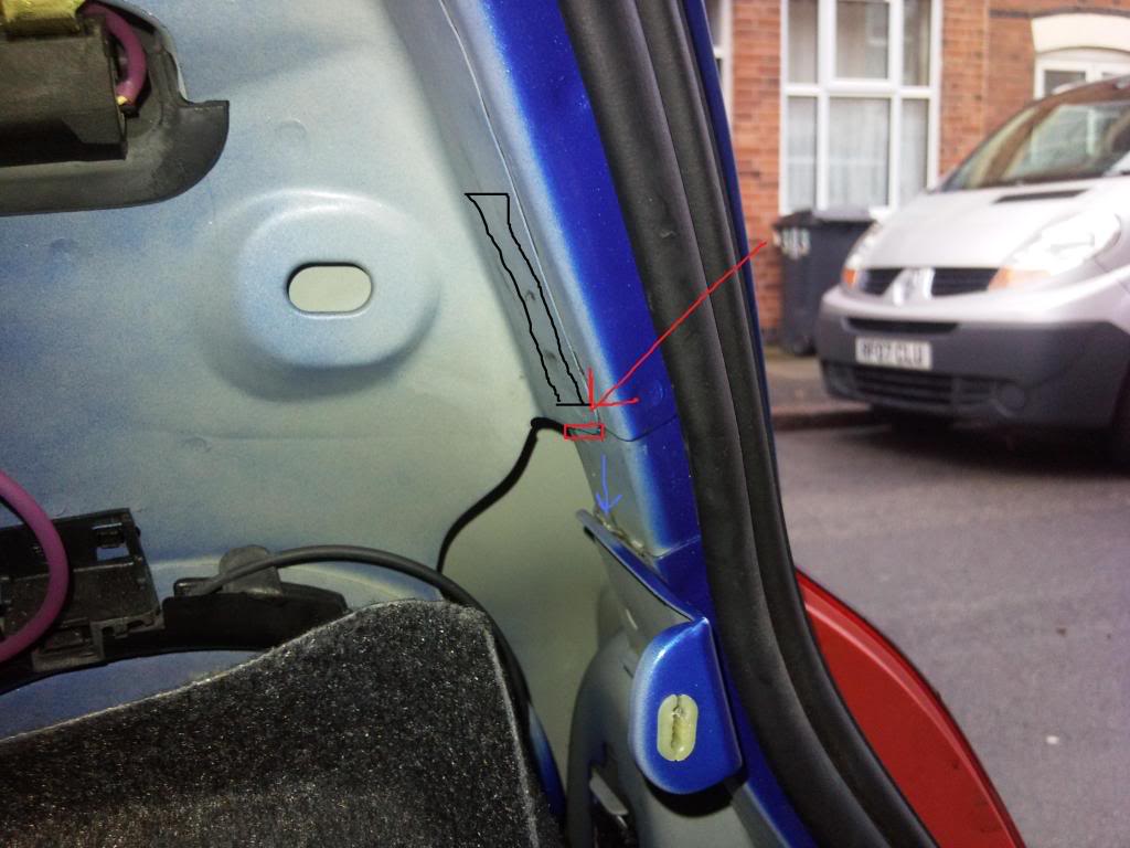

right your 100 percent sure its runnning down that inside bit?
Yeah, my mate sat in the car today and i poured water on diffrent parts. It made it leak but it wasn't obvious which bit it was leaking from. I can't see anywhere.
The red spare it where the water beads and then drips. The black square is highlighting the panel its coming from under. There is no water in the the boot at any point higher up than the red box.

right had a clio in for water leak today so had a detailed look. its not coming in the boot strut mounting point i would have said its likely to be higher up. when you get you mate in the boot again. tape off the top corner of the boot it seems most of the panels connect here. i will try and get some photos tomorro of what im on about. and i will look on the computer at work to see if it says anything about the panels. pity you dint have compressed air cos that would have been another good test

Photos would be amazing, what do you mean the top corner. Do you mean the bit in the red box that you drew earlier in the thread (not the one i drew).
lemonnobby
yea the one i drew mate. what you need to you if you can get air with a nozzle type attachment on it have someone inside and blow over the roof with the boot shut they may here the air sound change where the hole is that may lead you in a better direction

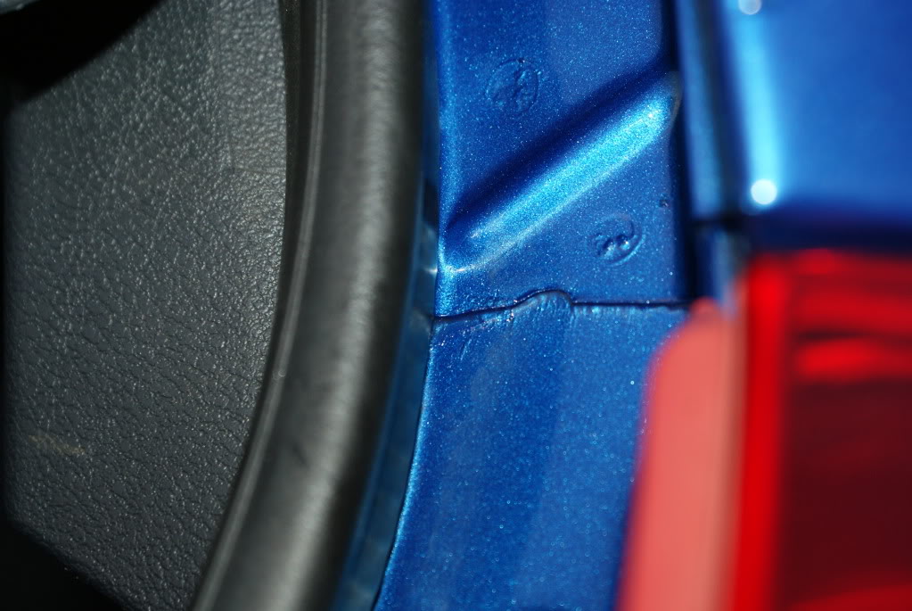

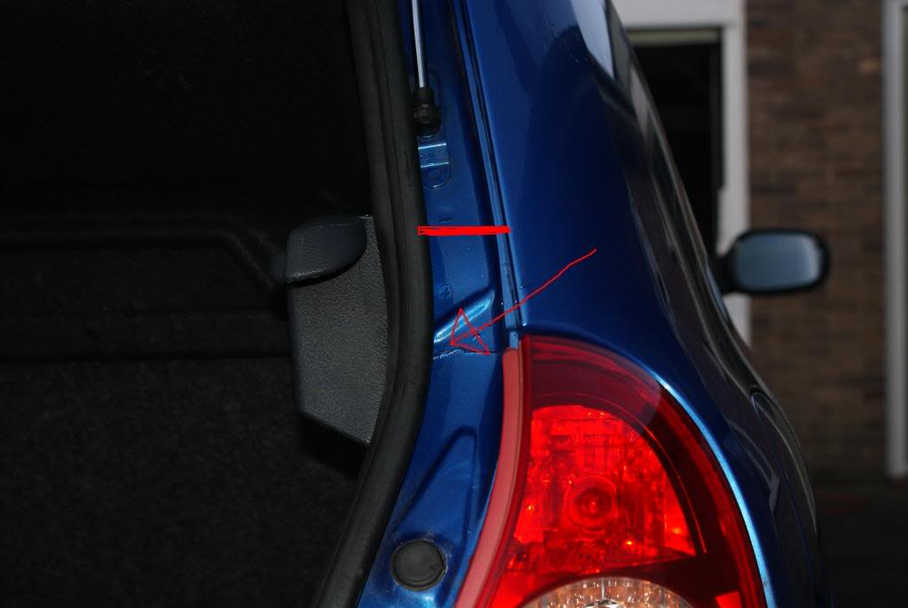

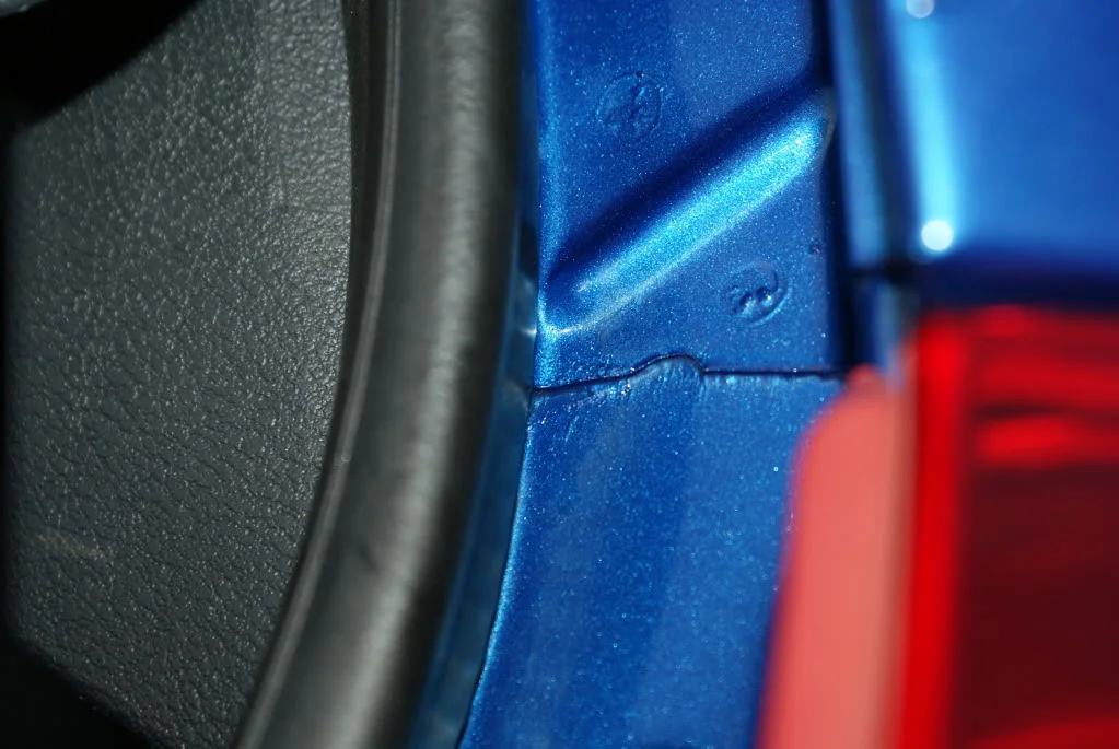

Okay this is a pic of the seal that is definatly broken and where air leaks out when i use the air hose so i have no sealed it up and im going to give it a couple of days and see how it does!!
The arrow is where i have seales up, but the red line is approx the height the water is leaking into the boot. This seems abit strange to me but I am going to hope its worked.

Sorry i havent got back to you mate. there is another join which is hard to see just above that boot strut mount check that on too. that close up pic it does not look normal. it may be some sort of calpillerly action but i dont think that panle goes up that high
Not quite sure where you mean man, is there something wrong with the positioning of the panels on my car?:S
Not exactly sure what you mean by the boot strut mount? Is the thing that holds the boot open?
