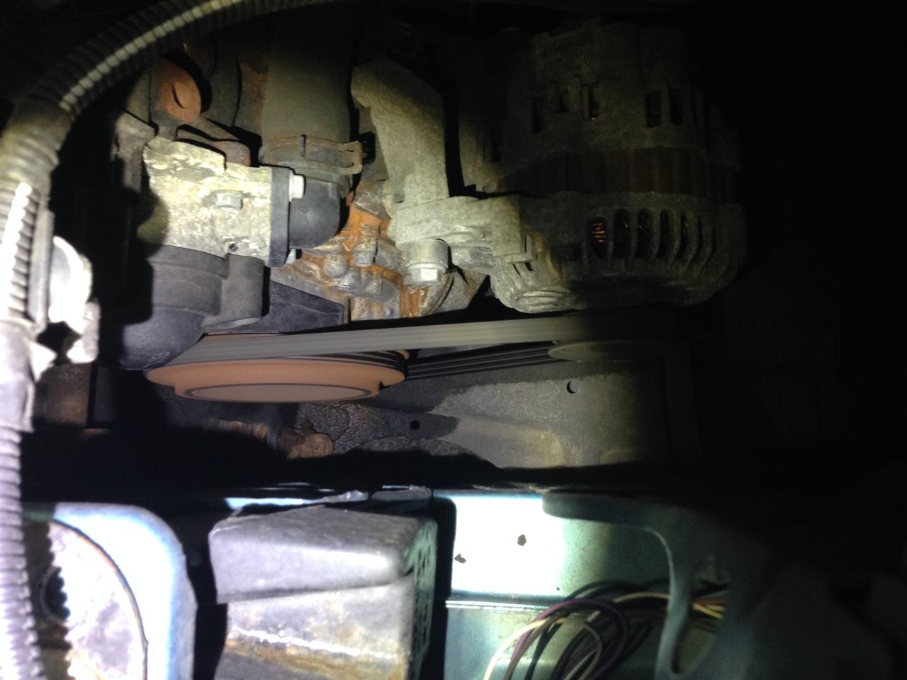

Water leak, think its the water pump? Iv got a picture of the leak
  Renault Clio 1.2 16v
Hey all iv got a 2003 clio dynamique 16v. Not had it long and the car has low mielage, (45k) Noticed that it was losing coolant slowly but surely. Think i have located it at the waterpump.
YOu can see the water goes in a line under the belt. Is this my water pump?

Dayum. Is it worth changing the cam belt while im at it? Is it a lot extra labour?

I would yes and 100% use a good water pump. We do pump and belts for £240inc vat using genuine parts.

$1500 for the timing belt kit fitted, and replace the driven belts only at our local dealer in Cairns.Paid that two years ago. Now that she needs a water pump he will get no more of my hard earned and i will do it myself.
