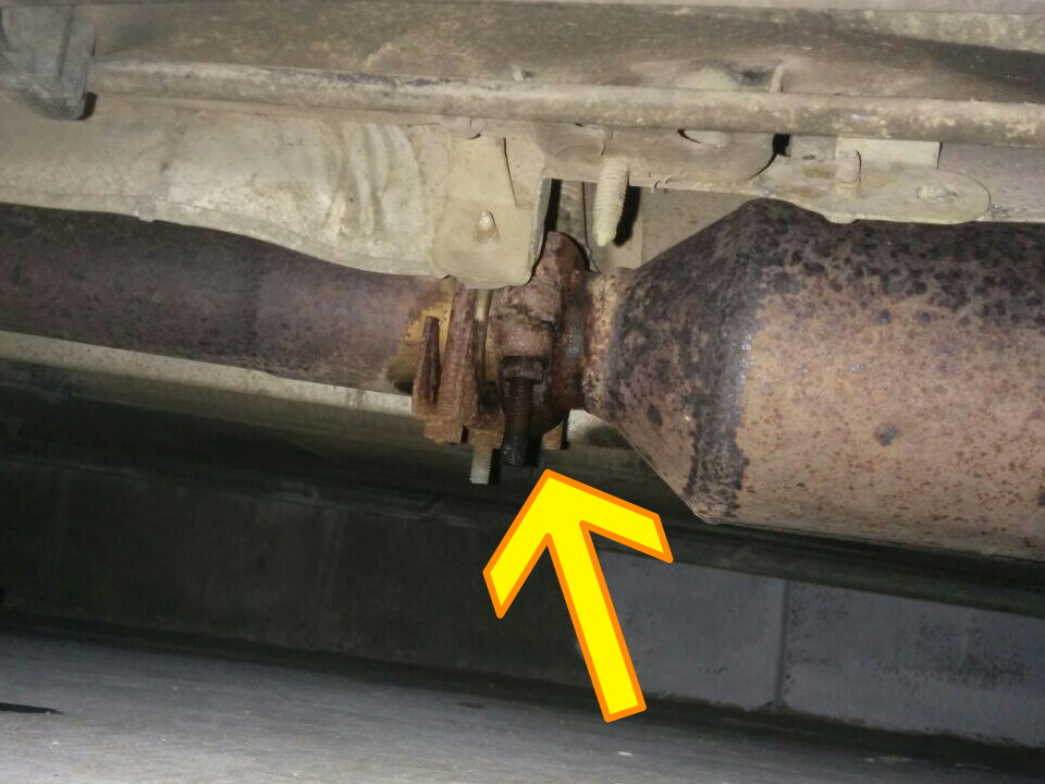

Water leaking from rear end of cat. Blowing exhaust.
After jacking the car up a few times fiddling with new alloys, I drove the car up and down the street, not even 1/4 mile. Wouldn't have even warmed up.
When I got out of the car I could hear the exhaust blowing in center section.
Got down to have a look and not only was it blowing by the cat but a puddle of water about an inch or so had formed under where its Blowing. I'd only been parked there for about 30 seconds.
Water looked pretty clear, a little dirty/sooty.
Would this mean I have a shot cat or sonething worse? Or is it normal for a cat to produce this much water and that it's just cos there's a hole there now that the waters I never normally would see is escaping?
See attached picture. You can see near the clamp the darker patch is where the water was coming from.
Ran out of time tonight to Jack car up to inspect closer. Is it a new joint required in the center to cure the blowing?
Coolant is fine on the level and no warning lights.
Cheers. Dan

The water/Moisture is normal, the blow isn't.
Well, if you run it nice and hot the moisture mostly goes away... The cat helps produce it so it never totally leaves
Well that sounds good news. Is that part leaking just a separate clamp that joins the cat and center pipe? Just replace the center clamp.
Or is the clamp part of the exhaust and would need cutting off and a new clamp fitted/welded on?
Will get it booked in garage next Sat. Would be handy to know so can tell them what's needed if they need to order a center clamp etc
It was quite a bit coming out. Like a constant dripping, quite alarming. Eek!

Yeah. I did Google and it says they produce water etc. Was just a bit alarmed at how much was coming out. I suppose as engine was cold more Would be produced until at running temp
Just paranoid it's a gasket failure. [emoji33] Sounds like it's ok though. Just fix the blow.
Best to take it to an exhaust place and have a new set of flanged welded on. That will fix it
Bizarre. .. cars fixed itself. Lol
Came home this weekend. Started car, no blowing noise. No water dripping either.
Took it to local ATS and they check it and couldn't see anything.
Just keep an eye on it and if any issues take it there for a 're seal.
