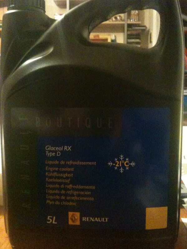

Checked the invoice and it says N/STK Coolant on it, with quantity 1. I'm thinking they have either billed me wrong or just billed me for 1l Should of stocked up.
Yesssss, love it when stuff like that happens :D
They've had enough of my money in the past to make up for it though
Have they not given you Type D?
Cant believe i have took a pic but best make sure its right:

mike that is correct! bargain! they've charged you retail for 1L i bet!
