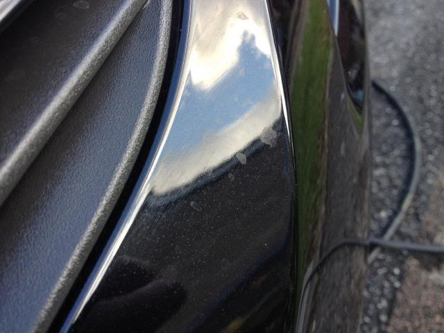

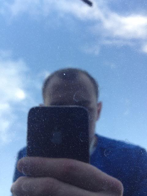

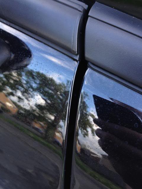

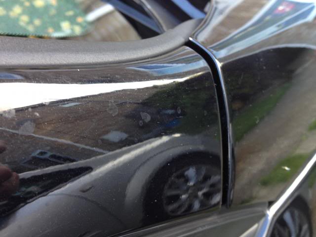

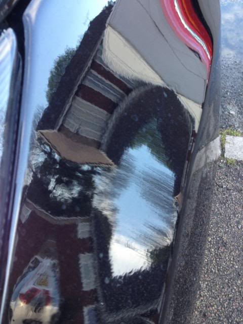

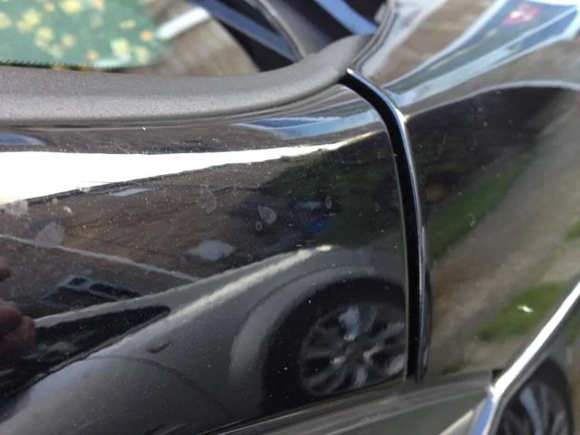

It decided to rain yesterday and then be sunny straight away, resulting in a lot of water spots on my car. I've given it a wash tonight with AF Lather and a quick coat of Werkstat Acryllic. I've managed to reduce them greatly, but they are still there, as seen in the pics below.
The ones on the glass came off with a bit of elbow grease and some AF Crystal, but the ones on the paintwork don't want to budge. I reckon with some elbow grease they will come off, but I don't want to marr the paintwork. Is there any alternative to claying and/or polishing to remove them? As I don't want to remove the Collonite that I applied only a week ago after polishing. Or is this the only solution?

If the water spots are due to living in a hard water area then they will be limescale and therefore incredibly abrasive.
A weak acid like fresh lemon juice should loosen it so that it can be dabbed rather than rubbed to remove the mark without causing any scratches.
