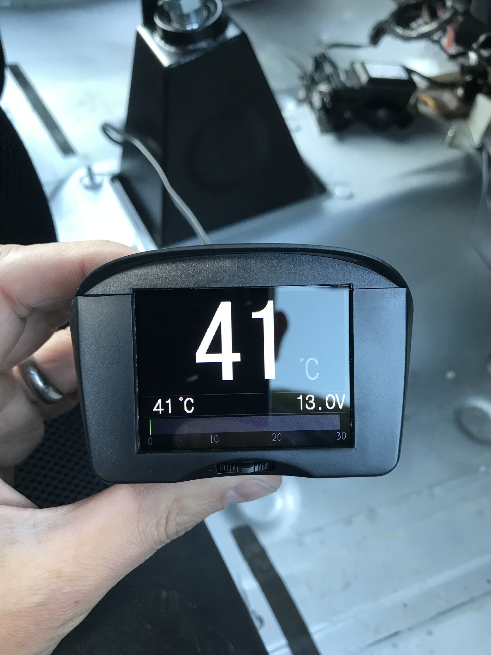

I just brought one of these......
Tells you exactly what’s going on. Takes all of 5 seconds to plug into the OBD port. You can leave it on or just unplug it when you are happy. It also can be used for other displays and some fault resetting. Not bad for £30. Its got to be far more accurate than the dial?!
Usually, but can be annoying too.
The stock dial will have some dead-zone built into it, to keep the driver from panicking at small temperature fluctuations.
It will read 'normal' if the temperature is 10-15 degree's either side of that, because in reality the temperature does change slightly depending on driving conditions.
