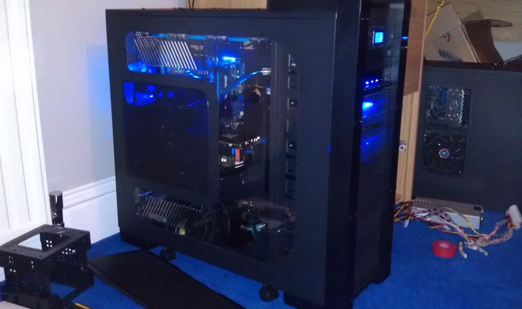

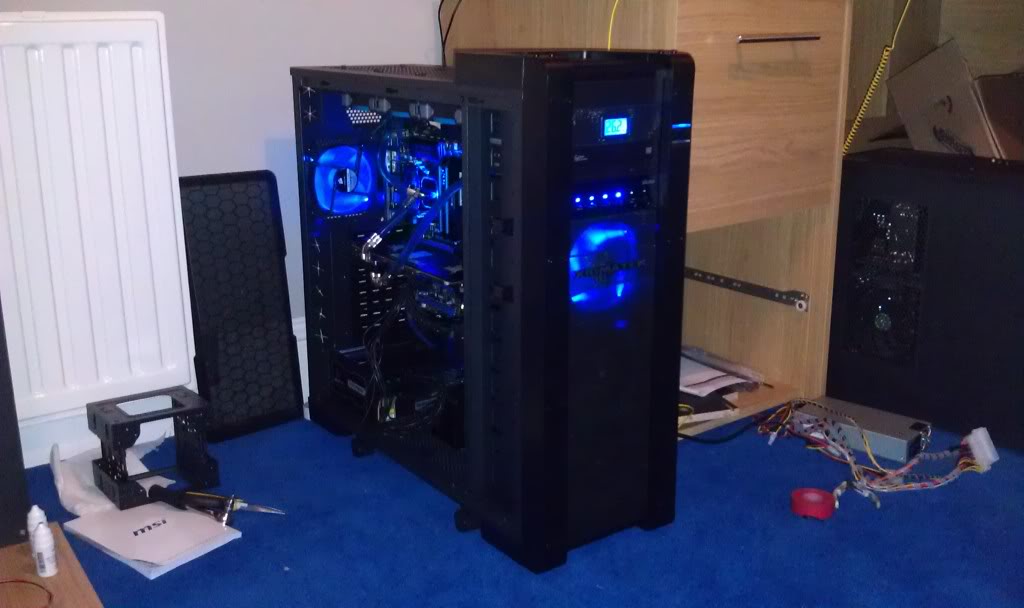

Watercooled PC build
Looking good, and as above that's why I go for coloured tubing, I found the coloured liquid tends to either stain stuff or seperate and gunk up!
The Mayhems is meant to be quite good though, can't remember what I used before but it's a while ago now. I just stick to EK Koolant clear now, easy :p
So what's next, braid the rest of the cables and ur good to go?

Well im not really surprised the Aurora stuff clogged things up.. ITs not intended for everyday only show use and is not like the normal Distilled versions (X1) which I have used (distilled water and a bit of colouring)
In fact on the Mayhems site in big red letters is..
"Aurora is "NOT" made for use in a home system. It has been developed for show System's (modding) and Photo work. If looking for a fluid for a Home system / Gaming system please use Mayhems X1 or Mayhems Pastel range of fluids there are fully tested and working in any kind of loop.
So he kinda fcuked up there...hence why I did a LOT of research and although the Aurora looks cool I would never use it in a cooling loop. I would be inclined to use a loop that is their just for "show" and seperate from the cooling loop if I ever decided to want more "bling"

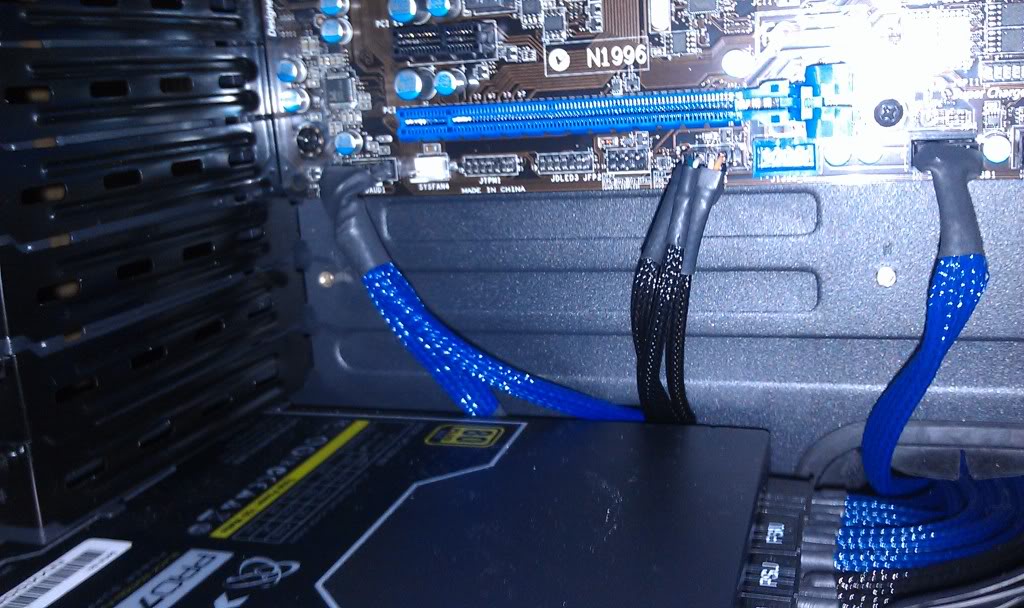

YEah pretty much finish all the sleeving and tidy things up and im good to go.
Not gonna lie I did have a tiny spill of liquid down onto my HDD cage whilst filling..dammed airblock! but it wasn't powered and I have cleaned and dried that...will have to see if I have fubar'd them when everything is together.
Check the rad operations using the temp sensor and basically ran the pump for an hour or so and the loop warmed upto about 23 degrees...whacked on the front rad on low and dropped it down to 17.7 (its kinda cold in my spare room) so was good to see the effect that has on cooling the loop. Did have a slight issue with Fan 6 on my fan controller not being turned down by the controller (led would dim but fan kept at full speed) but checked it again this morning and all of a sudden it works :s Bloody electronics.
Il keep my eye on the bottom of the res for a while and check for leaks..worst case I will drain everything out, take out the res and tighten that f**ker up even more or maybe add some clear sealant along that join. It was only a tiny tiny trickle.

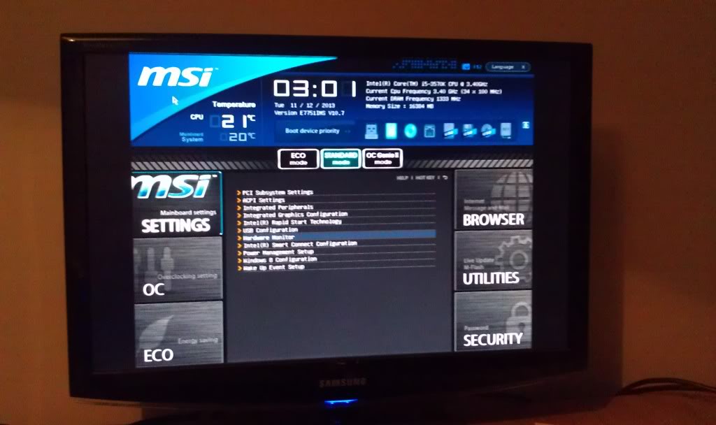

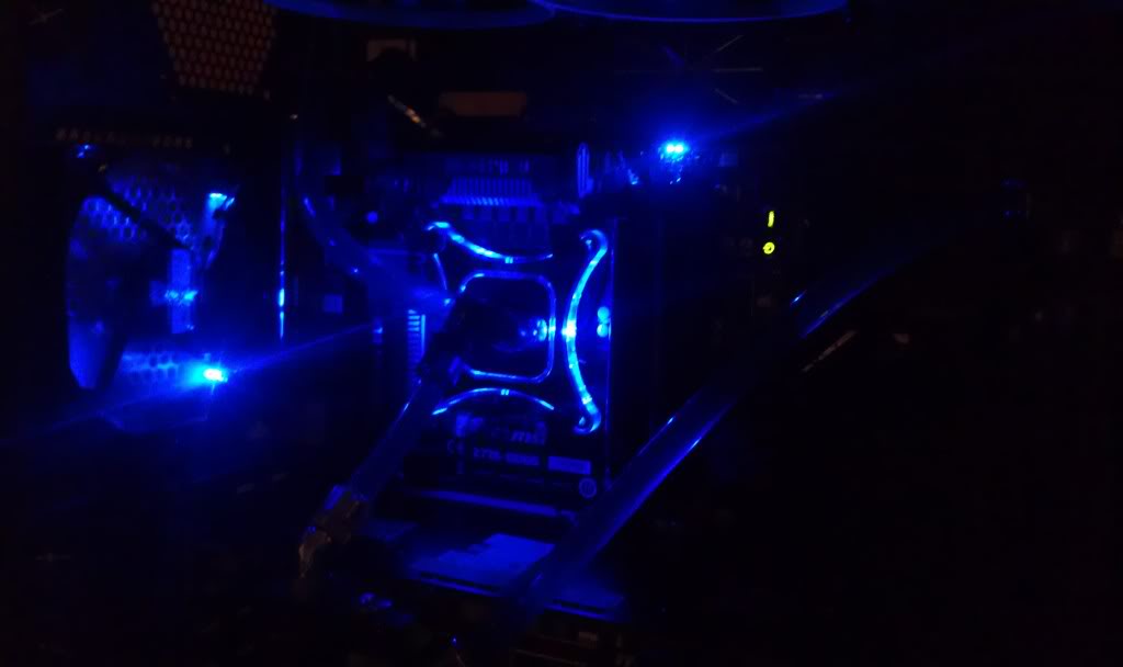

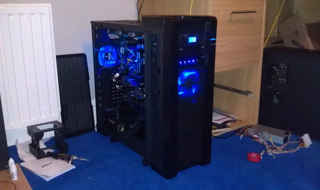

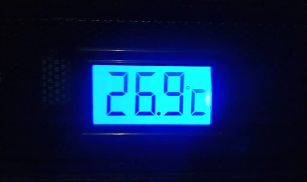

We have boot :) Water Temp on first boot
Just installed windows 7, all MSI drivers, AMD catalyst. Have a few ? under device manager that im unsure of..il install my wireless adaptor in a bit and check wtf is going on.
Just downloading Afterburner, Kombustor, Core Temp, CPU ID and Prime 95 for some stress testing.
Still got to sleeve 1 of the PCI cables and waiting on some slightly longer sata cables as they were a bit short so are routed across the case....I couldnt wait any longer to boot and see what was what!!!!!
So mainly cable tidying left and tweaking left really.

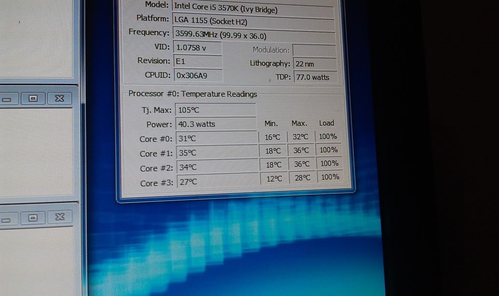

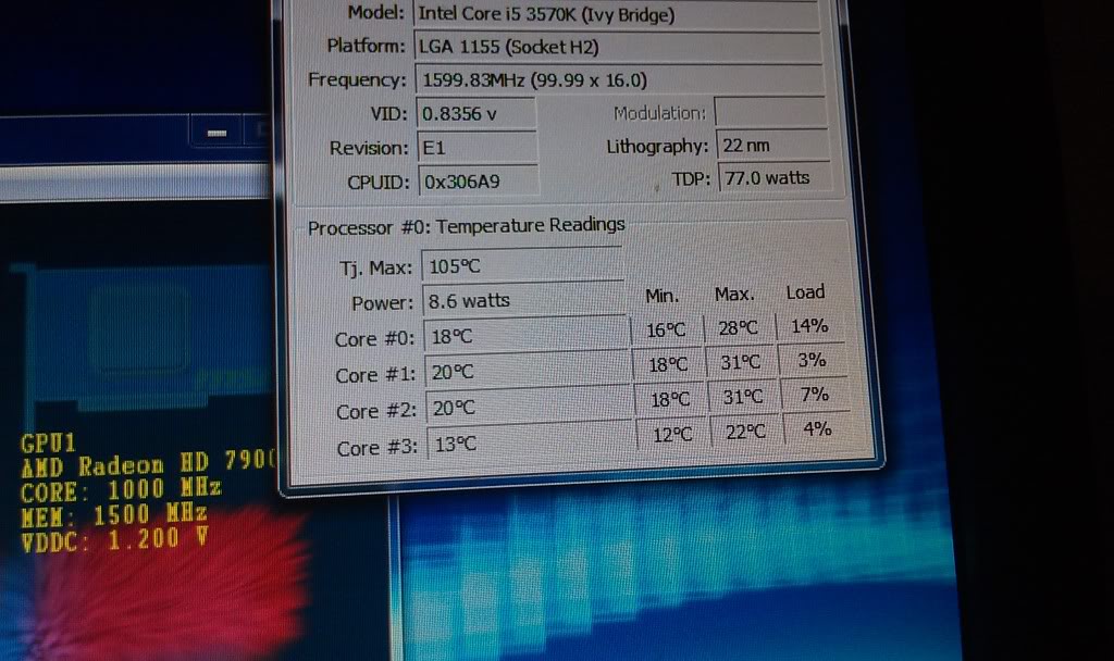

Sooo temps when idle.. (variance on the last core quite a bit :S)
And during Prime 95

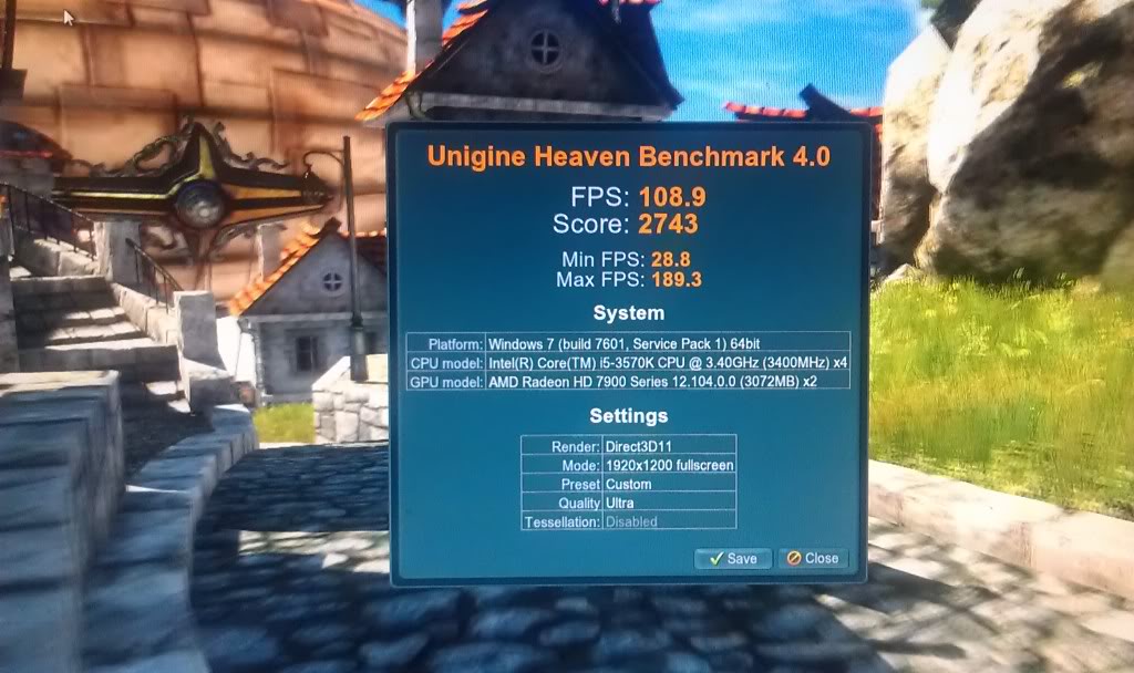

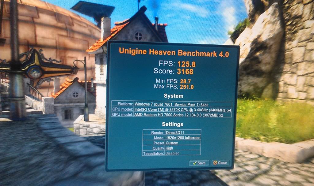

And did some unique heaven tests straight out of the bag (so to speak)
On HIGH
ON ULTRA

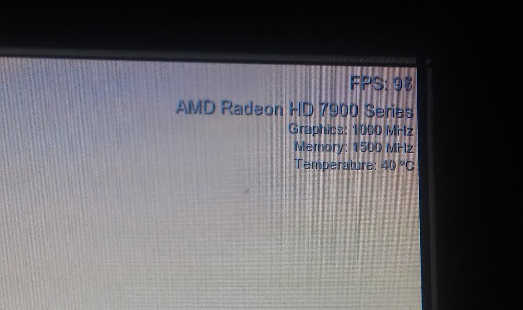

And GPU temp never above 41 degress

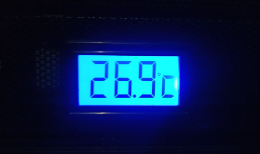

Although water temp did rise to around 25 but I do need to tweak with fans and pump speed (currently set on 1 as anything between 1.5-3 is a god awful noise).
Also I have AMD's lovely coil whine :cool: I can live with it I reckon as il have headphones on most of the time
Sounds good so far, yeah Coil Whine seems to be a common thing on the 7990's or so I've read, it's a shame really.
Nice temps, your ambient temp must be low to keep those temps, and you need some overclocks :p
  Bumder With A Buffer

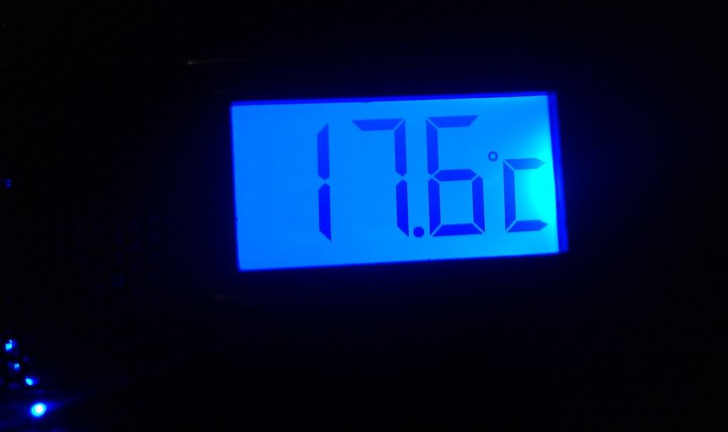

My "spare" room is probably 18-19 degrees at best! :eek: (dont have the heating on in there yet.

With regards to temps should I be concerned what my loop temperature is? Or as long as each component, CPU and GPU are OK then all is good?
When running heaven I'm seeing my loop warm up to about 26 wish and then goes back down after 10-15 mins to around 20. I am running the fans slow just to get a feel for things mind.
Nah loop temps aren't too much of an issue, wouldn't want to go over 50c on the water personally though.
Max I've seen my water was 37c, but that was with real low RPM fan profile when gaming on bf4, so I wasn't exactly trying to cool it.

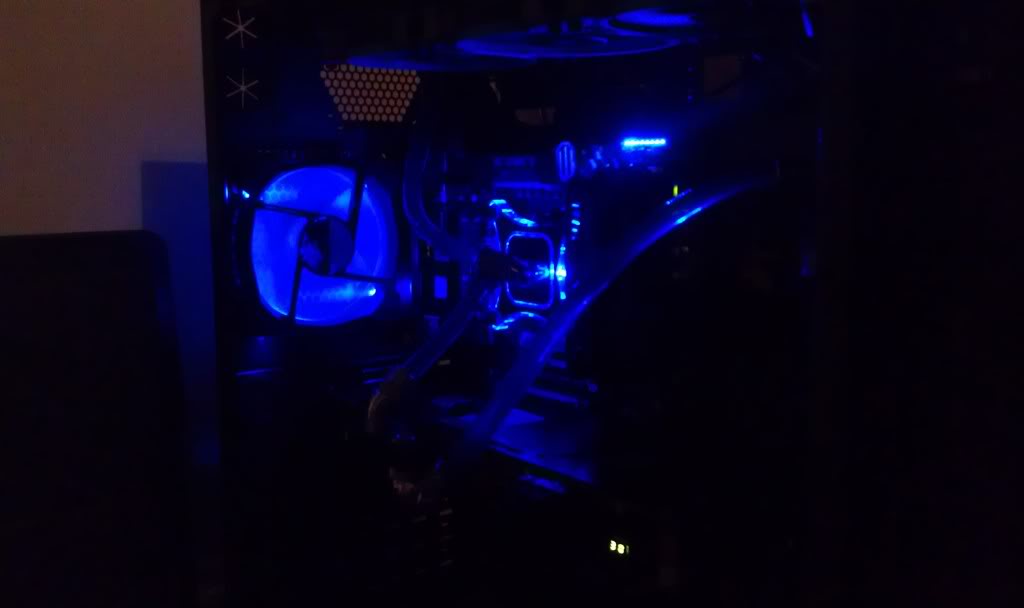

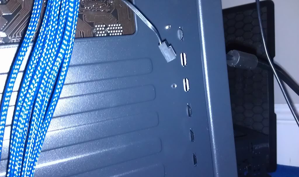

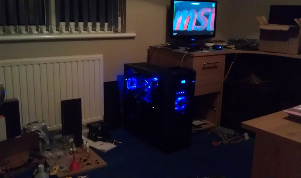

Pretty much done. Just some tidying to do with wires behind mobo tray and sleeve one more PCIE connector to the GPU.
Put the side panel on as well but not screwed in place just incase I need quick access for the next few weeks...its huuuggge
Made my own "Fan splitters" on a piece of PCB breadboard so that I am controlling 7 fans off just 4 of the dials on the fan controller.
1 = Front 120mm for hdd
2 = Front RADS
3 = Top RADS
4 = Rear 120mm input.
Im probably doing things bit naughty as im exhausting through the top rad, but I have cool air coming in from the rear fan and front fan supplying that. I may well change that in in the future but I do have more intake then out at the minute.
GPU maxed at 50 degrees earlier and the fans were on low...Water temp was 36 ish. hacked fans up and that decreased to 31 water and 42 degrees on GPU.
