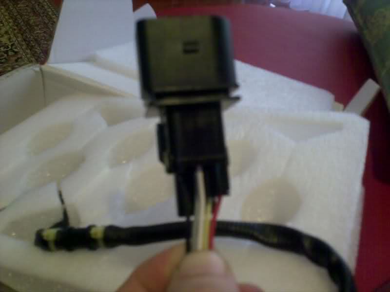

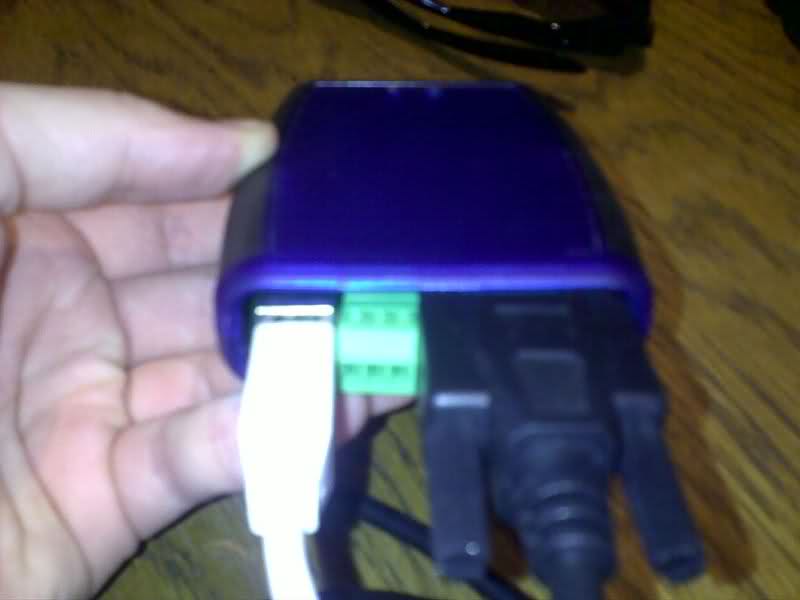

Right, I got me a WB Innovate kit LC-1 (just the probe, O2 sensor) and I need to connect it to my RS tuner interface in order to be able to do data logging for my custom map.
1. How exactly do I connect it - which wire goes where?
2. I need to extend my cable as it can not reach my RS tuner interface (cable is too short). Is there any special cable that I need to buy and how
many wires it should have?
Thank you :approve:
  172 phII
Connect Brown Analog out 2 from LC1 to the most left pin of the 3-pin green RST connector. Thats all.
Do I need to connect the red wire to 12 V? I have herd that WB O2 sensor needs to be heated (needs power) to give optimal performance and to prevent it from burning out.
When will the custom calibration be available?
Thank you
