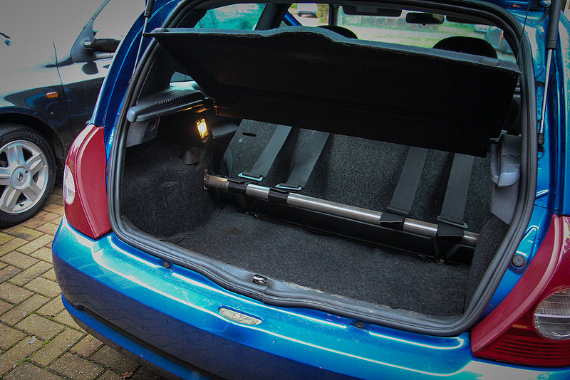

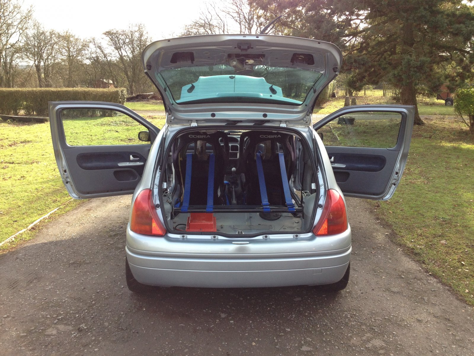

This was my setup on the old Cup. Had spreader plates either side; if that makes sense.
It meant I could hide the harnesses away when I wasn't using them.
That's exactly the thing I'm thinking of, what did you do weld in spreader plates inside and outside the strut towers? You any pics without inside trim?

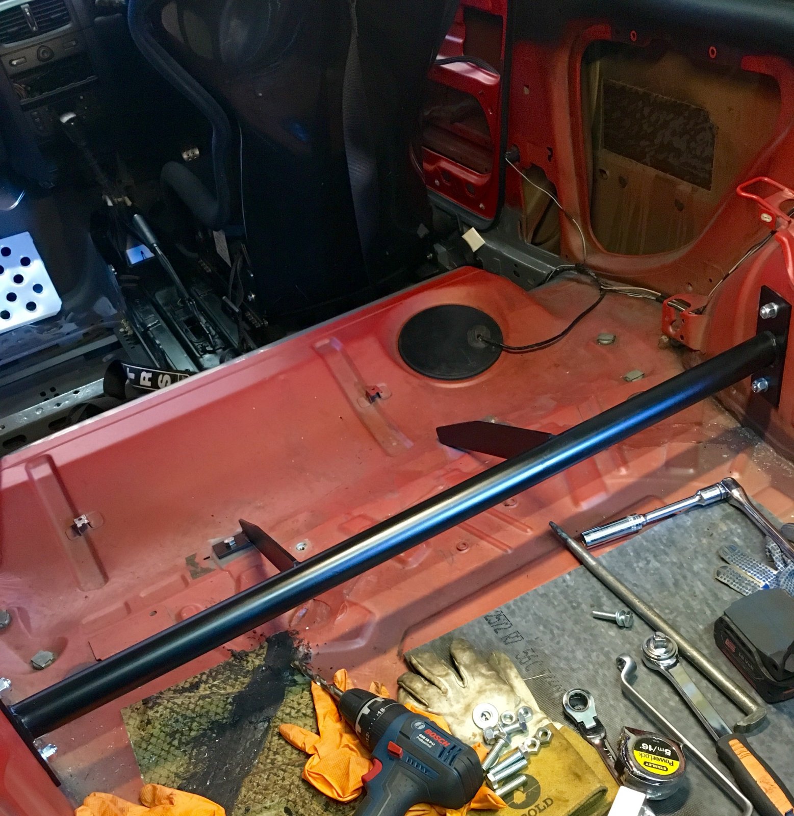

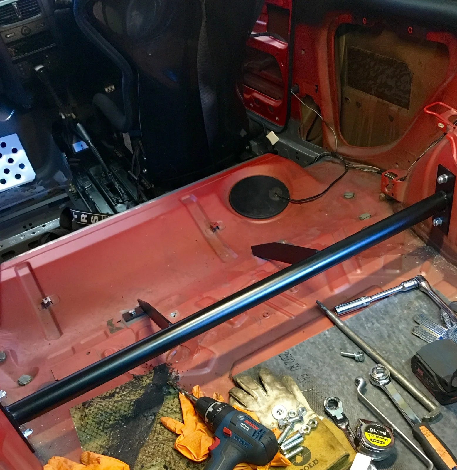

I made this before I put a cage in. Well actually I still use it just with the harness run over the bars in the cage for the best angle.
It's fish plated through the strut, and also mounted down to the original belt anchor points and all fully tig welded.
