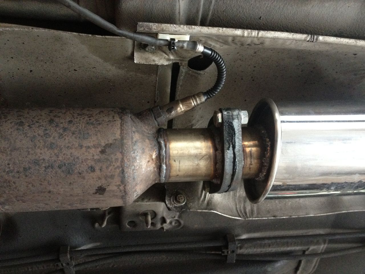

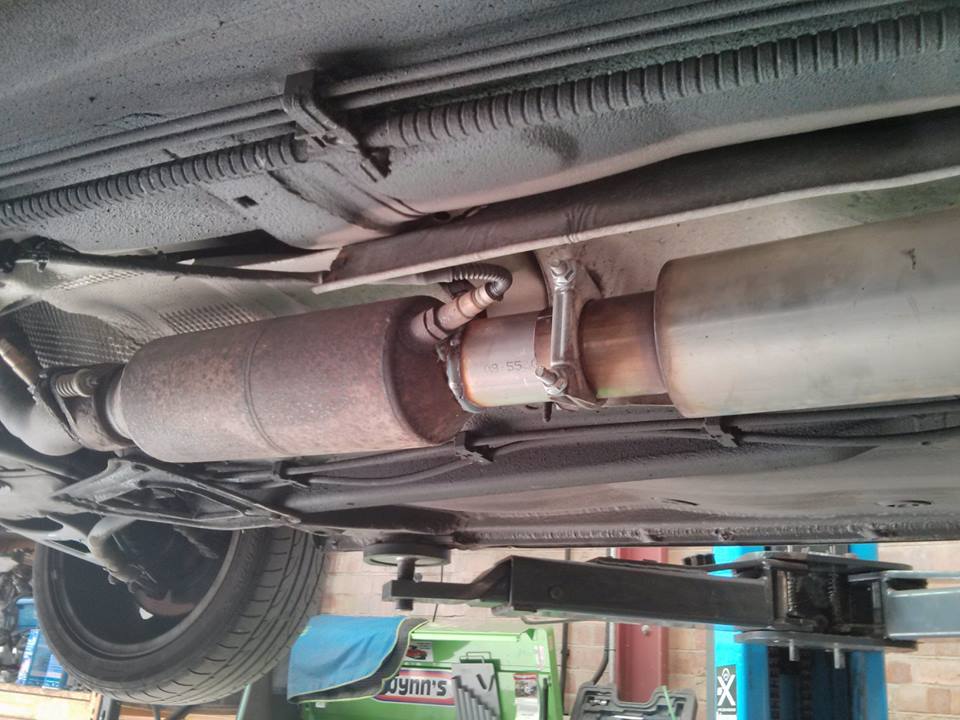

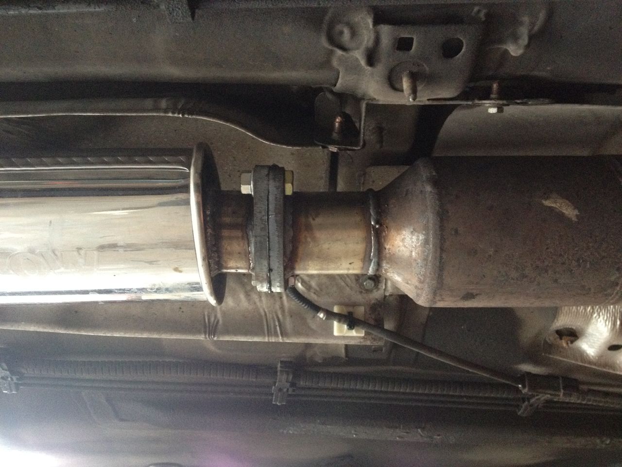

Quick question on the exhaust and welding. I have a scorpion srn019 and it's starting to blow where section after the cat meets the back box. The garage is going to weld it today and are saying it might last a month.
I've replaced the rear hangers with escorts ones from Halfords and they fit quite nicely. If the weld isn't going to last that long what is another alternative fix.
I hope it's not a new exhaust pfft
Cheers

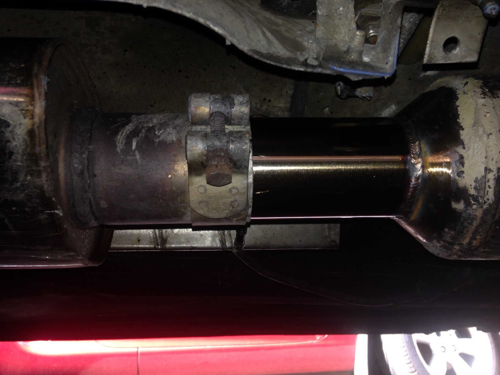

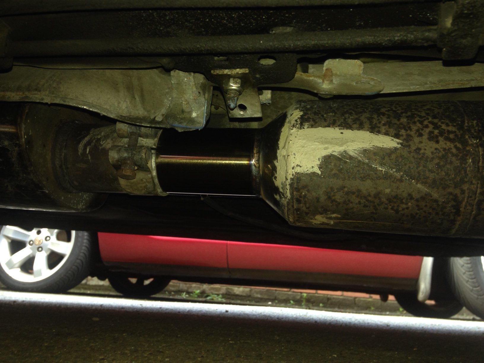

You're talking about the olive joint??
You can cut the joint off, fit a sleeve and use a normal crush type joint you know?

It's where it joins the back box above the rear beam. Is welding it really only going to last a month or so?
Picked it up and it's really quiet compared to what it was. I'll see how long it lasts now.
