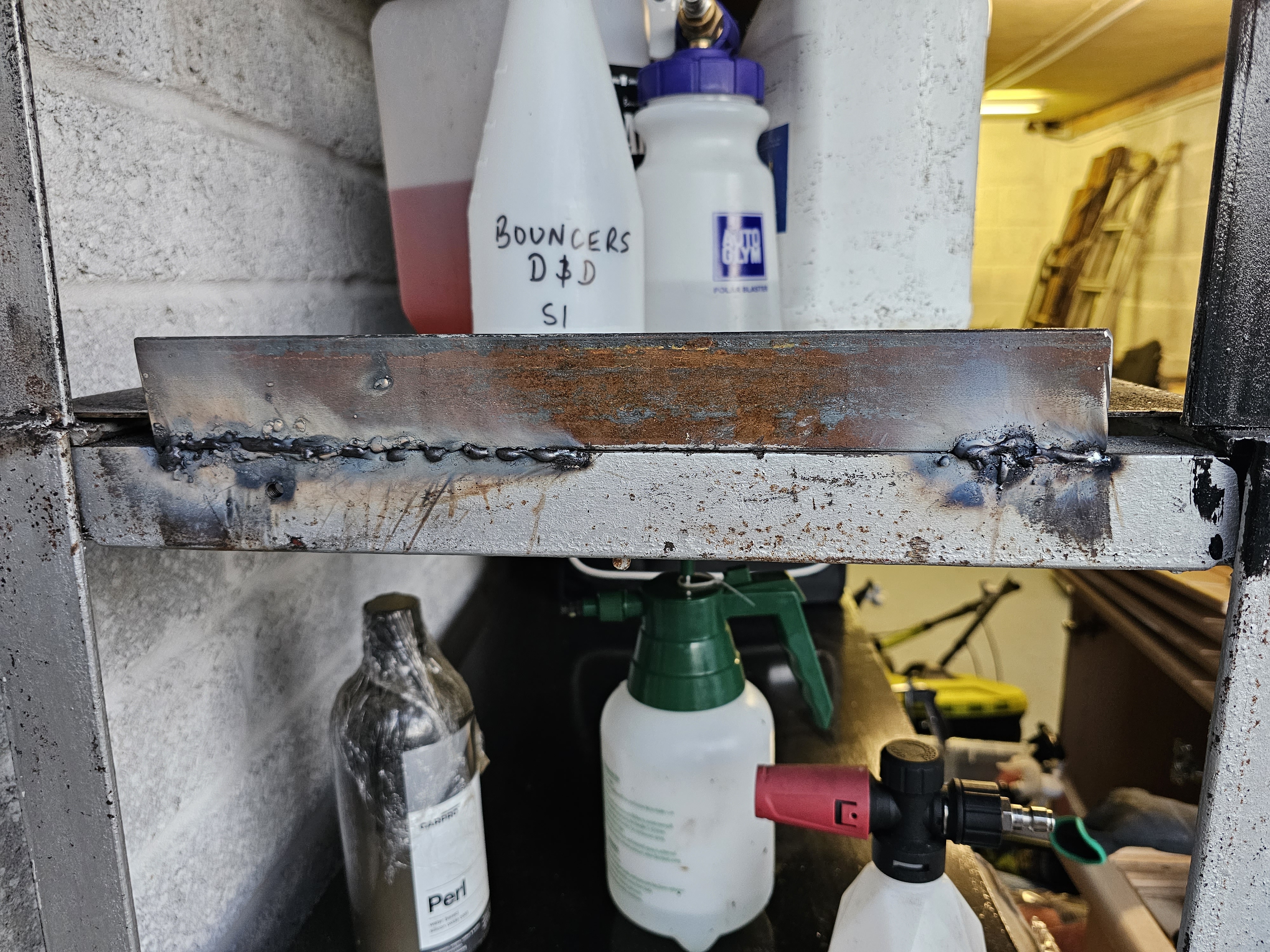

Unsure on your previous comments. Please see my first attempt at stick welding below. I must be naturally gifted?

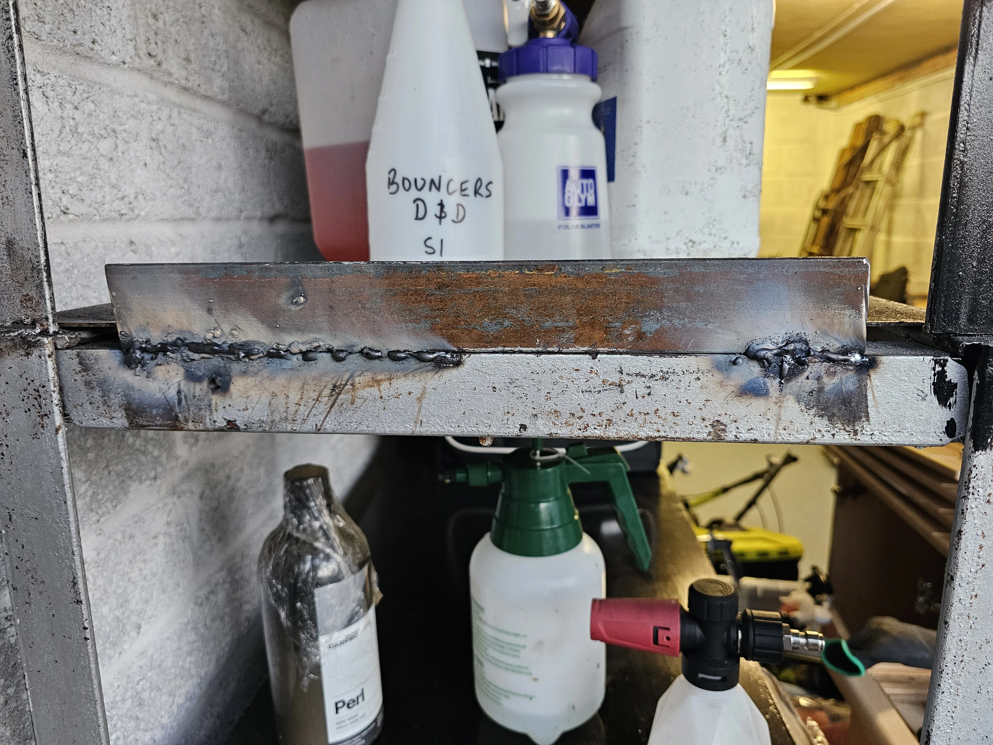

Stick welding not really practical for car repairs, more suited to steel fabricstion / site welding where thicker steel sections are used. Your first welds are unfortunately sat on top of the steel with no penetration. Mig / Tig welding is the way to go really for car stuff with mig being the easier to start with IMO.
Thanks for the advice - at this stage its all about learning for me.
I did have a feeling that stick wasnt going to ever be great for car repairs - luckily I dont need to do any car repairs at present. Its more just learning how it works for the minute as a very low cost option. I was gifted the welder, the sticks were cheap as chips and the rest im slowly accumilating. One thing I will say though is that I seem to really enjoy it.
I will be sure to go Mig at some stage as I think that will be more my style. But naturally a Mig welder is a fair whack more money.

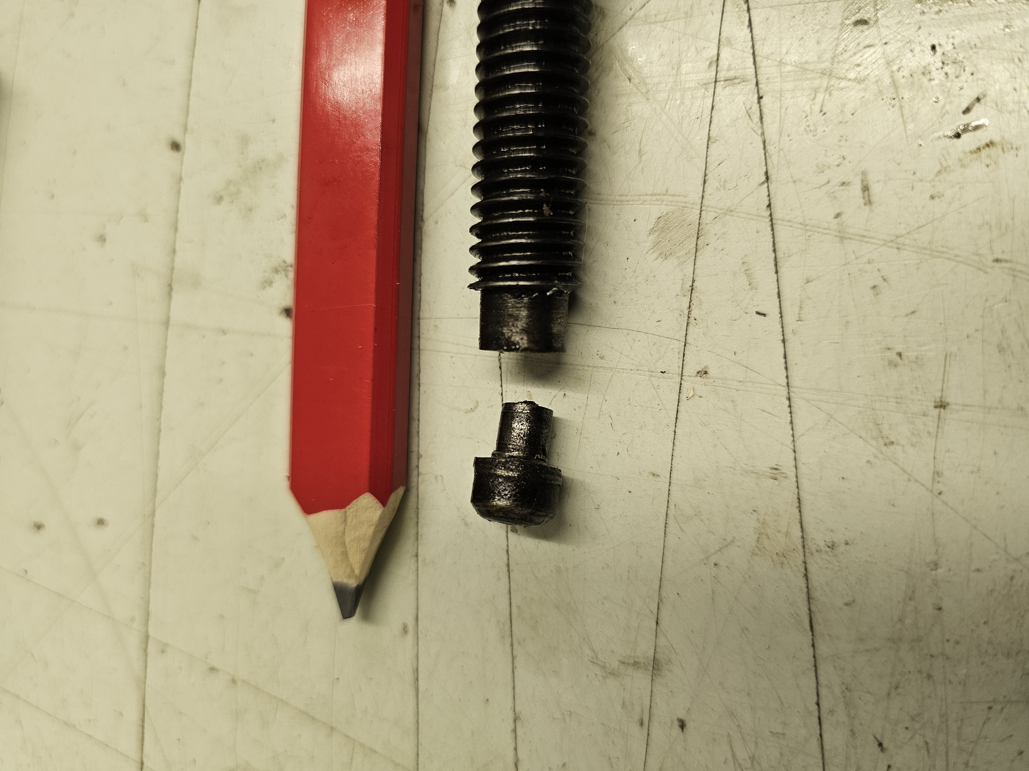

Here's one for you chaps
What do we think about this? I've got this lovely vice that has adjustable angle etc. It was given to me by an engineer and I really want to put it to work.
Problem is, the slider is operated back and forward by the larger of the two pieces (threaded) and is held in by the smaller of the two pieces. So. They need to become 1 again 🤣.
It doesn't need to be incredibly strong but if I stuck a couple of beads on it - do we think its gonna work?
Pencil for scale (I didn't have a banana)

Stub it

Get the trained pigeons out and send it!!
