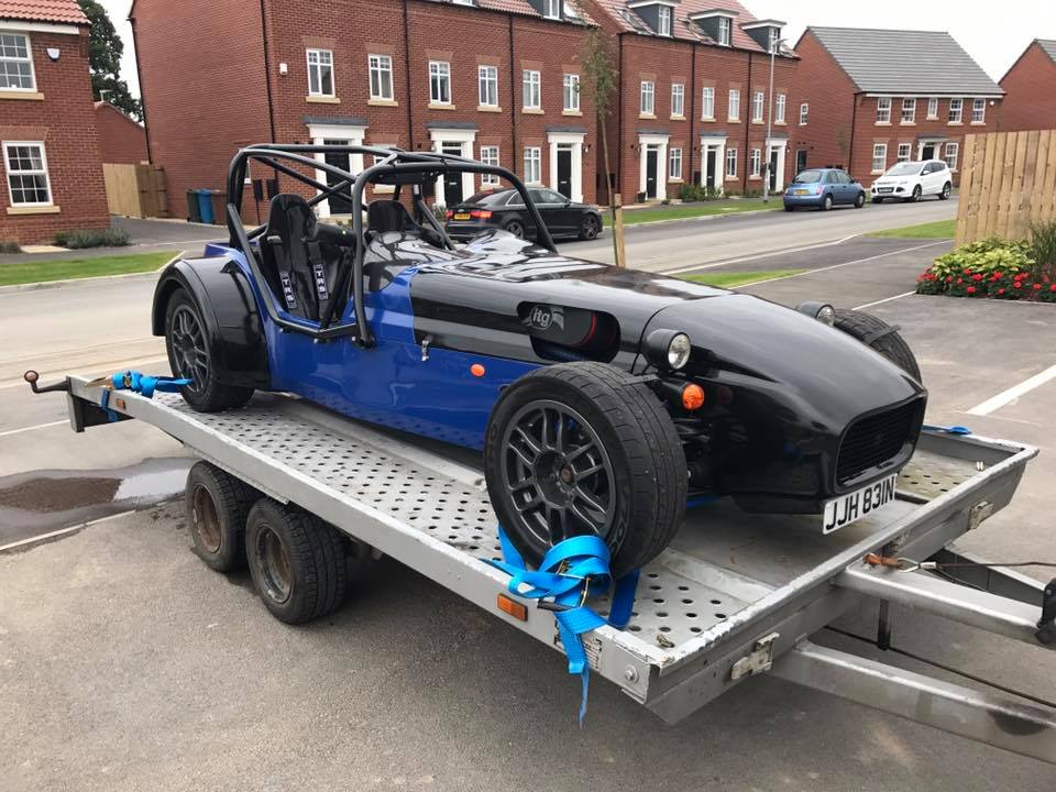

So after having a great time at CSF, it got me thinking about tuning my Westfield.

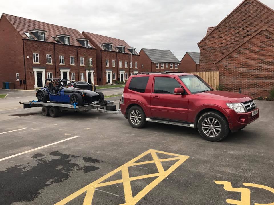

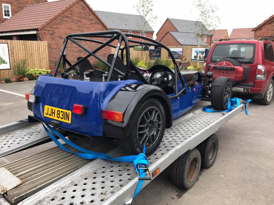

I got on eBay looking for upgrades and then ended up buying another one......as you do, along with a trailer off gumtree. Good times.
Meet Westie part deux.

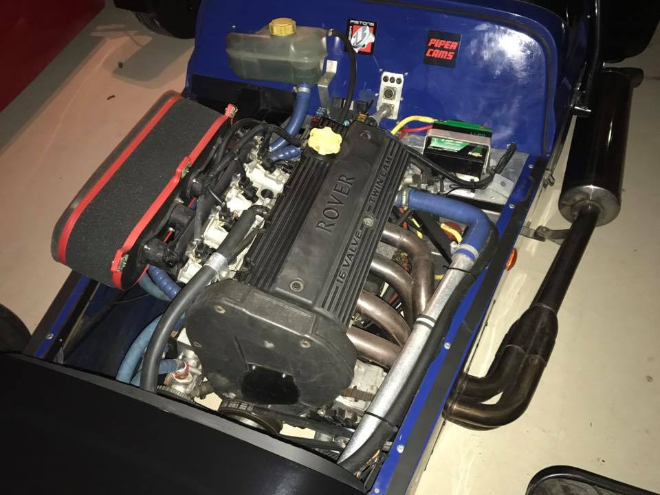

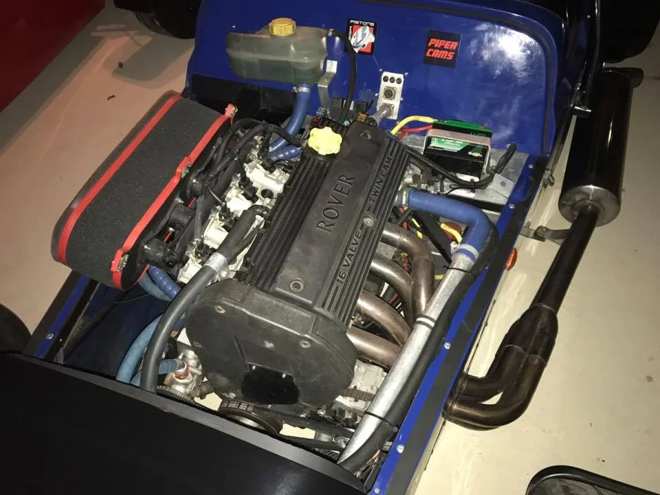

Engine
Rover 1800 K Series
· Scholar Evo 2 block (i.e. it’s got fixed diesel liners rather than ‘mobile’ Rover ones)
· Omega forged pistons
· QED lightweight Flywheel
· Helix clutch
· REC valves (26/29.5mm) with Colsibro guides
· Head modified under watchful eye of Dave Andrews (DVA Power) – for breathing and cooling
· Solid lifters with shims
· Piper 285 cams with vernier wheels
· EU3 head with wasted spark dual ‘coil on head’
Dry sumped using Pace alloy sump, pump (2 x scavenge, 1 x pressure) with Pace alloy tower tank
Jenvey Direct to Head Throttle Bodies with ITG filter
Emerald K6 ECU
Powerspeed 4-2-1 all stainless exhaust
All rotating and reciprocating parts were balanced by Steve Smith at Vibration Free
The engine was mapped by Dave Walker in February 2010 and producing 199bhp@ 8000rpm and 225bhp @ 8800rpm.
The engine has done 10 hillclimbs, 1 track day, 3 races and a few road miles since build.

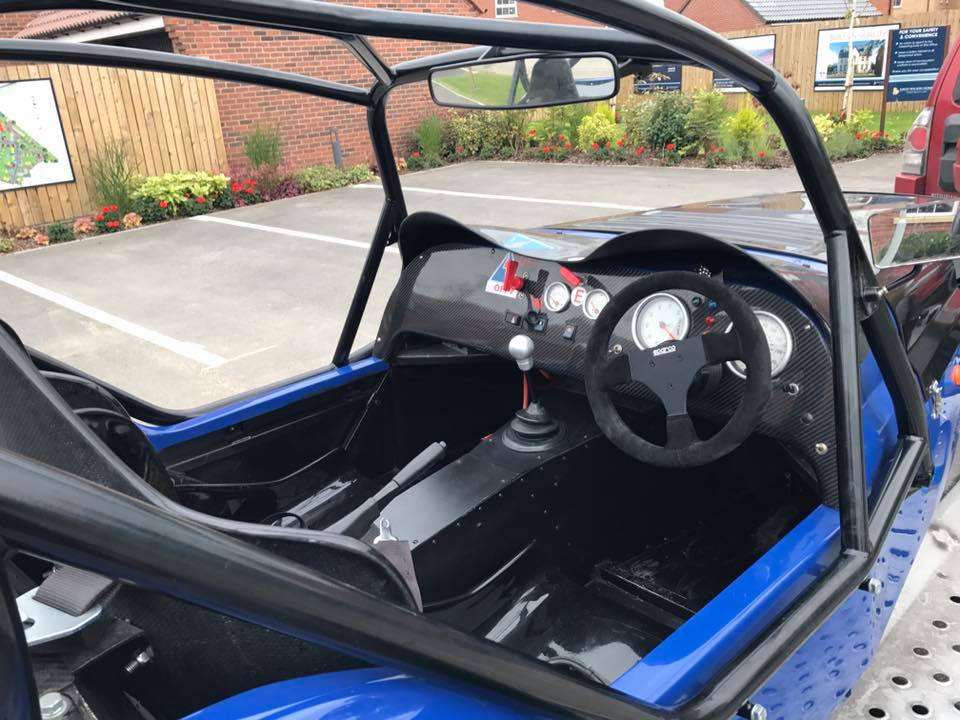

Playskool carbon aeroscreen, dash, rear deck and ‘diffuser’
Interior
Playskool glassfibre seats
Telemetrix Instruments on Playskool carbon dash

oooh thats a tidy one
is it a narrow live axle though ?
Nice spec engine.
some work to be done still ,get rid of those drums, swap your wheels over and swap the carbon
also very useful its not on a q plate though it can have some mot drawbacks

Its on a weird custom wide live axel. I've never seen one like it before. It'll be staying as it is for a while, I'll decide after some track work if I want to change that.
I've got some new carbon arches for it.
I'm also currently looking for some 13" CXR's to go on it. 13x8 at the back and 13x7 for the front.
Yeah the none Q place can be awkward. It's just had an MOT though and its free to Tax which is nice.

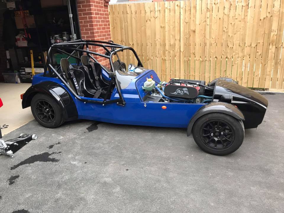

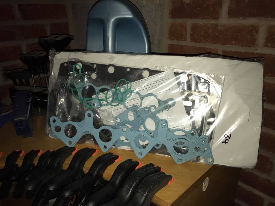

Tonights progress.
Went through all the stuff which came with the car. Found a GoPro! Awesome.
Also found this....... Wouldn't be a K series without a head gasket set....

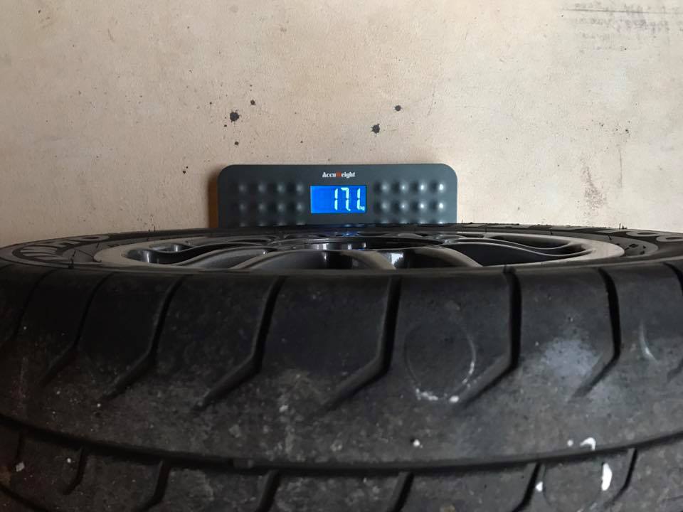

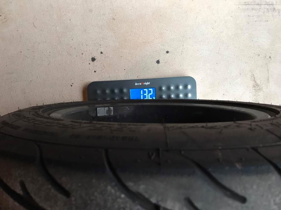

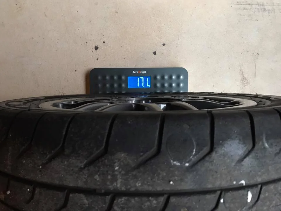

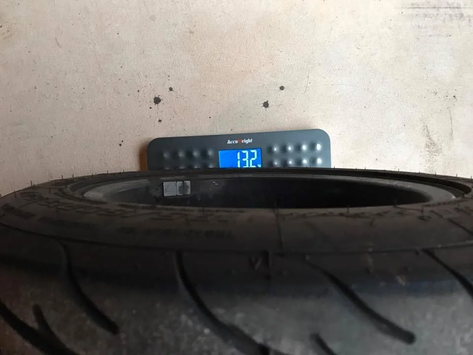

I also trial fitted the 13's. They are 3.9kg a wheel lighter, a pretty good saving of 11.6kg unsprung. Which doesn't sound much but its 2% of the cars overall weight!
Rear needs a higher profile tyre to look right but that won't be a problem.

profile looks fine just get some 8" rears thats what I did
