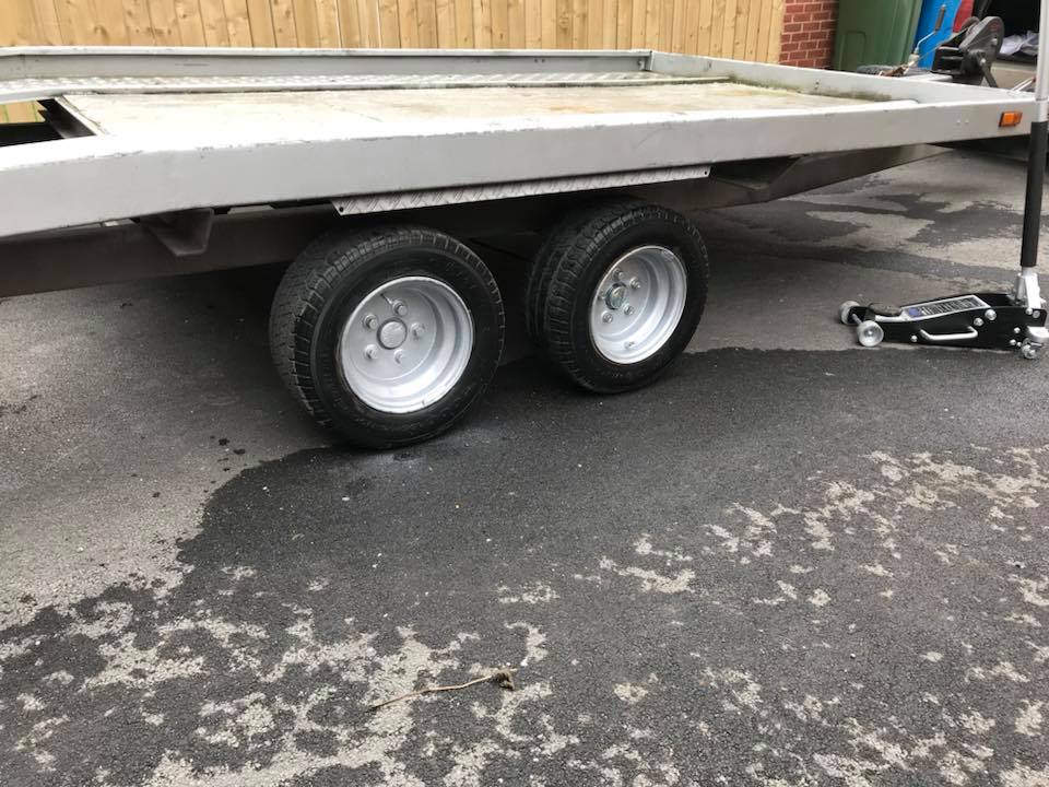

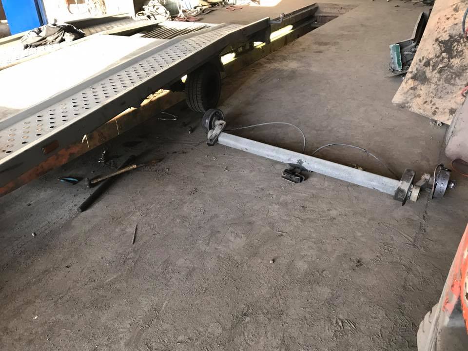

Slight update on my trailer I bought from the Pikey's.

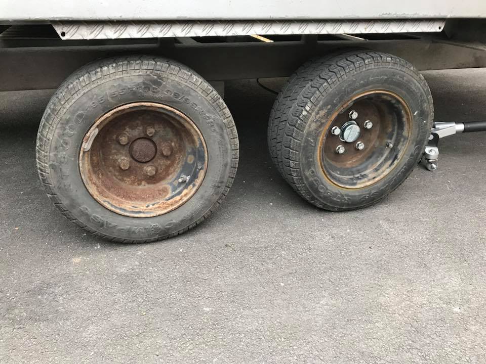

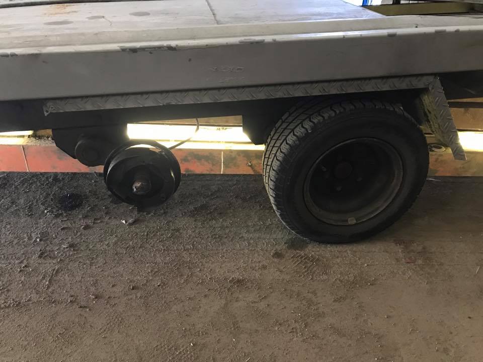

When the wheel came off it totally fucked the axle and mounts. So I've stripped it all off and had a new axle made which should come this week. I hope.
You can see where the baring melted to the stud axle...
Old axle off. (Its hard to see but the mount has twisted too

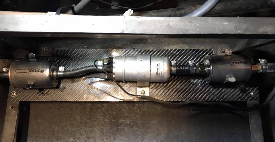

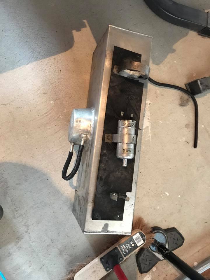

Fuel system stripped out and everything else has had new put fuel lines in place. Just waiting on a new set of pre and post pump filters.
Pump and tank set up. Still has fuel in hence me looping the lines off.

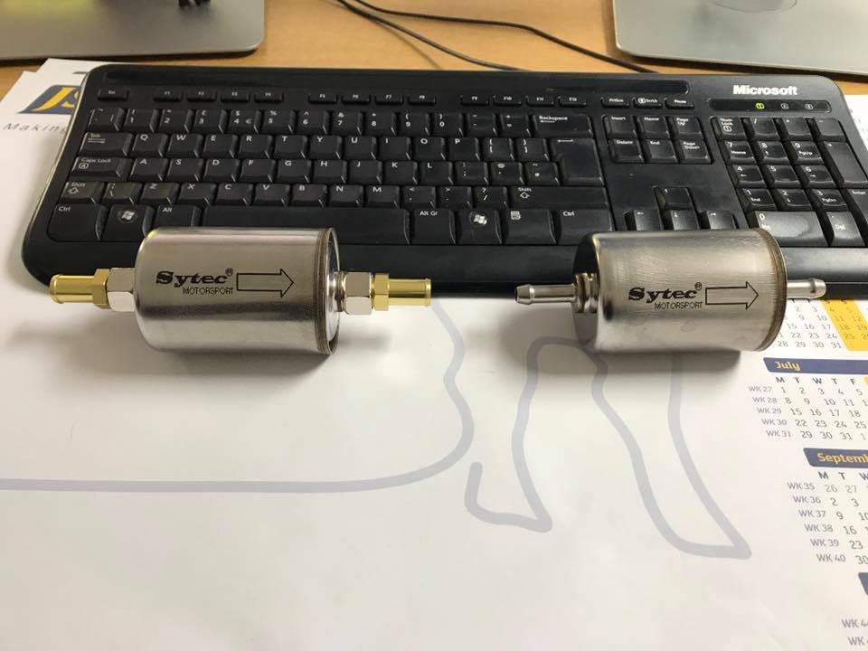

New fuel filters are here. Pre and post pump ones. It was good to see my car already had a pre pump filter fitted. Most Westfield's never have them fitted and then end up eating fuel pumps.

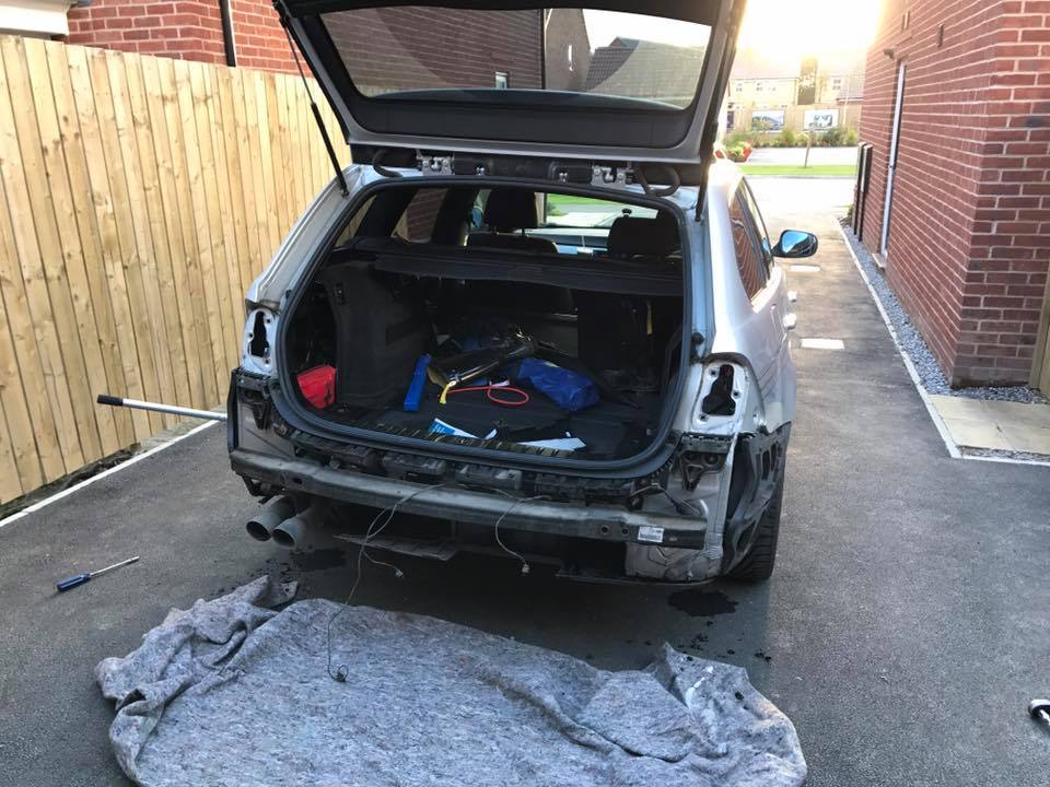

Bit of a shame - but assume it's reversible...?
Tow bar is a hidden one. Taking it back off it only a 60 min job.

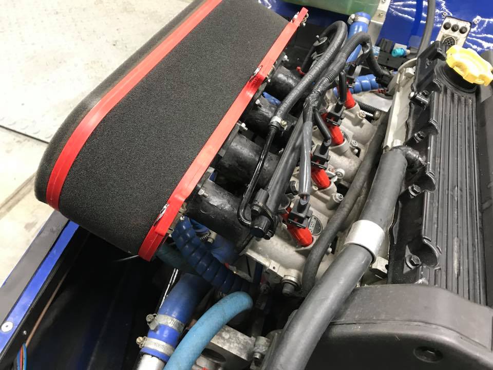

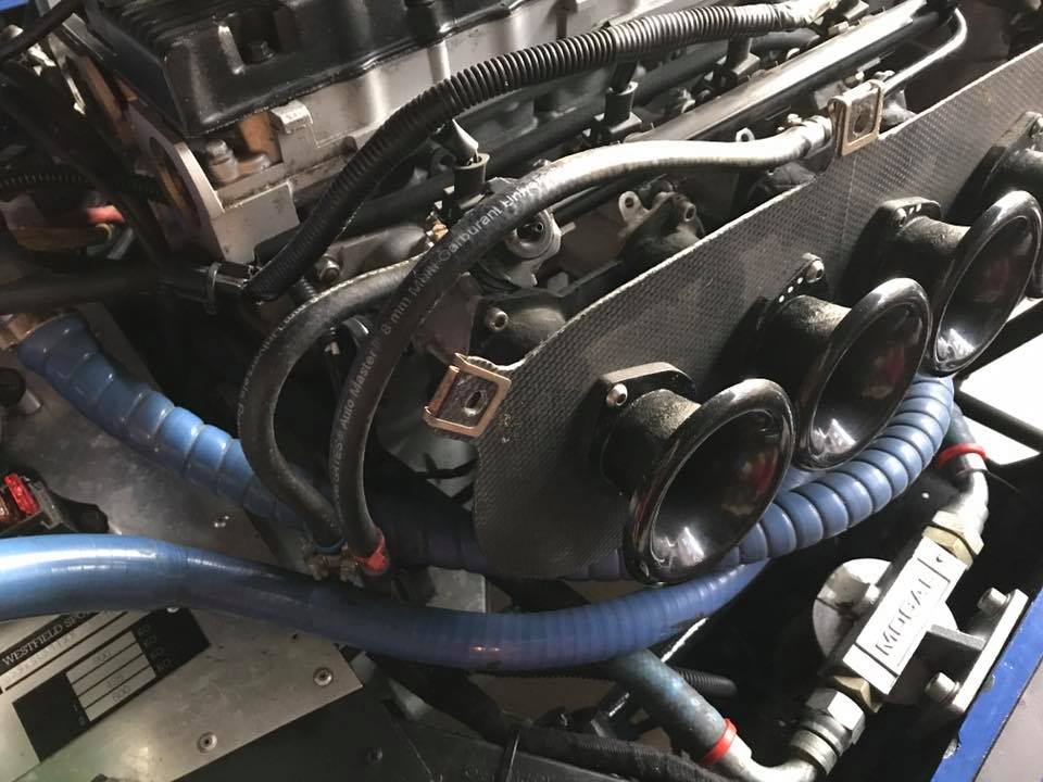

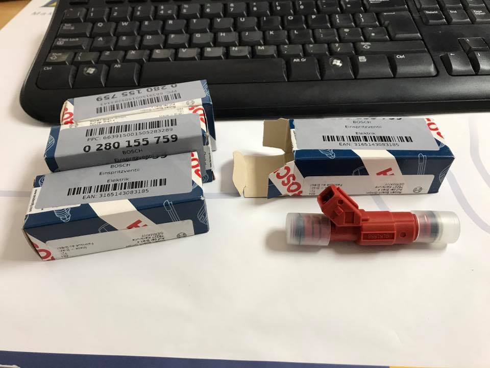

Some 315cc injectors just turned up. They replace the 21 year old 210cc one which have to run at about 120% duty cycle at full throttle! Spray pattern on these should allow a better idle and a bit more torque too.

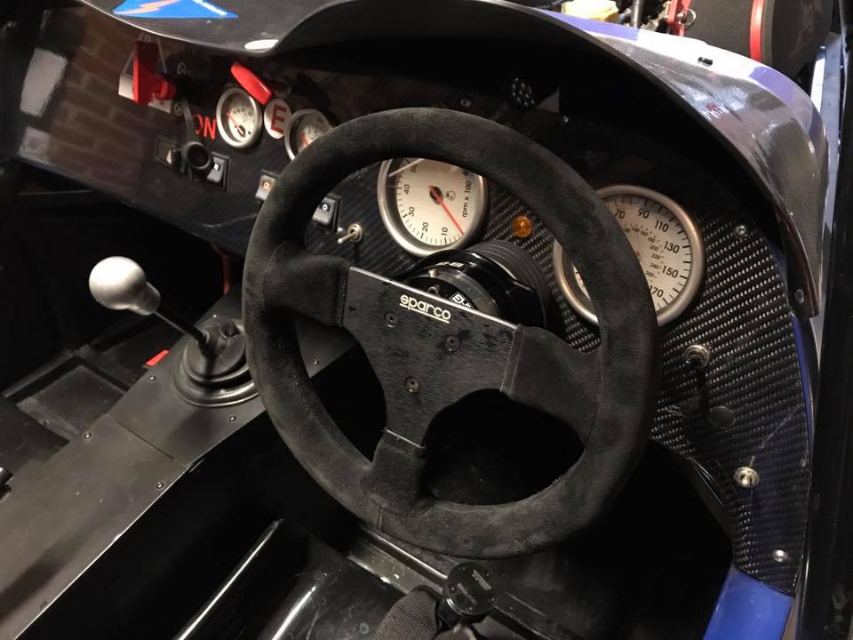

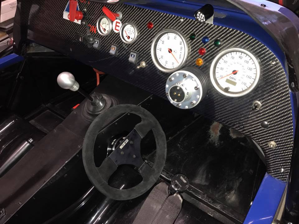

New removable boss fitted to the steering wheel for 2 reasons:
A) I can get in....
B) Brings the wheel into a nicer driving position

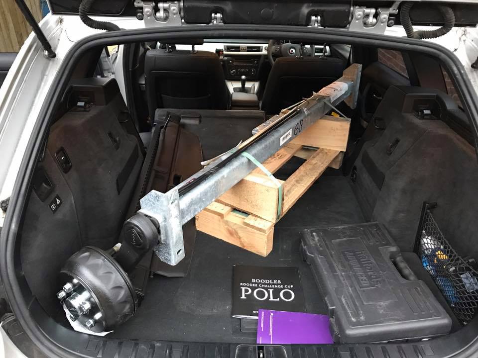

My new axle from Germany is here for my trailer I bought from the Gypos! Yay
Once all that is done the car and the trailer will be ready to go down to Emerald for a re map. Having the new injectors fitted, the bodies serviced and the rev limit lowered to 8000rpm to up the longevity of the engine.

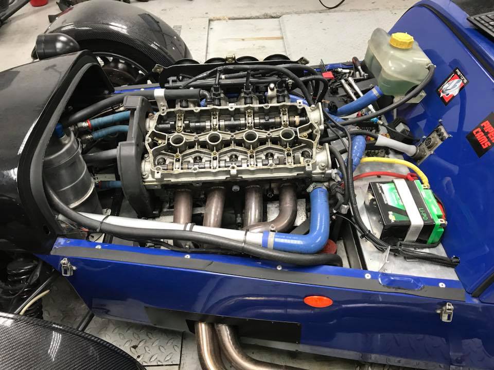

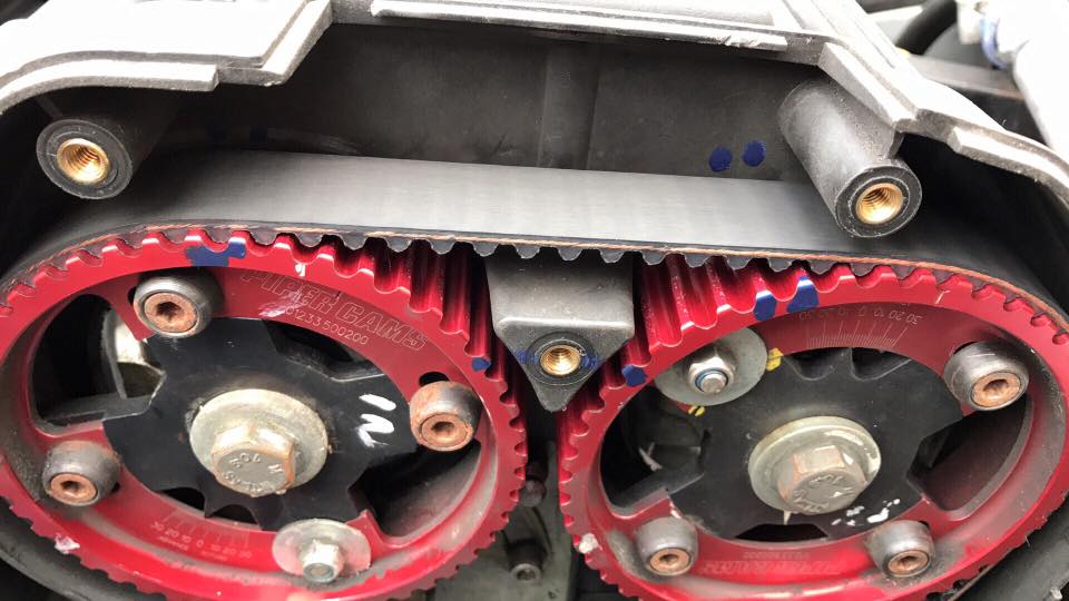

The story before I had this car was such. It had two owners, the guy who built and raced it and a guy who bought it off the guy who raced it....
Well the second guy thought he'd do the car up a bit, he had it painted, bought a new steering wheel etc etc. He also had the cambelt changed. Sadly the guys who did it were obviously a bit s**t.
Nail polish used as timing marks. The inlet cam is 8 degrees out from where it should be. No wonder it runs terribly!

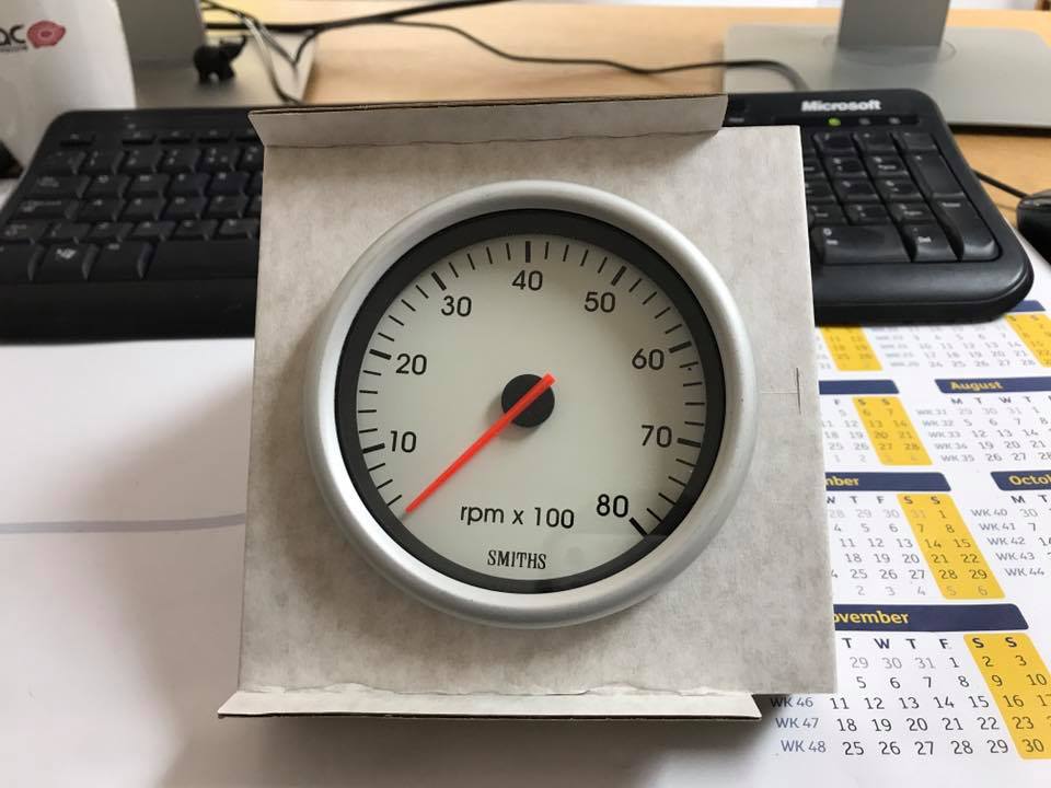

New tacho to test if the old one if funked....(The old one doesn't seem to do anything...)

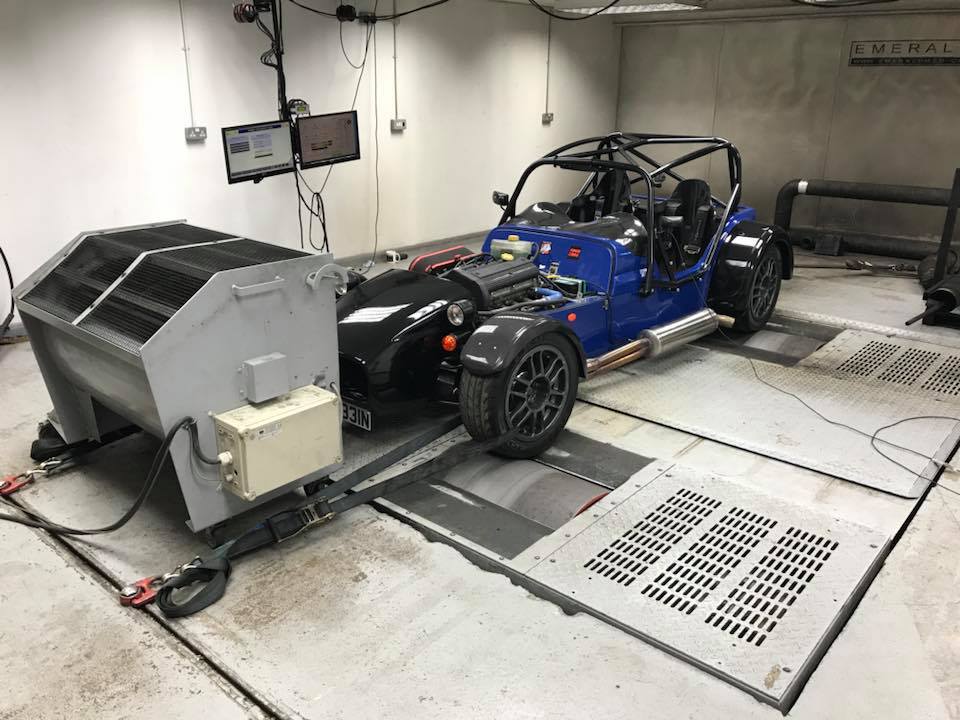

Mapping day.
First up was the cam timing. Turns out the exhaust cam was 8 degrees out.
We did a compression test after that just in case. All was good though!

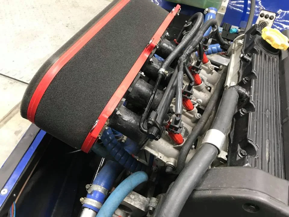

Next up my 315cc injectors were first flow tested and then fitted.

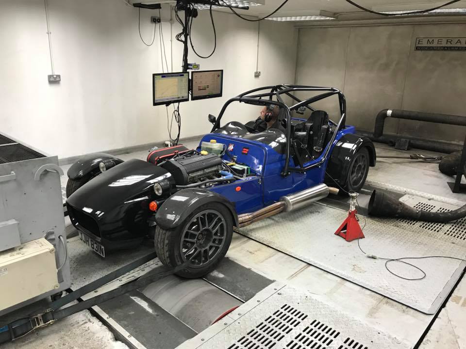

Car all strapped up for mapping.
Car running on the rollers, we found quite a few issues with the map. It was lean all over the place. Made cool flames though.

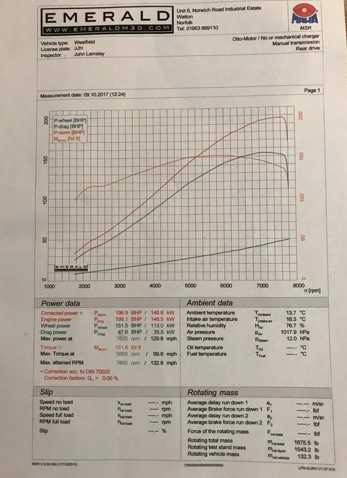

Then a few power runs. In its old spec it made 200bhp @ 8200 and 144lb/ft at 5100. I wanted the rev limit lowering as I'm going to use the car for track and not for sprints. New figures are 199.1 (lol)bhp @ 7600 and 151lb/ft at 5800. Lovely flat torque curve and breaking the 150lb/ft on a 1.8K is pretty good.
In short it goes like f**k.
Thats not bad for a k , but dave knows his stuff as we replaced the lotus ecu on our last elise with emerald
Dave and Dave breathed on that one and it was quick
Wait till you find a need for 250bhp ;-) then you will need those 9" rears

Dave doesn't map any more sadly. He hangs about a bit though. He didn't think we'd see over 190 with a 7800 rev limit.
They did say the lotus lot would buy my engine for about the same money they could sell me a 260bhp 2.3 Duratec for. So thats an option in the future.
