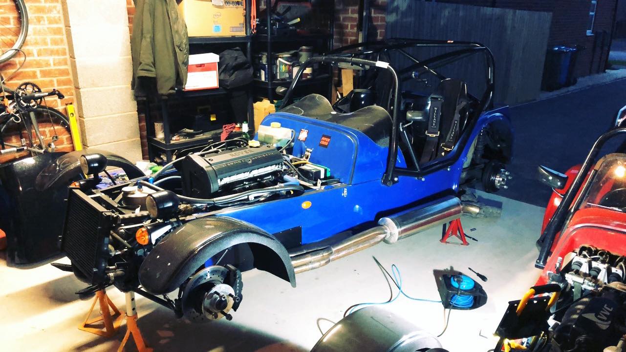

Winter strip down started. Time for it to be a money and time pit no doubt. Hopefully will be looking different for next year.
Worryingly I found I was missing 4 bolts out of my inlet.... I'm guessing they weren't ingested!

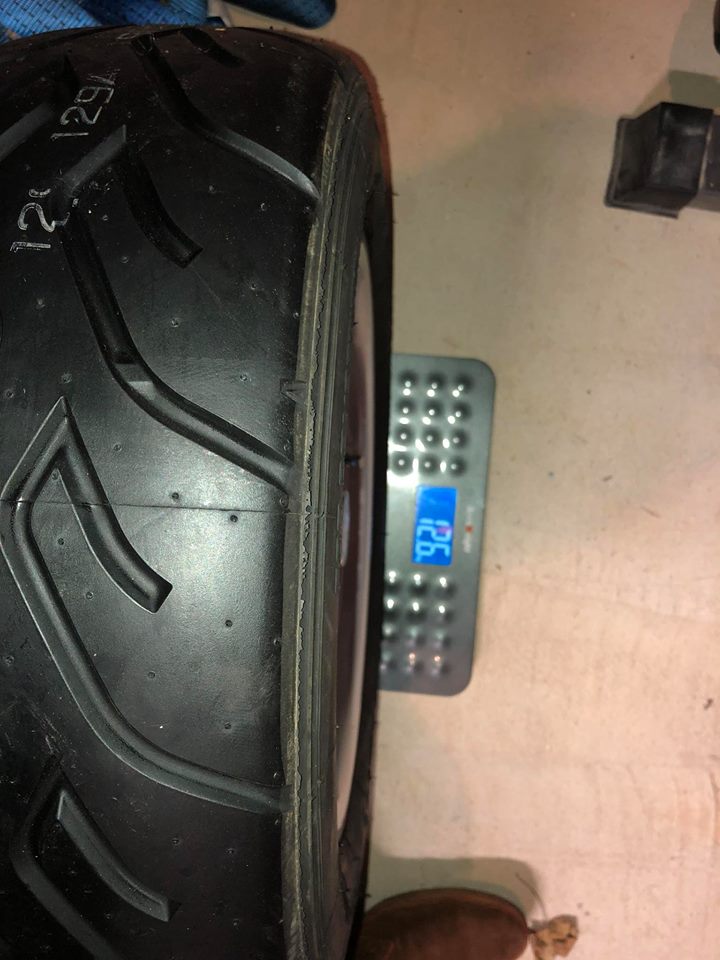

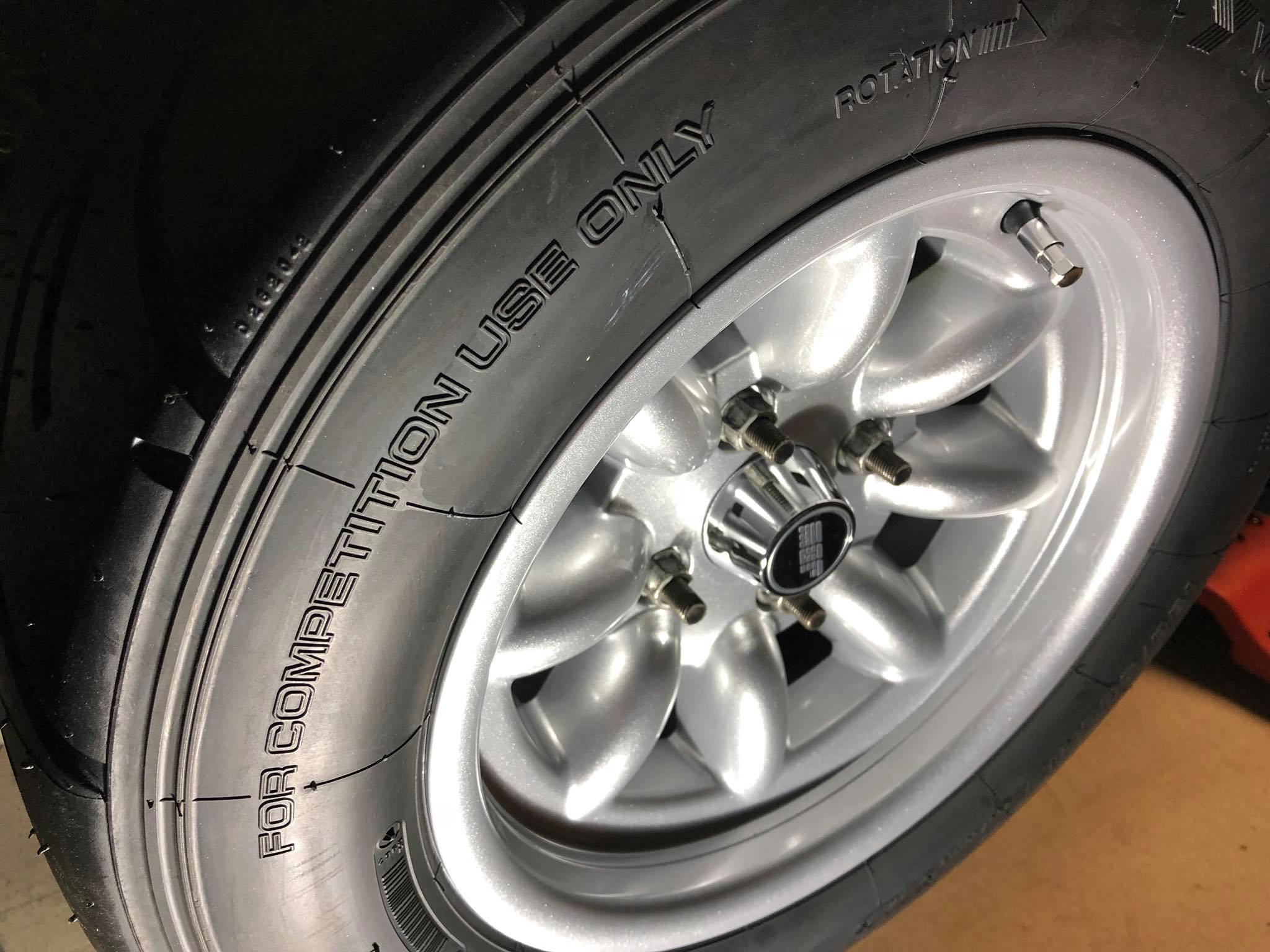

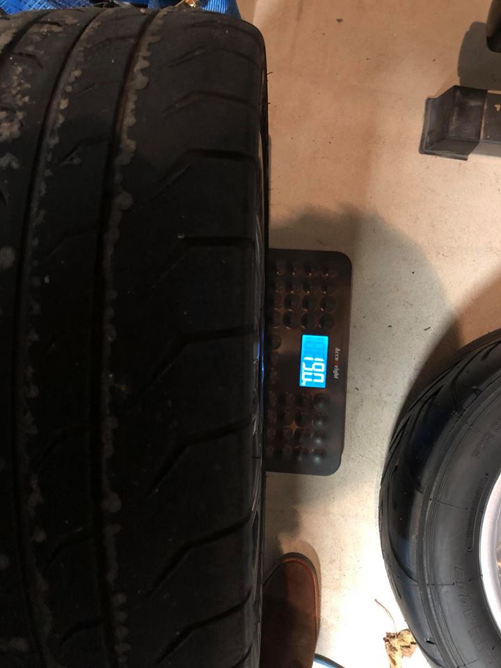

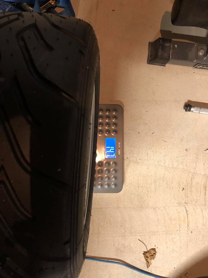

New wheels and tyres. They get me away from using spacers on the rear too!
Old wheel weight 19kg
New front weight 12.6kg
New rear wheel weight 14.7kg
Total saving of 21.4kg unsprung! Which in this is worth 10bhp/tonne!

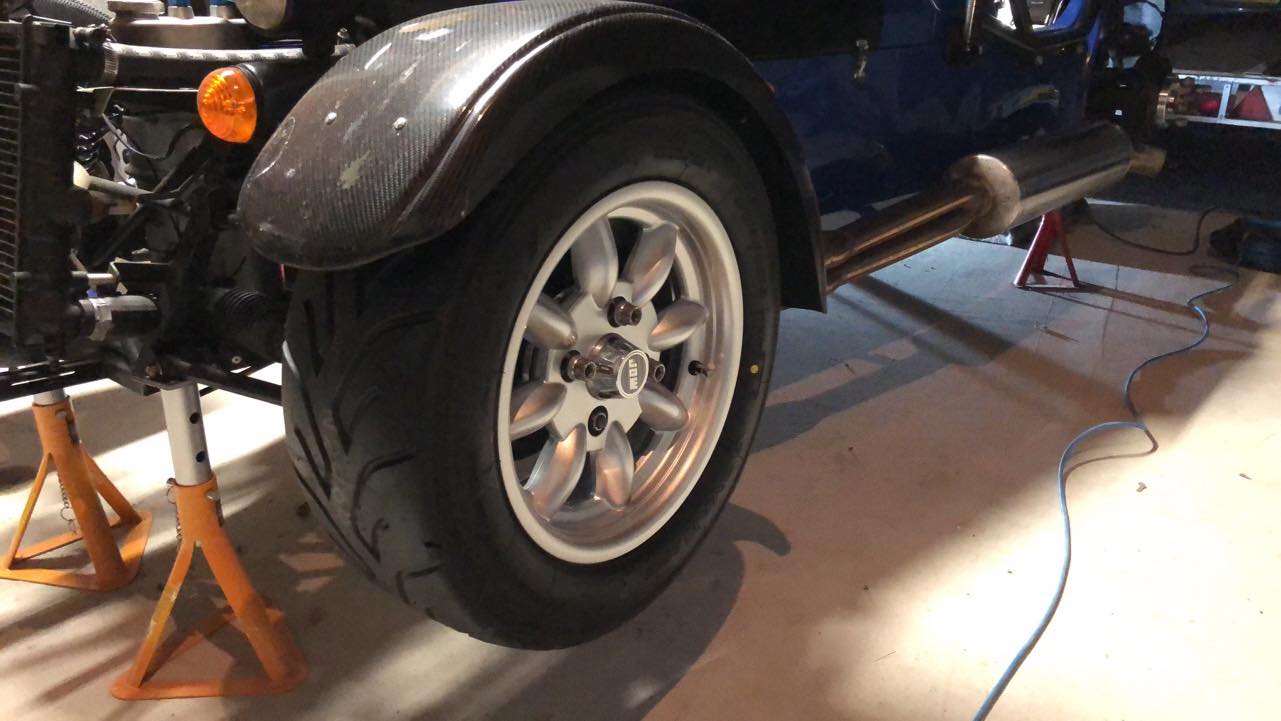

Trial fit

Lovely garage setup! Car's alright too. I'd drive that as is (i.e. without a windscreen) but get myself some driving goggles like I'm driving Chitty Chitty Bang Bang. Except there'd be a couple of GoPros hanging off the roll bars catching my mad drifts yo.
