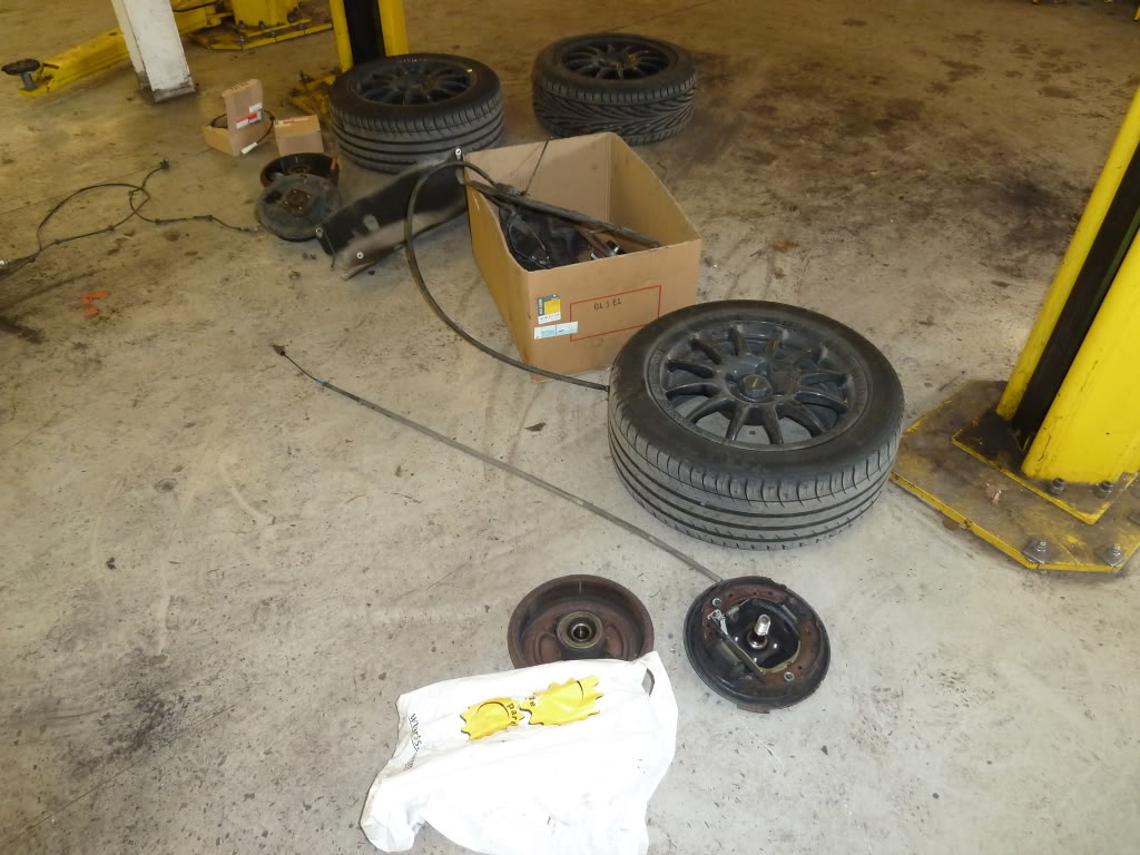

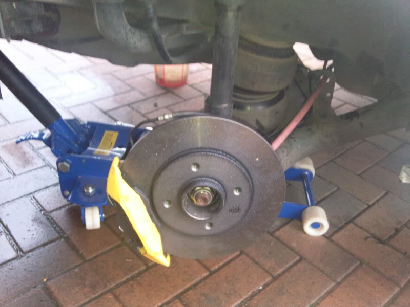

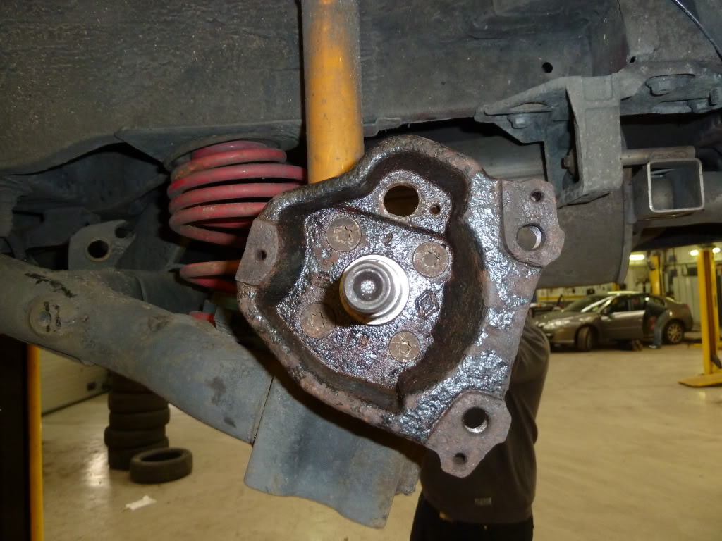

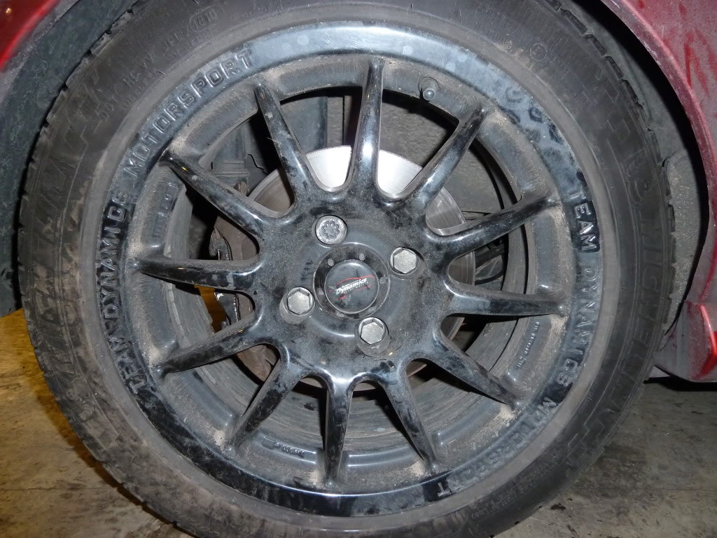

Rear conversion done.
The standard 172 ABS sensors and the original DCI ABS sensors wouldn't fit, so ended up sourcing some from a 1.6 clio (with discs as standard) which fitted fine.
Next issue was the ph1 172 handbrake cables were far too short, so we ended up extending the thread on the handbrake lever by 2 inches. Job done!
Everything else was relatively straight forward.

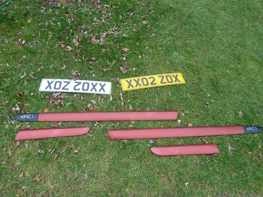

Few pictures from the conversion, will be getting the cup spoiler, spacers and 3/4 number plate done this week

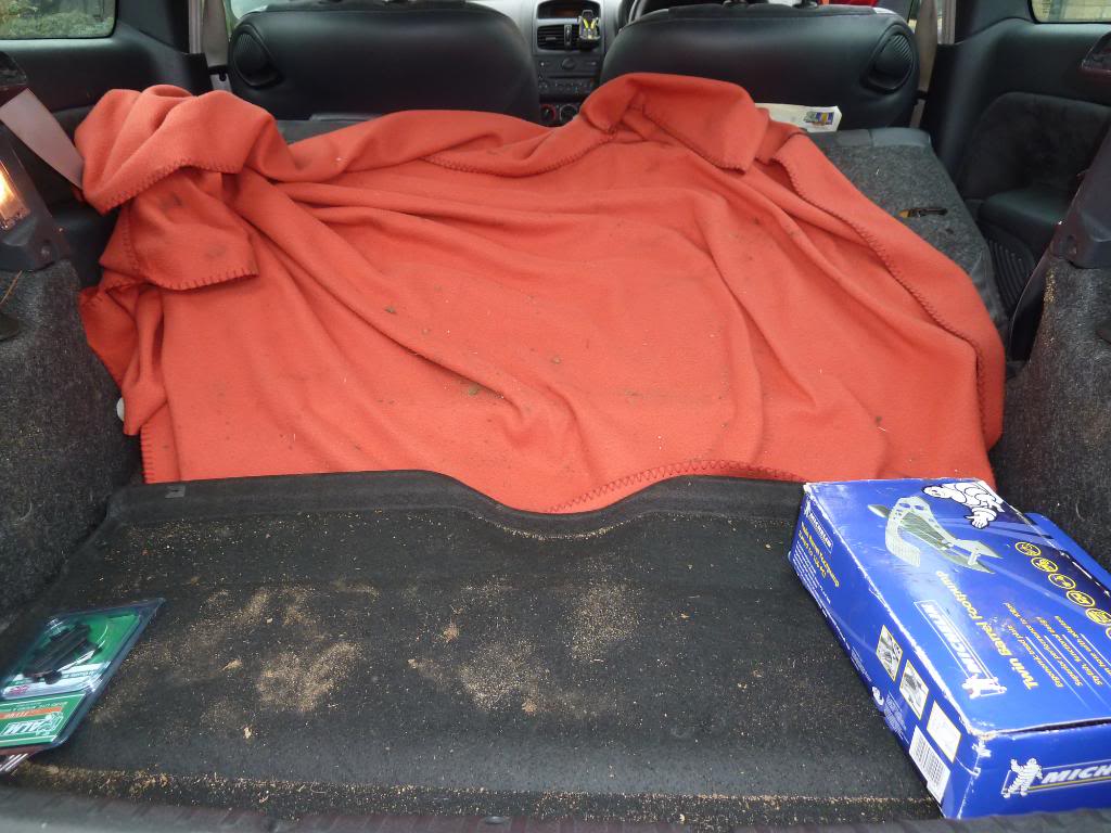

OLD/NEW BITS!

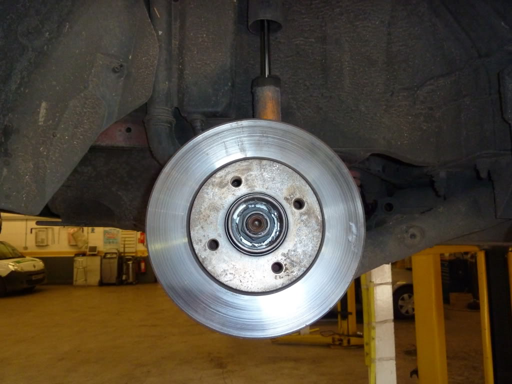

DISC HUB ON
DISC ON

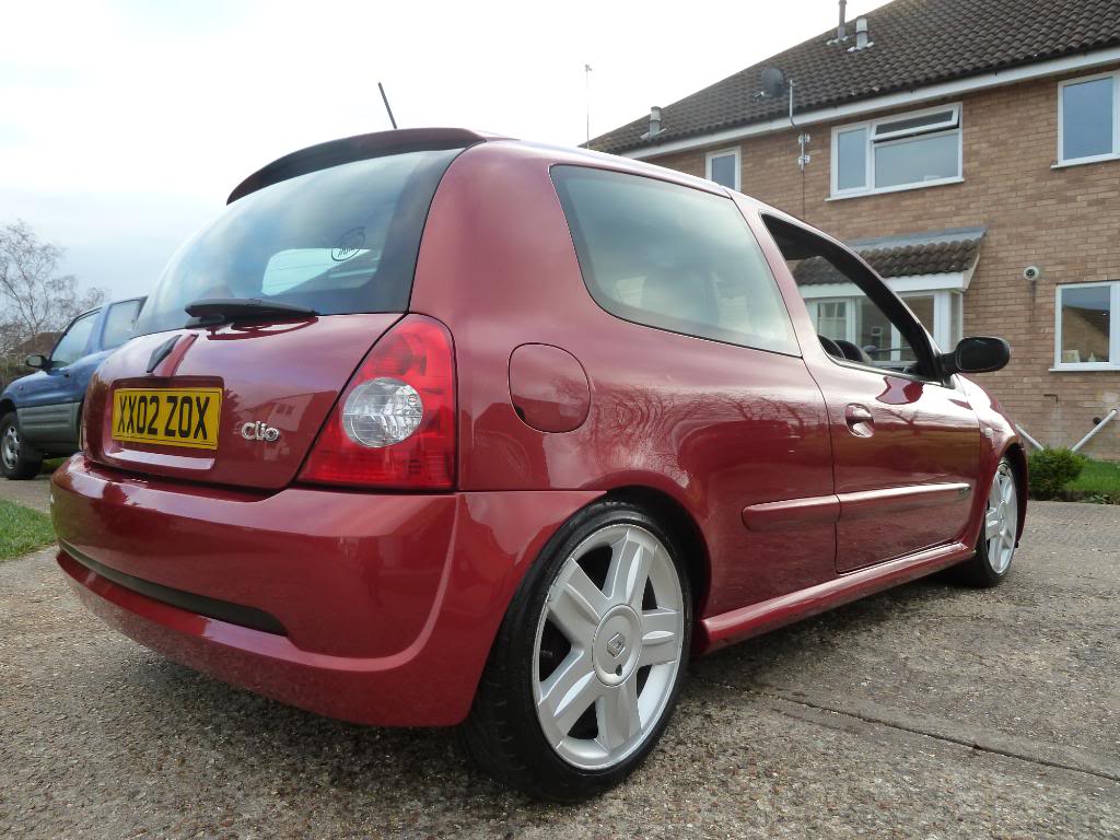

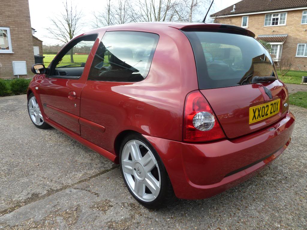

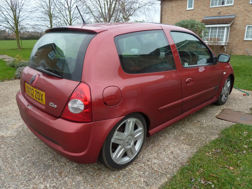

COMPLETED

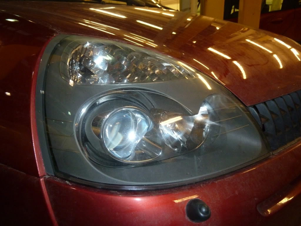

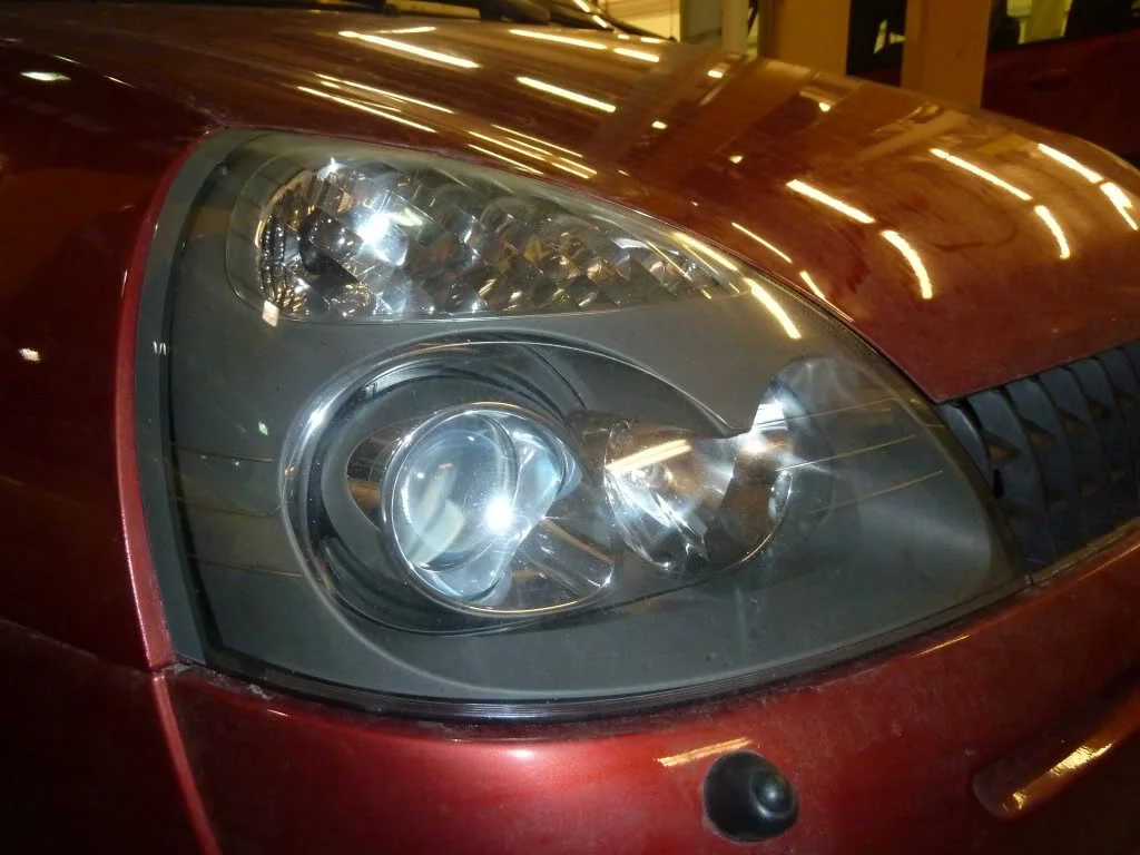

XENONS ON

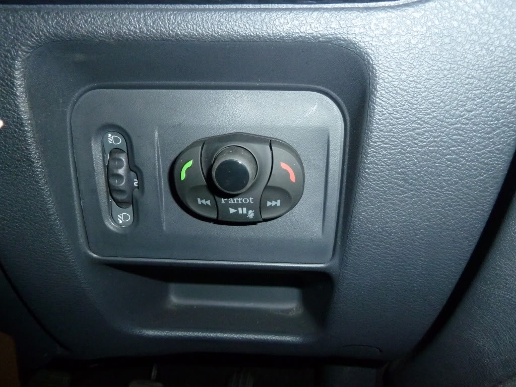

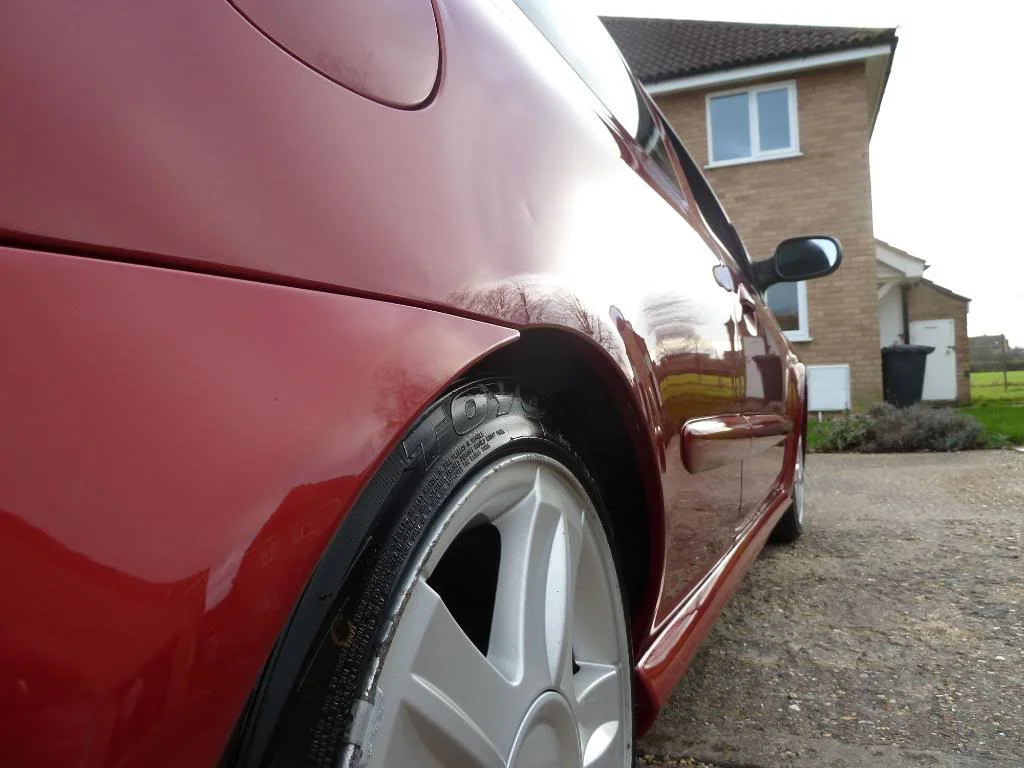

PARROTT KIT INSTALLED
