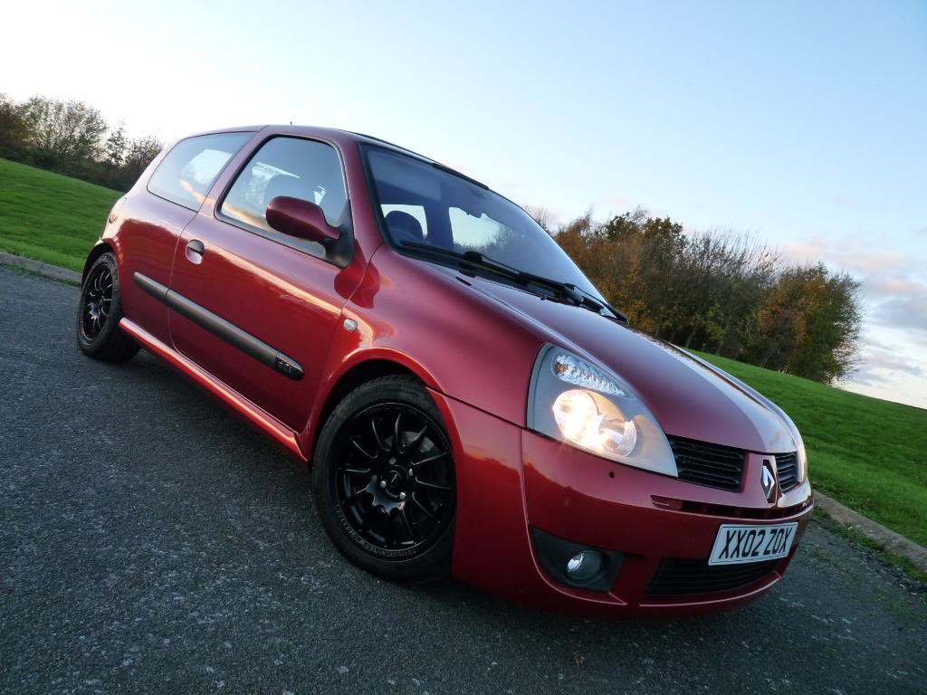

Wests Widetracked Flame Red DCI 80 Sport Rep
  Discounted 1*2 parts
Re: Flame Red DCI 80 Sport Rep
lookks good just needs a few things and it will be mint
is it just me or is the colour a miss match ?
getting there its going to look good when done anyways
The newly painted parts are slightly different shade but when i get the side strips and door handles sorted i'll get them to blend it all in
this car is simply amazing looks so good dude. hope your happy with it i would be any future plans on performance wise ??
nothing planned performance wise............its a diesel!!
The whole idea of this car is it returns 70-80mpg so doesnt cost us anything to run :)

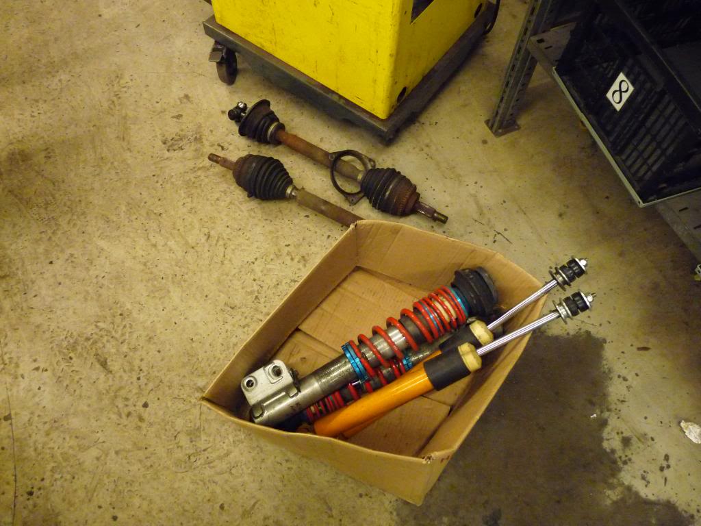

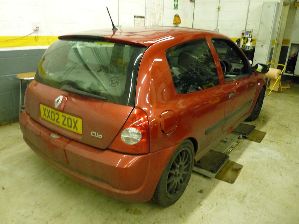

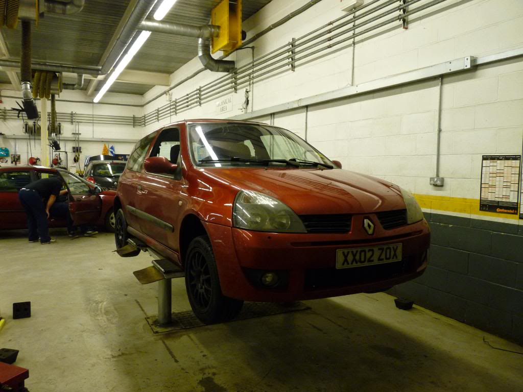

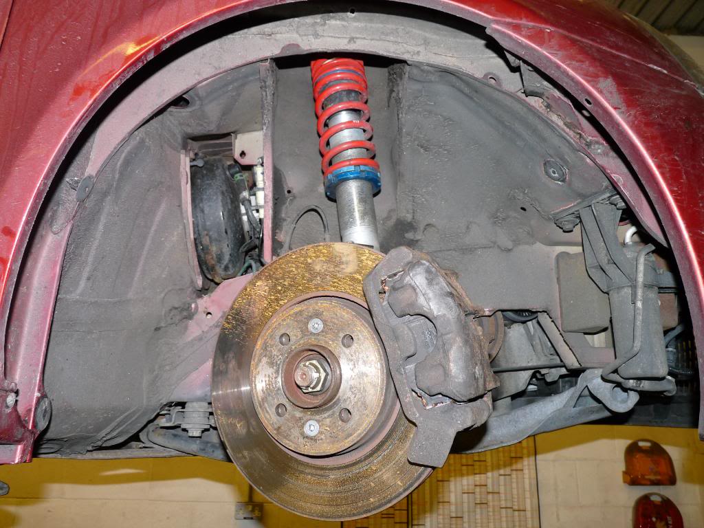

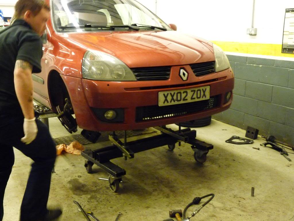

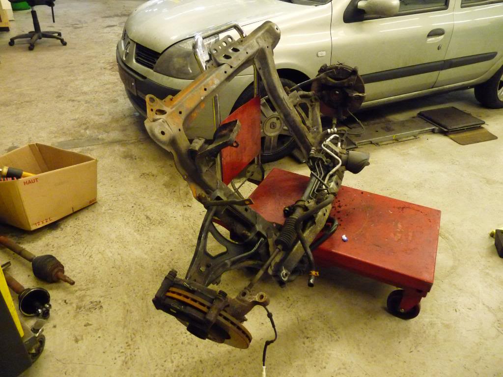

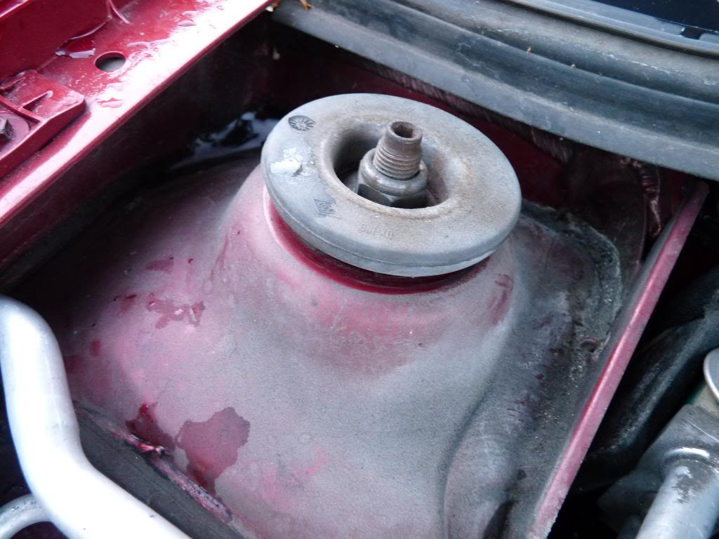

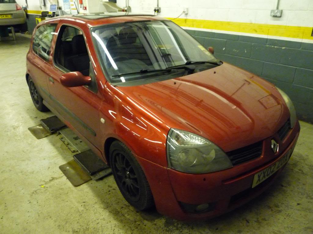

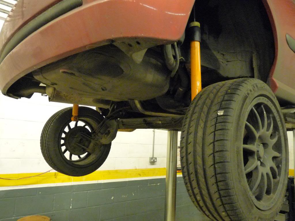

Carried out the widetrack conversion on my DCI today.
So here it is before
The subframe, wishbones, driveshafts coilovers and brakes from my 172
Swapped the electric PAS rack from the DCI subframe onto the 172 subframe
Putting the 172 subframe onto the DCI
Front coilovers and 172 brakes on
Rear coilovers being installed
After pictures
Now just got to get 4 wheel alignment done and give it a wash :D
