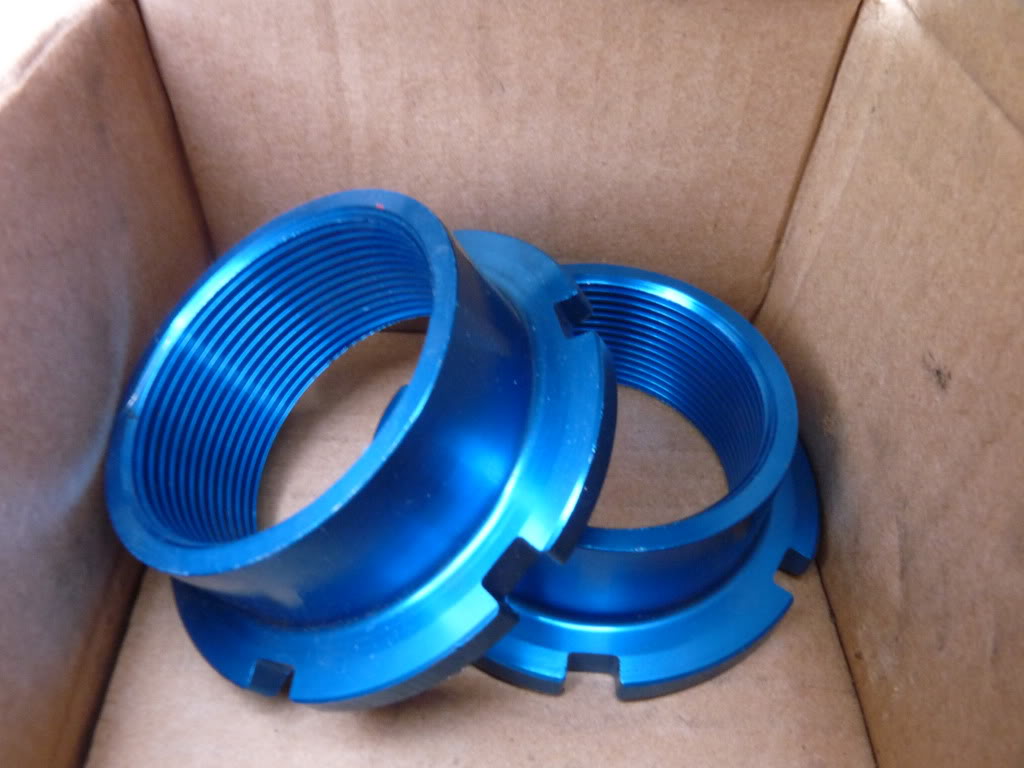

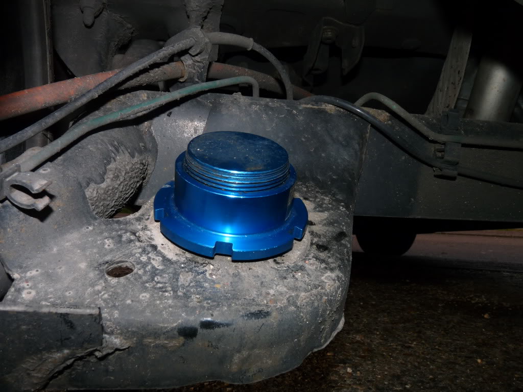

Fitted the spacers to the rear coilovers at the weekend
Prefered the look of it without the spacers but you couldn't take people in the back without the arches rubbing on the tyres!

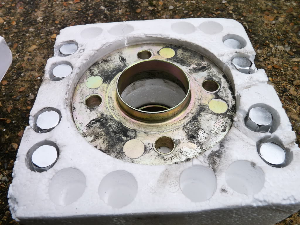

Got the spacers through this week.
Went to fit them today but they won't fit on rear hubs, only discs. So I'll be getting the rear disc conversion done asap :)

delta mics? if so I would advise you got some new bolts, and not to use the ones that come with them.
Why dont they fit the rear hubs. I ran 25mm with my rear drums for about 2days and fitted fine.

When you put the spacer on the rear hub it doesn't butt upto the hub face

Do they tighten at all, or is there a small gap about 2mm between the drum? Might be different on the dci I guess.

There is about 2/3mm gap between the back of the spacer and the hub face, whereas when i tried it on my mates 172 it fitted perfectly

Yeah I had that gap on mine. Not sure if its to do with the face of the hub, however I as long as the bolts are correctly torqued they should be fine. If your getting the disc conversion for the rear, you may as well just wait.

Yea just didn't look safe having the gap, so will wait a few more weeks until the rear discs go on :)
