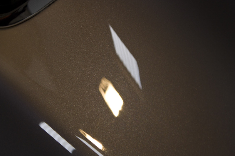

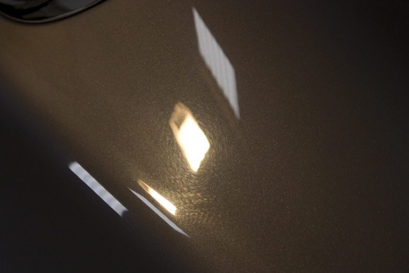

These are pig tails btw, incase anyone was wondering what they actually are. Frequently found on Aston's, like this DBS..
But they do come out, without any sanding (as that's what causes them, sanding by DA)

yup thats what i have. new paint - da'd the day after and compounded up. intentions was to make a mirror finish. the bonnet is the only panel i can still see them on. altho mine look more tightly packed then the ones in that photo above.
