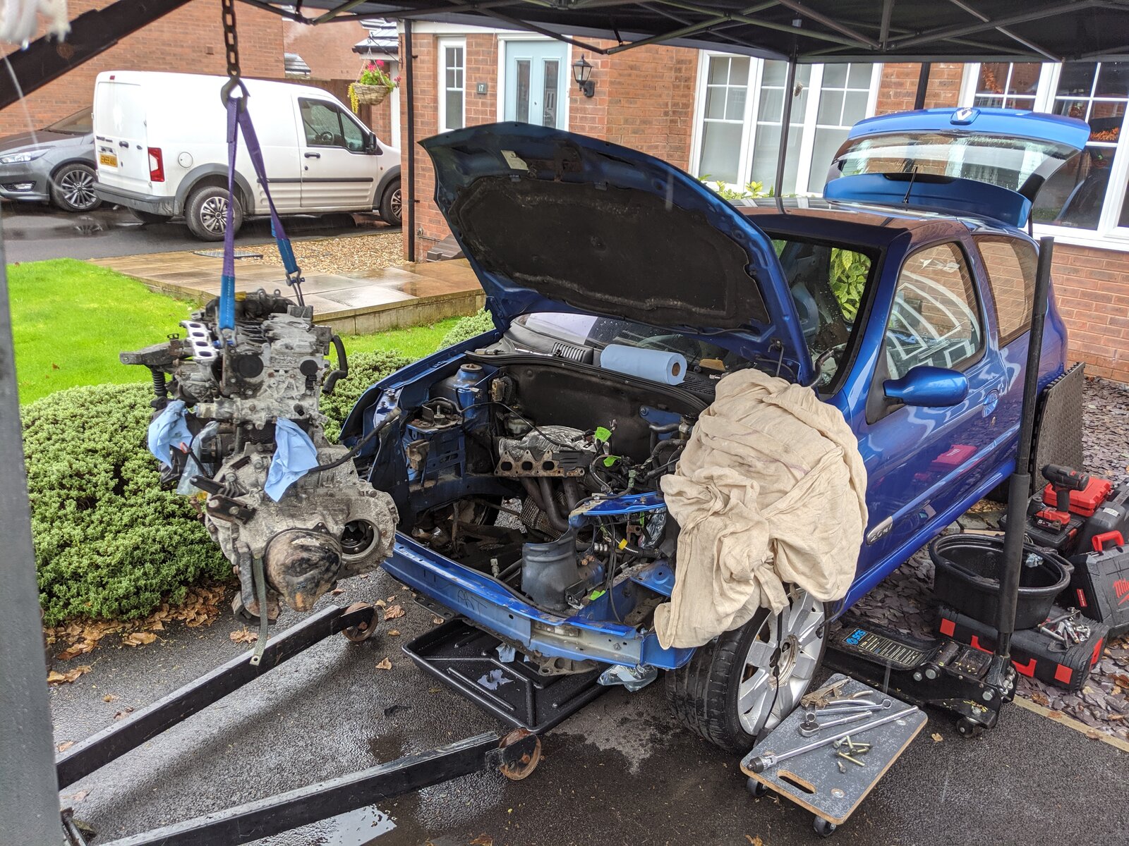

What’s the best way to remove the engine at home On driveway as done full top end rebuild With uprated springs and valves and new dephaser and all followers done too and found that my problem is the bottom end with rod knock from a failed injector causing detonation and gone dry.

Everything off and just lift it with a crane really. I used a lifting strap with 2 lifting hooks in the engine hook points.
