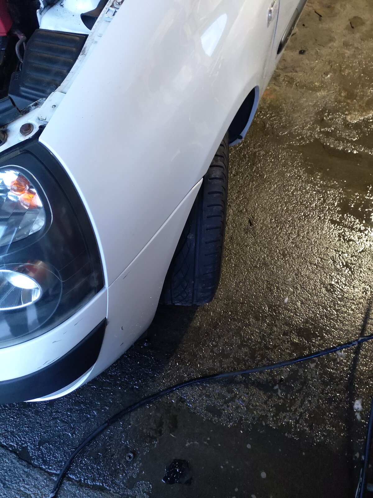

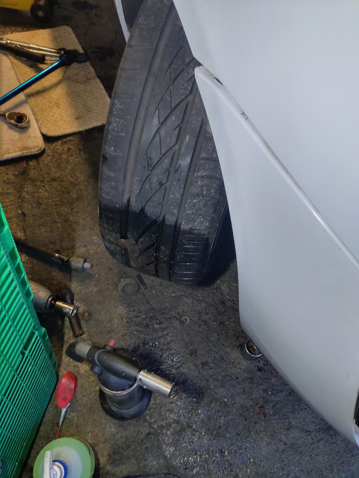

Get a pic of both the wheels when the steering wheel is at top dead centre
