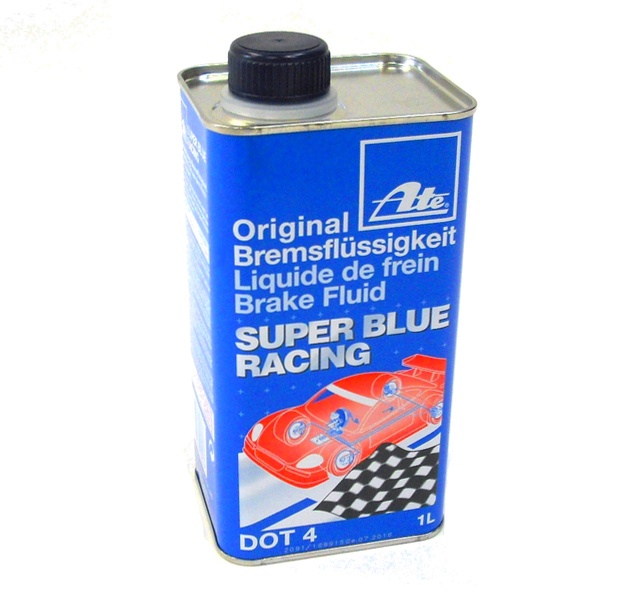

Will the super blue ate need to be changed more often or is it just replacement for the standard stuff they put in?
How many litres needed?
Austin-182
  182
Is the ate super blue dot4, would you recomend using that?
simply asking as the garage will bleed them for £20 so would rather provide my own fluid than the cheap bulk they probably use, or am i just being stupid thinking that way ? Lol

The ATE Superblue is decent stuff I use it and recommend it.
1 litre will do it mate
Often gets overlooked doing the brake fluid, supposed to be every 2 years by the service schedule iirc. Makes a difference and its pretty cheap to do

Amesome stuff, didn't have any brake fade with this stuff last time on track - Cheap compared to others as well

Cheers mate,
its never been changed since new, so the ate stuff is just normal dot4 and nothing track spexial that will need to be changed again soon?

No worries Austin , yep just a good quality dot4 that can be used on road/track .Won't have to change it any more often than any other dot4 .
